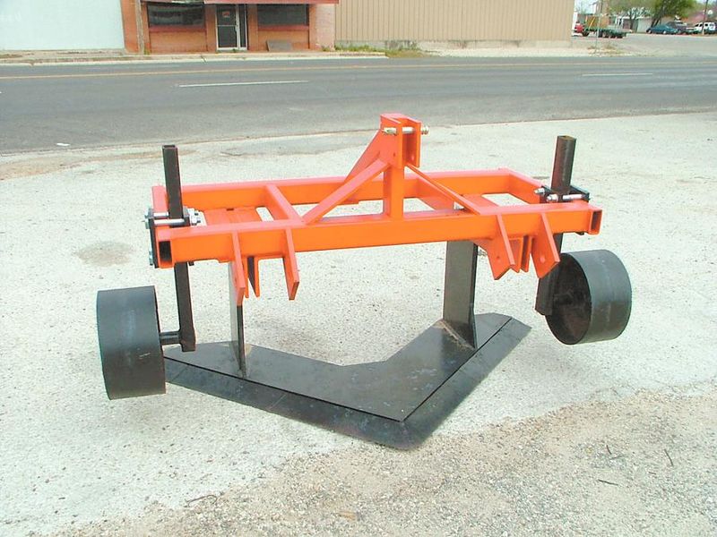

Growing up in S. Texas my grandfather had one solution..."cut them down and burn the stump". It worked pretty good. Once you get rid of them, Kotara Mfg in Stockdale Tx. sells a 3 pt root plow that will keep them gone.
