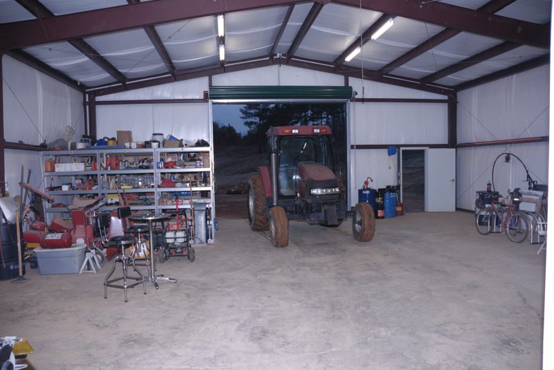

I have a 40x60x14 metal building too. I put 4 T-8 fixtures (8 bulbs total) in each 20 foot bay. The fixtures are attached to the second purlins on either side of the peak, running length wise. I calculated the total foot-candles prior to going this route and have been extremely happy with the amount of light. My building is insulated, with white plastic backing, so that also helps to illuminate the area.
The attached picture shows the lights in the first bay.
12 total fixtures? Is each bay switched separately? Thanks,
