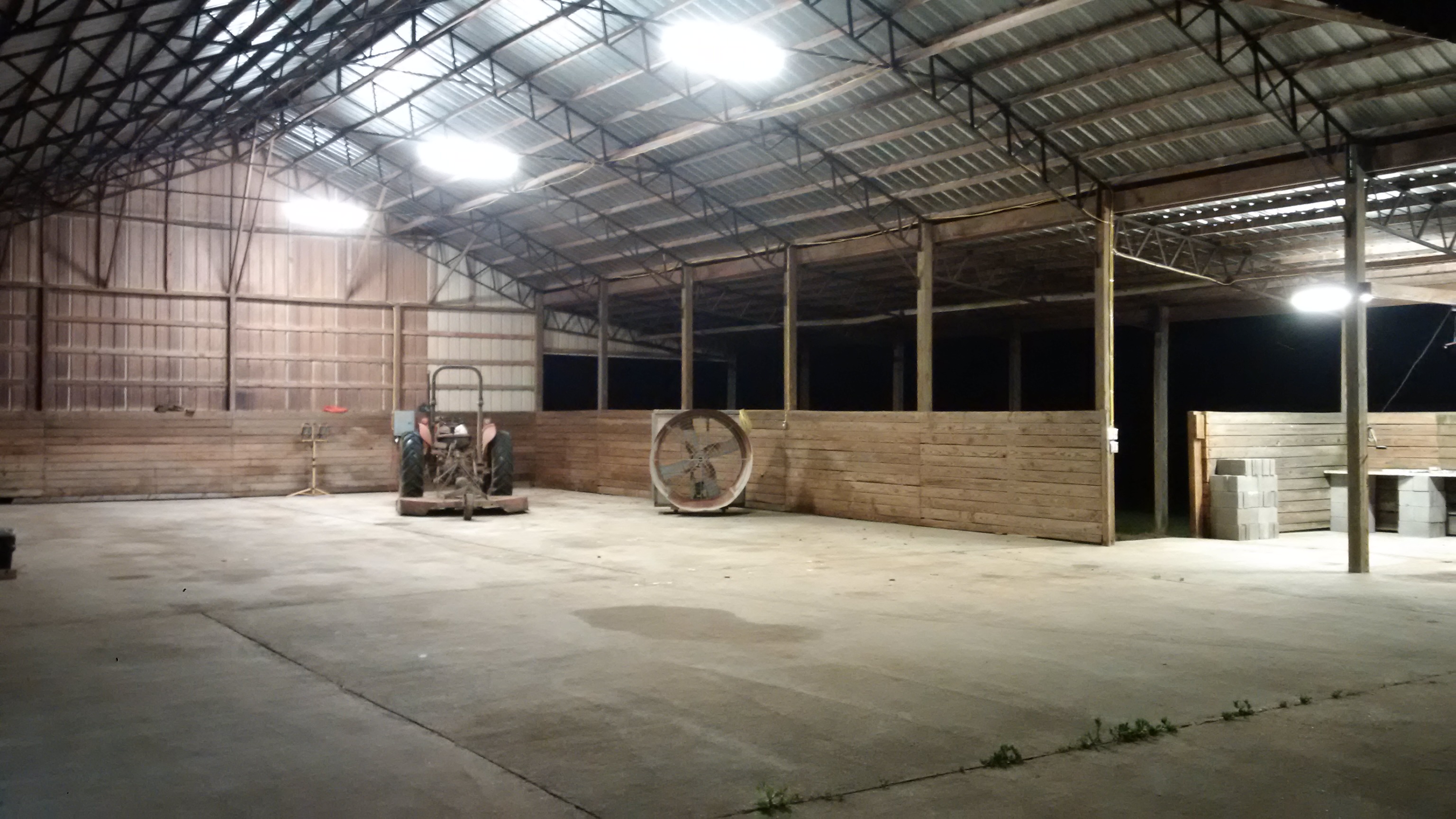

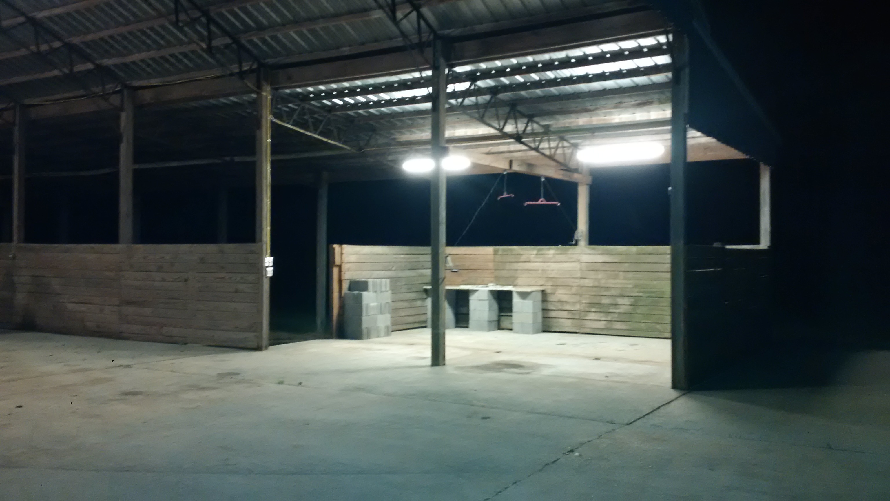

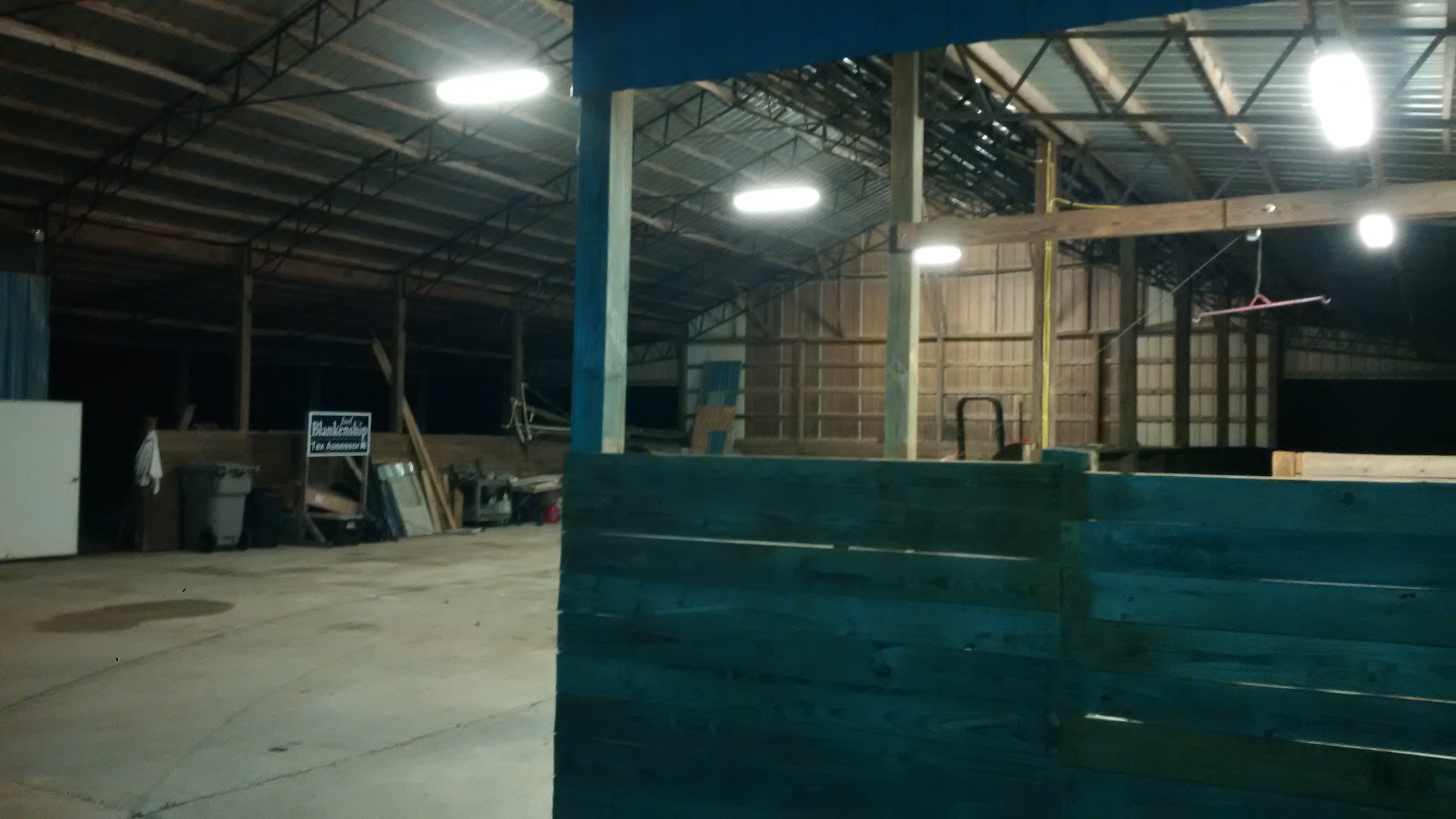

In the main barn, I installed three two bulb 8' florescent fixtures.
Two more on the side wing where will clean deer, and another in a walled locked up area.
So far this is enough light, but we can easily add two more fixtures in the main area when needed.

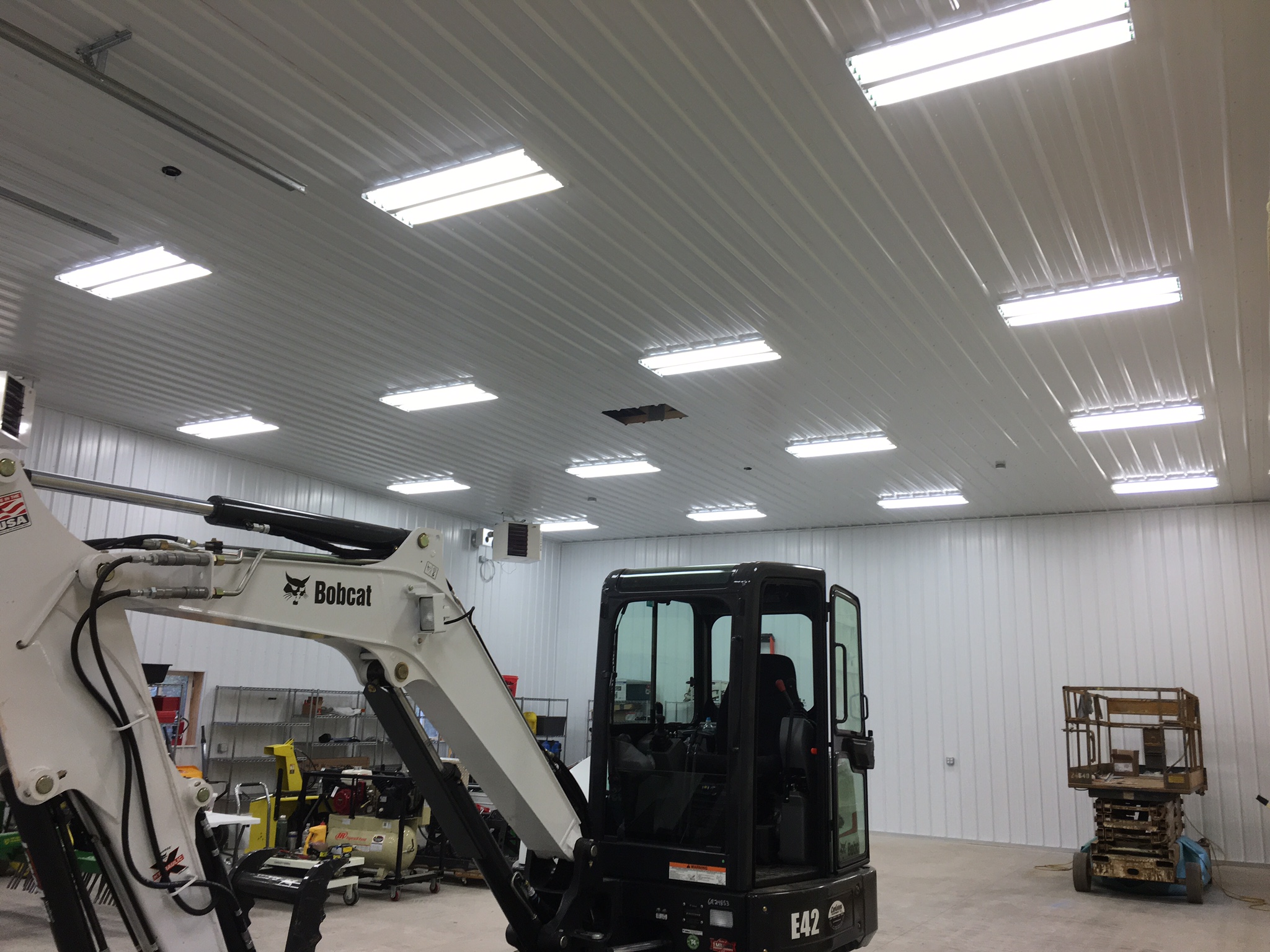

My shop is 40' by 60' with a 15' 4" ceiling....white ceiling and walls inside...and we installed 8 fixtures in two runs, each 4 feet long with 6 T-5 tubes per fixture. We used 8 switches total and every pair of fixtures can have 1/3, 2/3 or all tubes on at once. Two breakers power them and the total power draw with all on is 24 amps. It's very nicely lit and I wouldn't want to have any less light.
