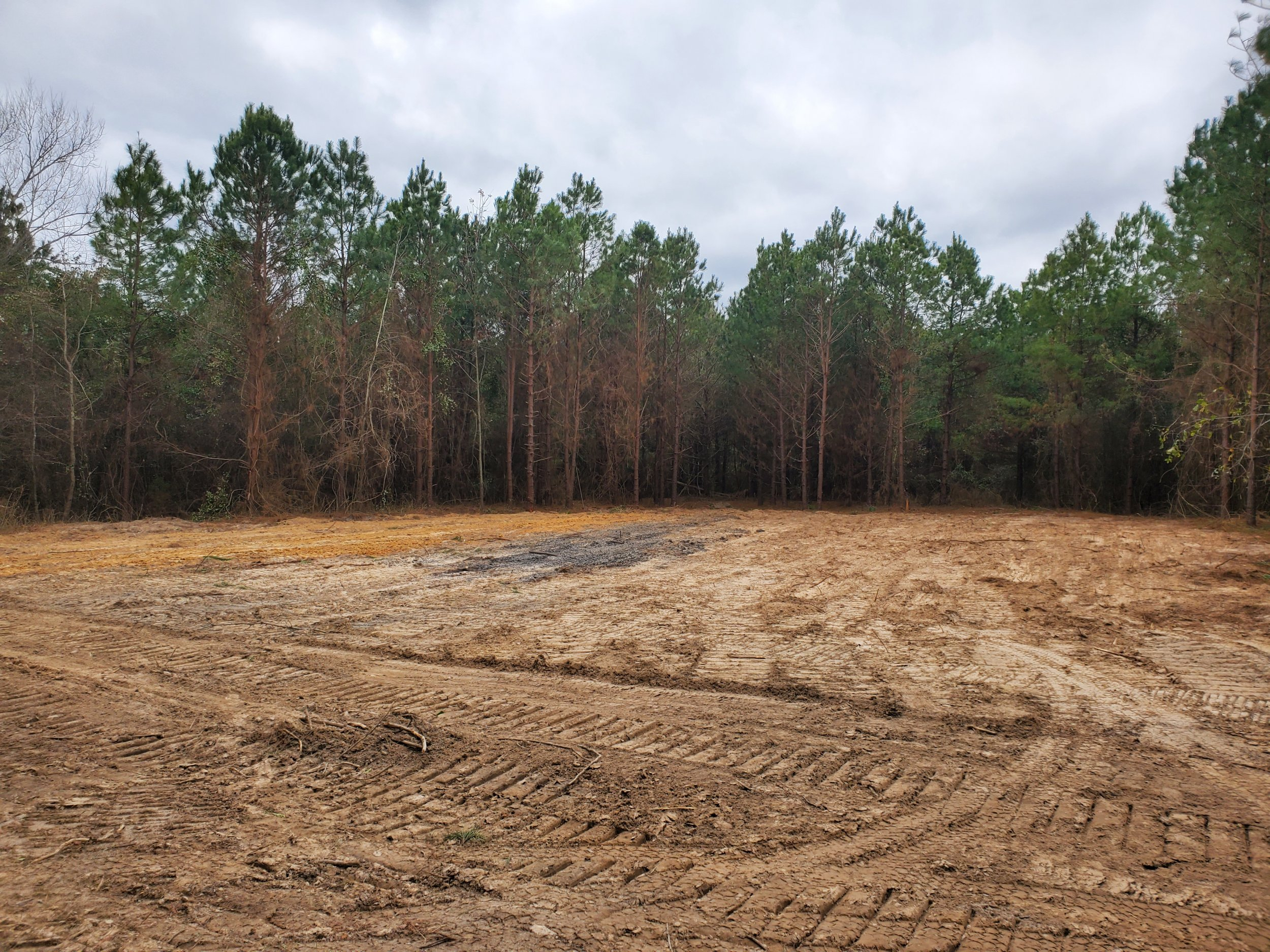

This is where it will be. Foreground is driveway. Garage will be straight ahead. 30' side across, 40' back. House will be in back left from here. Land slopes a bit from right to left, then drops a few feet just past the treeline on the left.
I am very familiar with PNW weather. Not quite so wet in East Texas, but average is 4-5 inches a month, drier in summer. No maples, but there are a few big oaks on the property.

I know that you wrote that the land drains right to left, but I wonder how it would be to put in swales heading straight back at least 6' either side of your garage, either to the trees, or a swale by the tree line going right to left. I would up cycle the removed soil to provide a raised base for the garage, plus 3' either side. One item on the swales is that wider is better, both for water handling, but also for ease of mowing.
Don't forget that what is good for the goose is good for the gander- I would raise the house as well... you could slope the land from the house and the garage to a swale in the middle, moving the spoils on to the building sites.
We lived in a house with drainage that was 90% right, and the last 10% was a constant headache. By the time we realized the issue, it would have required 75' of subsurface drain, under two trees and a sidewalk... so it never got fixed, and was always a headache in heavy rain.
As a result, I have a preference for drainage that just works.

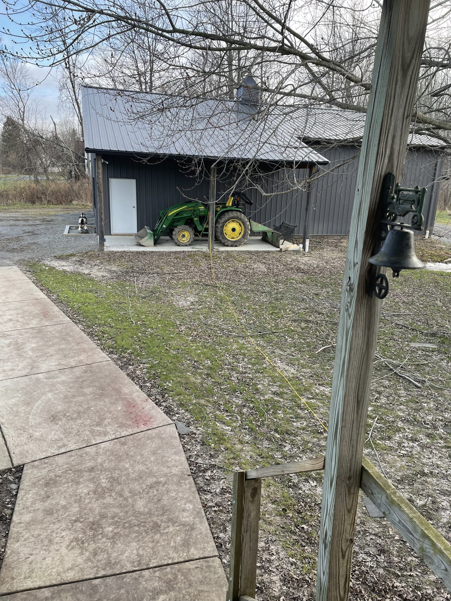

One option, is to put the doors on the ends of the main building, and porches off each side. That will bring your gutters down to a more reasonable height, to keep clean as you get older, plus give you a lot more handy storage space.

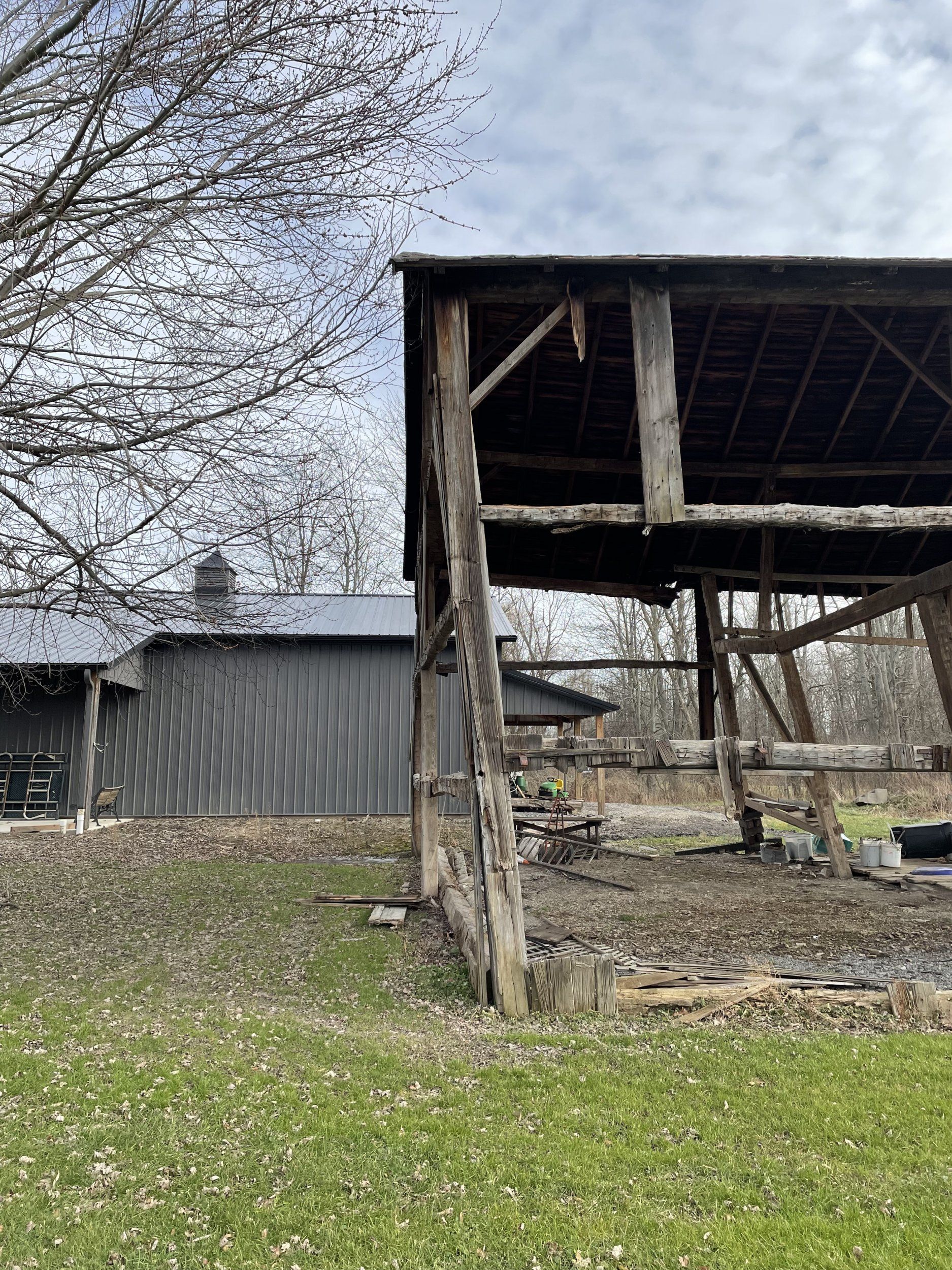

When I finish dismantling the last old timber frame barn that my great great grandfather built on our farm, I am going to extend the porch on the new pole barn. That will make the gutters safer to clean and give me more storage area.
I didn’t run the porch the whole length, when I built it, because I was afraid that last old 1883 barn would fall on it, and take it out. It sure feels safer cleaning the lower parts of the gutters.
I dismantled another twin to that other old timber frame barn first, because it was on the site of the new pole barn. I used many of the old , mostly American chestnut hand-hewn posts, beams, and the sawed roofing and granary wood from that, to make a loft and workshops inside the metal shell of the new pole barn.

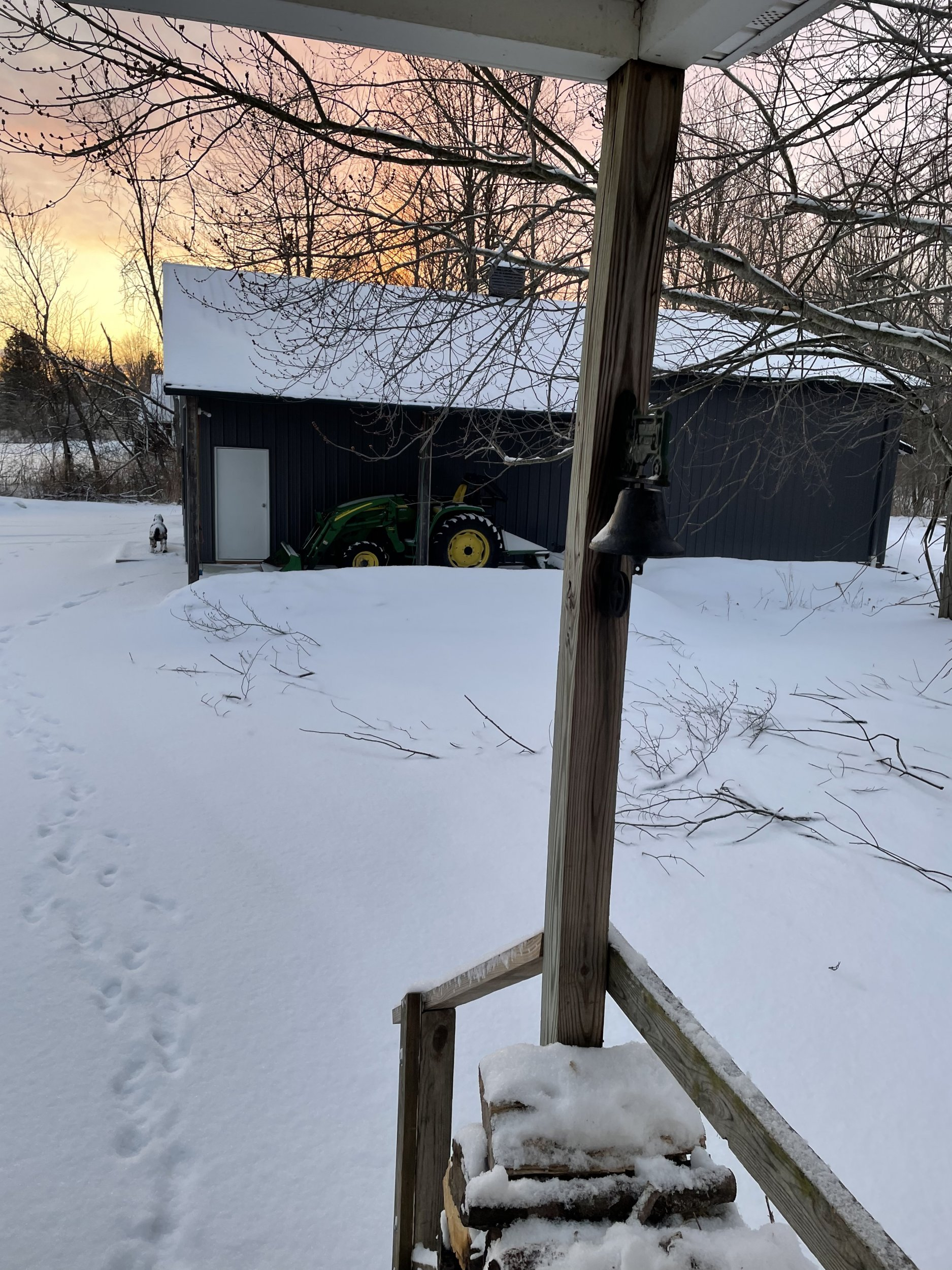

I like having the machinery doors on the ends of the building, because we get a lot of snow around here. Doors on the sides don’t work out so well with a metal roof.
   / Metal building with no gutters? #48
JI got to fire up the tractor (after a couple hours of running the block heater) and plow later this morning. See what I mean about doors on the sides and snow:
I feel your pain. Fortunately, snow is rare enough and temporary enough down here that I can mostly ignore it. I spent almost half of my life up north. I sometimes miss snow, but not enough to live in it full-time.
