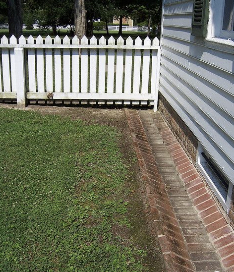

We are finalizing the details on our shop building. It will be 14' at the shoulder and cleaning gutters as we get older will be difficult to say the least.
I am considering extending the roof a foot or so beyond the walls and using a ground drain to channel the water away from the foundation.
Has anyone done anything like this? Any other recommendations for a decent alternative? Things to consider?
We get about 48 inches of rain a 2 inches of snow a year. Monthly rainfall goes from about 2.5 inches to about 6 inches.
Many colonial homes and buildings used “ground gutter”. As long as water can’t pool against the building you’re fine.
That also causes shrubs and flower beds to be put in their place rather than up against a structure where they shouldn't be . And if you did unsightly brick or concrete work as i might , the shrubs disguise that .
