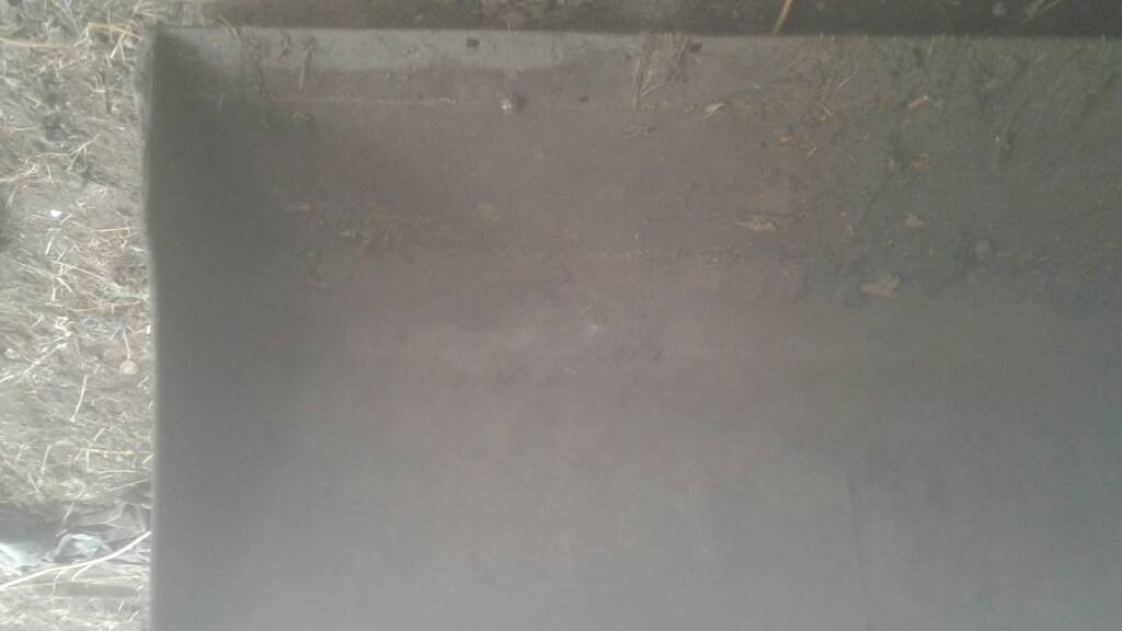

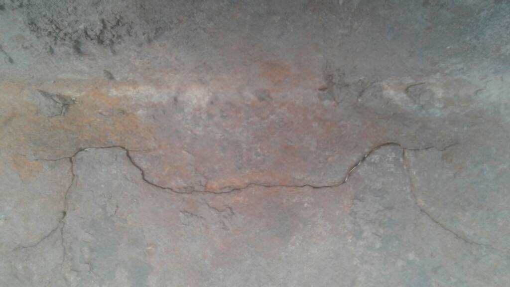

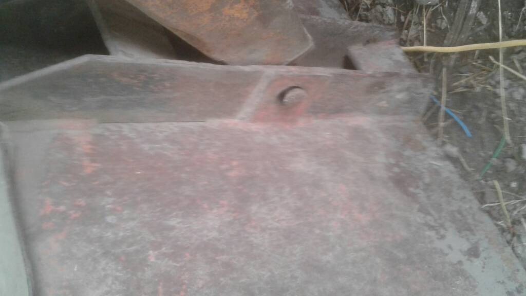

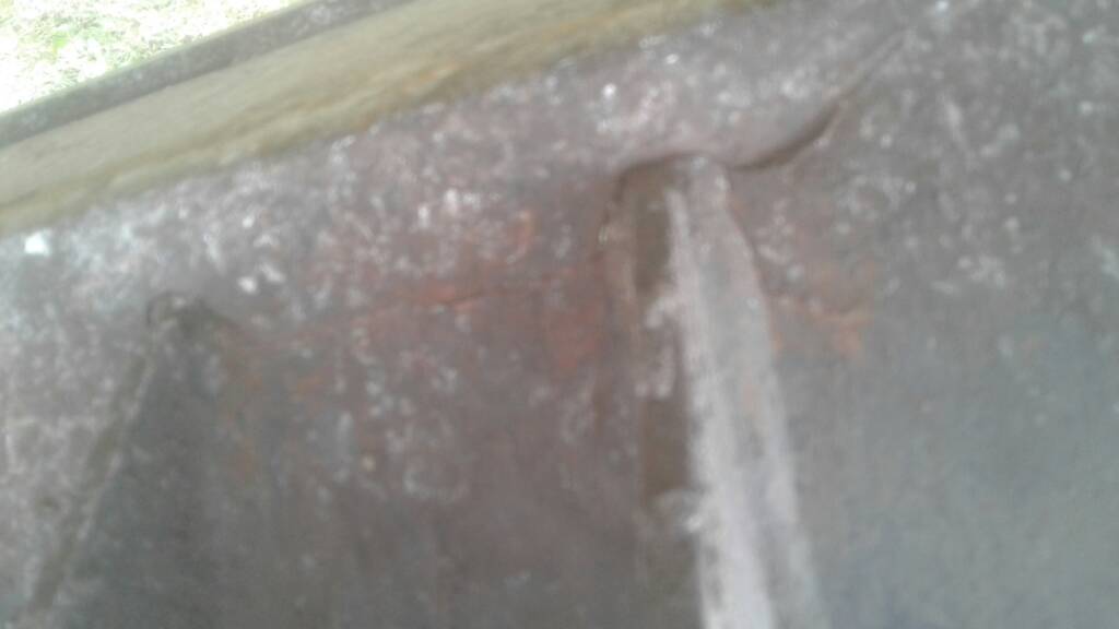

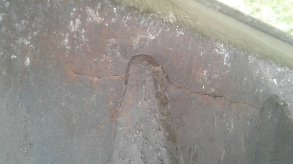

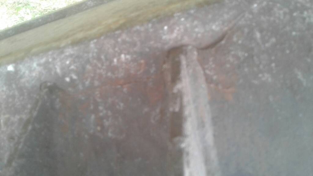

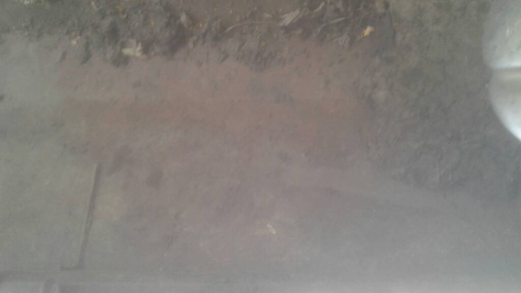

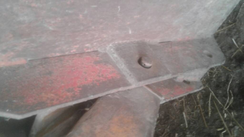

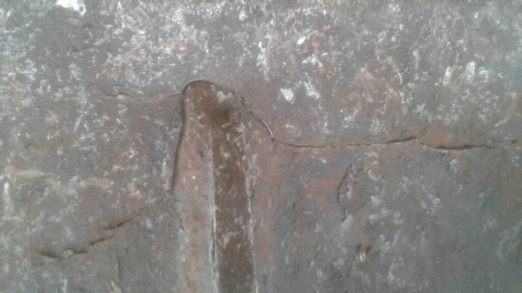

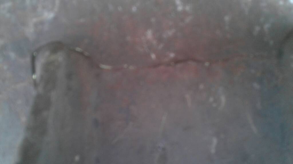

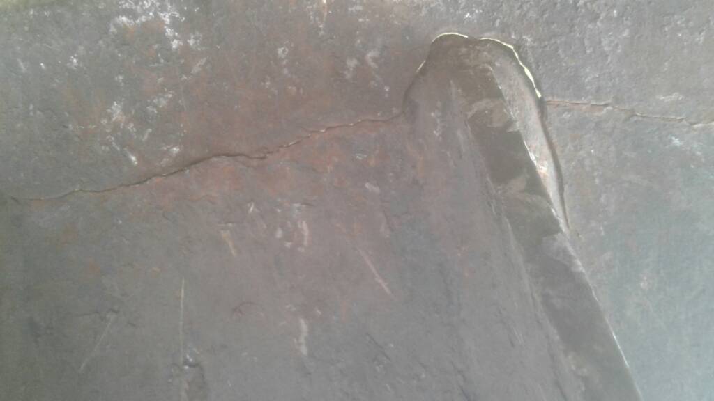

The bucket on my 1520 loader is litreally stressing and cracking near the welds. The welds are fine and holding up ok. However, the metal is stressing and falling about an inch from the welds. Is anyone else experiencing similar issues? I know I have used the devil out of the loader, but now this? Come on !!! The accuse me bashing agco, but the product speaks for it self. And yes, I do not care for agco. But I have been around this stuff all my life and seen some loaders put through the ringer, but I have never seen a bucket start cracking fRom metal fatigue.

Buckets wear out. That's an unfortunate fact of life. If it happened in the first 500 hours, I'd be concerned about it. But if you use the bucket heavily, you'll wear the metal thin.

I'm not very good at this picture thing but I will give it a valiant try. The tractor and loader are about 8 years old and just over 1500 hours. Sounds like a lot, but I also took pictures of my koker loader for comparison. God only knows how old and how many hours is on the koker loader. Dad has a John Deere 4100 with a loader
It is probably 15 years old or so, no problem. We had a loader on a old 930 case. We fed a lot of big round bales. Over about a span of 15 years we broke two spindles on the tractor, but no loader trouble. Truthfully, I don't know if agco builds a whole lot of anything. I think they contract a lot of stuff out. I.E. the tractor was built by iseki in Japan. I am not cutting agco much slack hear. The only excuse I might let fly is if the welder put quite a bit of heat to it when welding it and the metal crystallized. You still have an issue, but it is the individual welder that created the issue. 20170915_105633.jpg20170915_105645.jpg20170915_105716.jpg20170915_105718.jpg20170915_105726.jpg20170915_105751.jpg20170915_105754.jpg20170915_105805.jpg20170915_110028.jpg20170915_110008.jpg20170915_105645.jpg20170915_110113.jpg20170915_110054.jpg

I know you have a chip on your shoulder for AGCO.... And in contrast, my experience so far has been fantastic. So two different view points...
But I'm trying to be fair here. That just looks like worn out, thinned metal from use and time. You can always try to clean up and weld those cracks, or weld new skin over that area. I've seen lots of commercial grade SkidSteer buckets crack and completely wear out along the bottom after only a few years of use ... The Virnig branded bucket (very heavy duty) that came on my Terex track machine lasted 5 years, 1900 hrs, before the bottom was worn out. It's not from lack of quality, but instead from use. And I've seen plenty of older Farm tractor buckets, John Deere machines included, with rusted out, thin bottoms.
Most of the modern CUT buckets seem really thin in my opinion... I bent the bottom edge on my brand new LS branded (made by Amerequip) within 100 hours.
I'm just saying... I don't think you have a quality issue there. I think you have a worn out bucket from 1500 hrs of use and 8 years of exposure to the elements, on a compact tractor.

What is the thickness of metal at the cracks? How much wear? Any pictures from the other side?
I think I can see lots of cracks or the start of them. It also looks like quite a bit of rust.
I'm thinking it may be some pretty poor metal that was used?? Slag inclusions?
