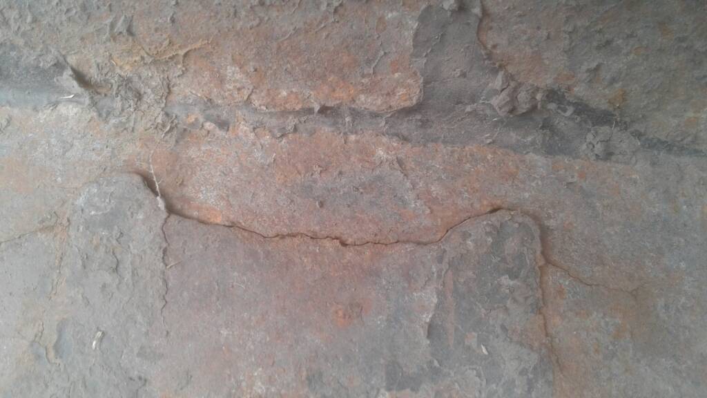

Yup; and where was that shiny metal from use located on the bucket pictures we saw.
What didn't I read??
   / Metal fatigue/ stress crack in a 1520 loader #42
Yup; and where was that shiny metal from use on the bucket?
I'm sorry, it's not worth discussing with you any further... You're not grasping the very simple concept behind it, and i don't have time to hold your hand while i repeat it a dozen more times.
   / Metal fatigue/ stress crack in a 1520 loader #44
Grasping the simple concept?? Means I don't agree with your concept doesn't it.
Here is a simple concept - grasp it!
Corrosion fatigue - Wikipedia
Thank you for posting that link, and validating EXACTLY WHAT I HAVE BEEN DESCRIBING.
I use multiple pieces of machinery daily with another multitude of front end attachments. They get scraped shiny-clean each time i work them, and within a couple days off-use, they have surface rust again. Multiply this by 1500 hrs over 8 years, and that link you posted describes exactly what i have discussed, and what the OP has experienced.
Thanks again for helping out!
   / Metal fatigue/ stress crack in a 1520 loader #45

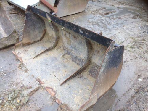

Just showing what happens. A couple of pictures. The first is the OP's bucket. The next is just an ordinary bucket. Completely different process at work. That first bucket was made from inferior/improper steel that corroded around grain boundaries, inclusion packets and layering when rolled.
Here are a couple of run of the mill buckets. Aside from surface rust there is no deep seated corrosion.
Your use of equipment is commendable. But note that there are many people that make buckets shinny on a daily basis. There are also many people that design and build buckets that have never seen an hour of seat time. Them's the fellars that know about corrosion.
When I get time I'll show a picture of my nineteen year old bucket on a tractor with 1400 hours. Lots of surface rust but no visible loss of material. Nothing like the original pictures posted.
View attachment 521952View attachment 521953
I'm not getting into this hair splitting contest. My opinion is pretty much formed. However one has to take a hard look at that bucket. I like it. Look at those ribs used to beef up that bucket. Looks like an inexpensive way to beef up a light bucket. My thoughts from what I've seen, unless it is real recently, kubota, John Deere and massey ferguson are all behind the curve.
