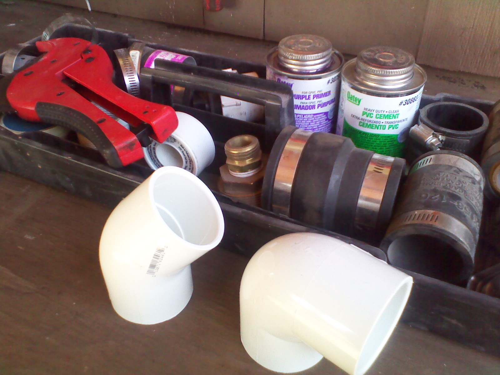

I use the purple primer and HD clear cement on my sump pump discharge piping. I also use SCH 40 fittings, mostly 1.5 inch but some 2 inch.
A little overkill from what I see other installers doing but I charge enough to justify it.
The purple primer is a primer, no doubt, it preps the surface for the cement.
The stuff is a cocktail of very potent VOC's, don't get it in a cut on your hands or you will be yelping :laughing:
