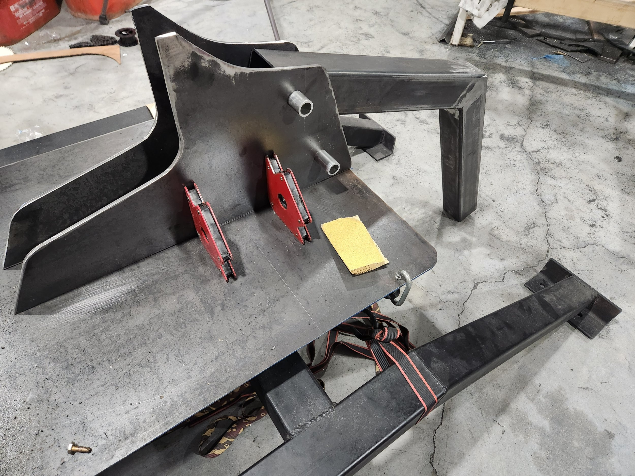

Making progress on the boom

   / Metal Thickness? #104

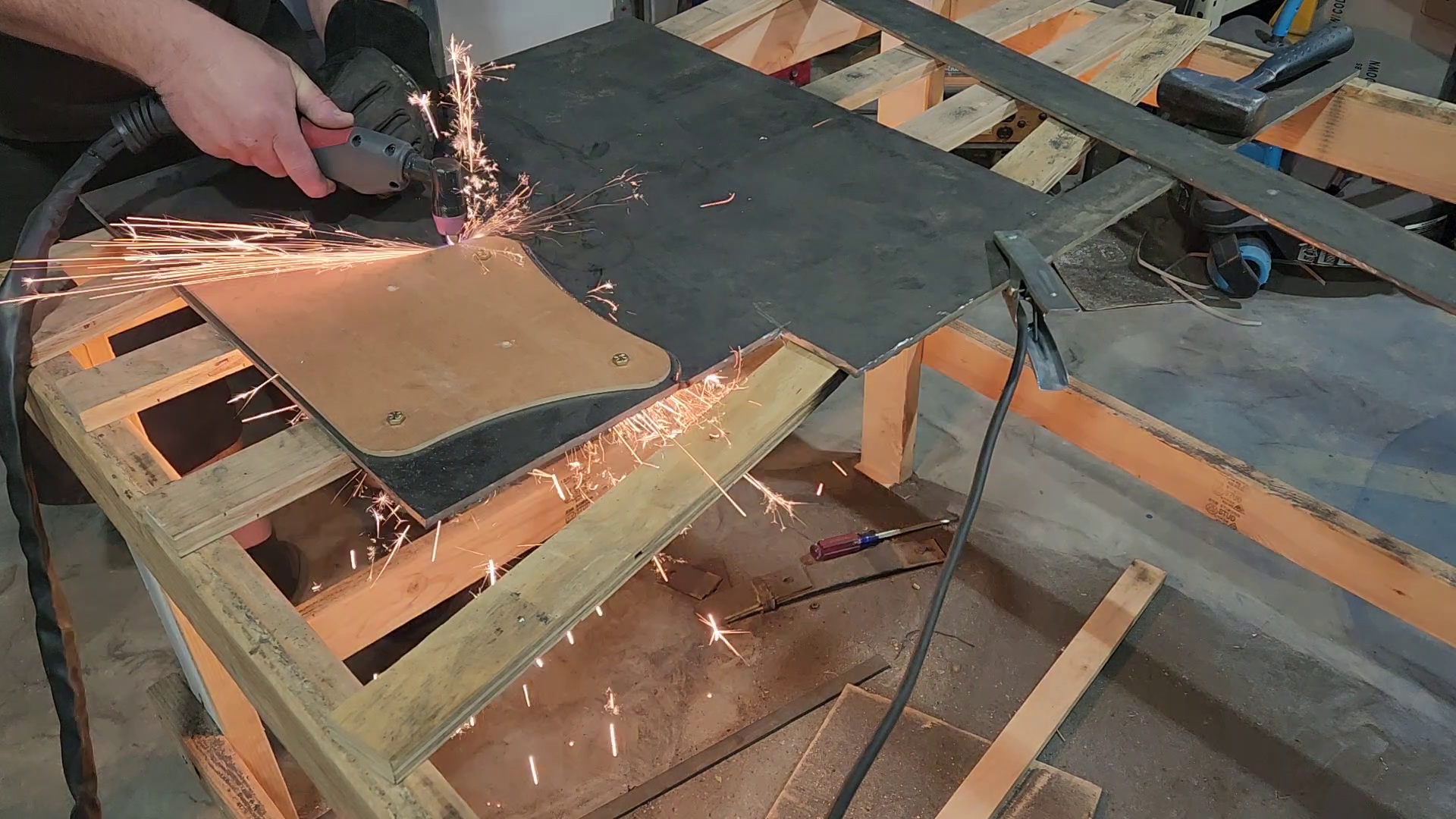

Those are some nice looking cuts on all those plates.. how are you cutting?
   / Metal Thickness?
#105
Most straight cuts were done with a grinder (can get straighter, and a cleaner cut)
The curves, mostly inside corners, were first cut on my CNC router into some 1/4" material, then the hand-held plasma cutter follows it as a jig or stencil.
Works...decently. I have to come back and clean off up the cuts with the grinder and a sanding disc, but it works.
This also worked as a manual 'nesting' method, to make sure I could get everything I needed out of one metal sheet.

I didnt want it to look home-made, as much as possible. Because of this I went with many rounds and special cuts - which granted took much longer, but hopefully gives me a nicer end result.
You can do it with a grinder, its just not fun a will probably take a cutting disk for every cut - but they arent $0.99 anymore.
I rounded the ends of the tubing with the grinder and a template.
I cut one side of seat base out with the grinder before saying F this and fired up the plasma.
You probably could use a bearing - but if you go slightly too fast once, it throws slag out the top instead of the bottom, buggering up the tip and surface. This would be a problem with a guide, where freeish hand, you just plow through it. (photo example attached)
