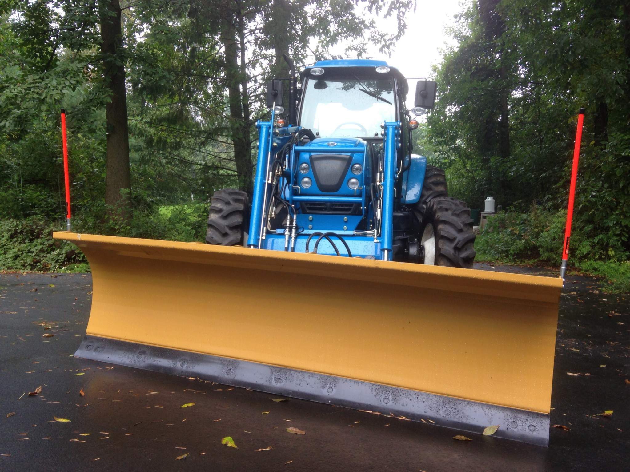

I need lateral float to plow a wide paved area on a pretty steep grade and preserve the crown in my road. Here's a picture that shows how lateral float works. I have to push the snow off the sides and without the lateral float one edge of the blade would be hitting and the other side would be 6-8" in the air:
I also have 2250' to the main road so changing out the plow and putting on a bucket to move back the snow piles would be a huge waste of time and fuel.

That is a really sexy looking blade Dave. I think that's going to work out very well for you.
