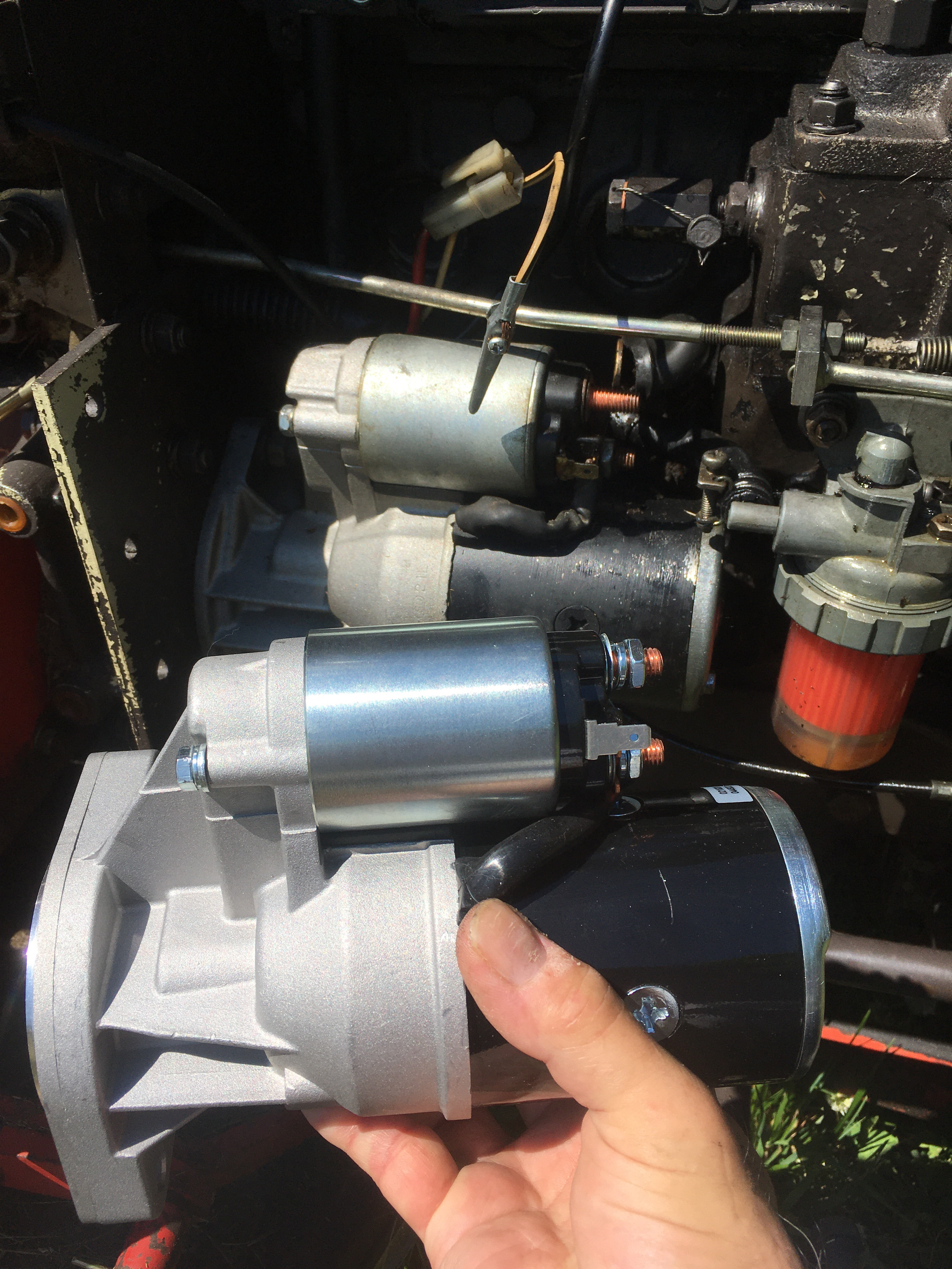

What do the bolts look like? With the starter wiggling do I already have the threads backed out enough to tap the starter away or do I have to keep turning?
I'm working blind here so your help is appreciated
   / MF 1010 electrical help? No Start mystery #22
thanks.
There are just two long bolts. (Didn’t measure but maybe 5 inches long?)
In the photo you can see how the grime outlines the flange of the starter. I have removed the lower bolt in this picture and you can see the threads of the upper bolt.
These bolts extend all the way through to where the brake pedal is. So you will need to hold the head of the bolt while you unscrew the nut. Tap the lower bolt out after you have removed the nut. Use a hammer and a piece of wood to protect the bolt. Once that bolt is free, the starter will come out easily.

Here’s a pic of the new starter.

turns out hot/lead positive terminal was bad, starter wiring also stuck on draining battery further.
Started up and runs fine.

Went to start it today, slow whirring noises and smoke/heat from the starter.
Fan turning slowly.
Did my new starter go bad already?
#30
checked all connections, charging the battery.
Turning over no start
Starter getting hot
