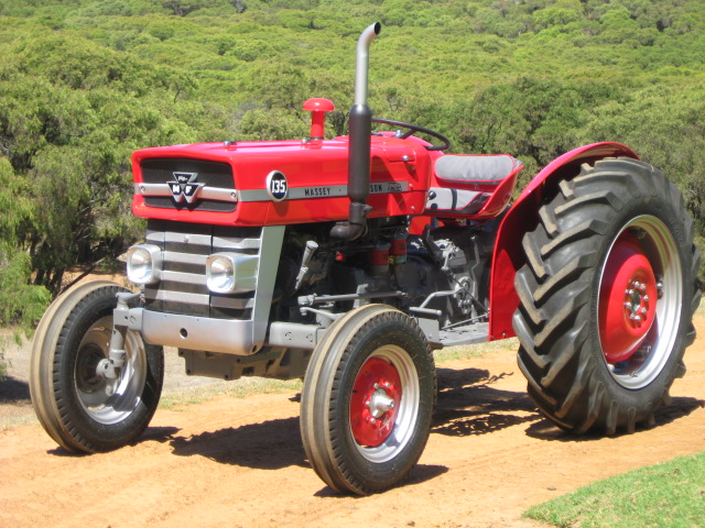

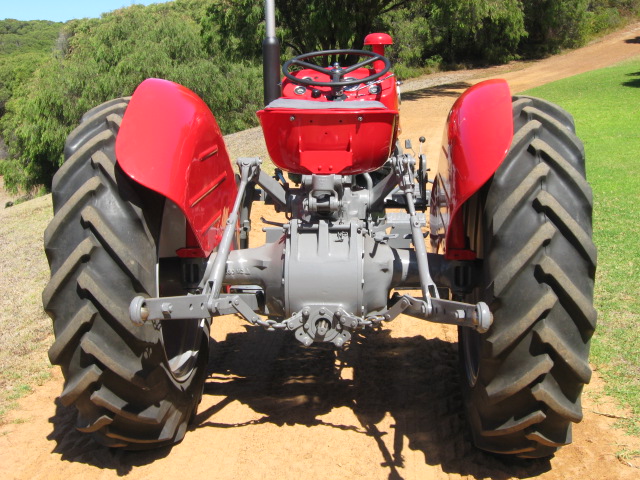

Restoration complete. Here are a couple of pics http://www.tractorbynet.com/forums/...tractorbynet.com/forums/images/attach/jpg.gif

Very nice. Those are some of the best looking tractors ever IMHO.
Thanks Tom. I am probably a bit biased but I agree. They are so simple and functional and one can do a complete tear down with a !/2" socket set and related spanners. I have started a new thread MF 135 RESTORATION which have some more pics.

Nicely done. i've always favored the european models or the US built ones. :thumbsup:
Thank you The kid. I had a look at your pics and mine was in similar shape before I commenced the restoration. I have started a new thread MF 135 RESTORATION which has some more pics if you are interested. I have to smile at your description " bush hog ". We call them " slashers " in Australia.

Nice restoration job.
What gearbox, ie 8sp?

Thanks. It has a 6 speed gearbox, no multipower. I would have preferred an 8 speed box ( without multipower ) but I was happy to get what I got.
