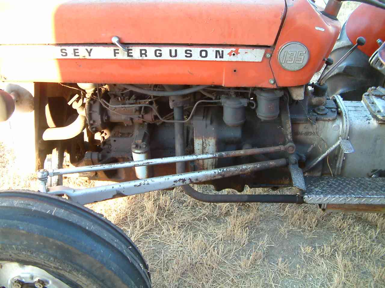

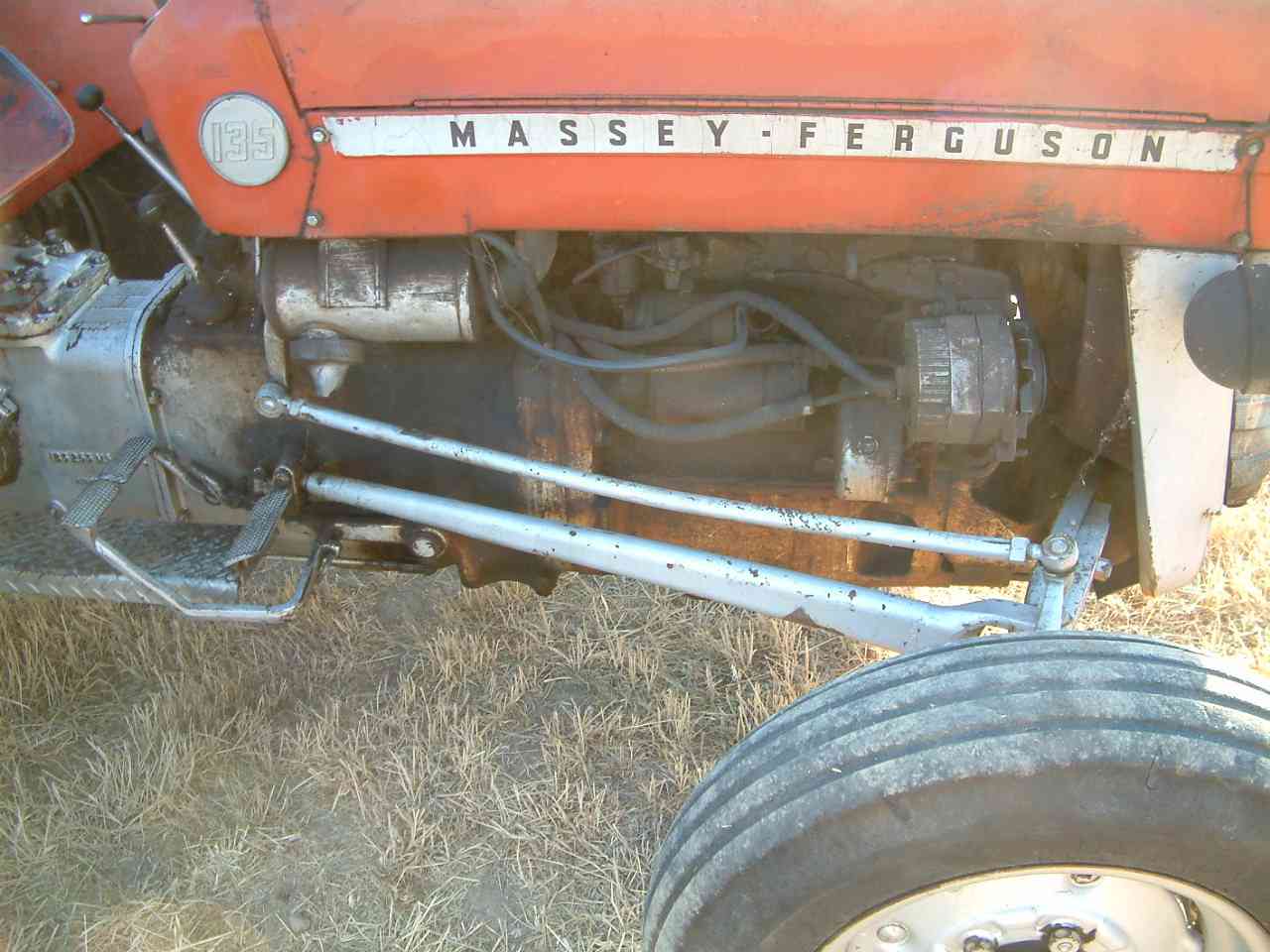

Where would the 2nd oil filter be? Maybe it's covered in gunk, too, ha! Here is a picture of the other side, in case it helps, along with the entire tractor. I think that's all the "inspecting" I'll let you boys do, sneaky ones!
If in the same condition and priced close, is the MF a better buy than the IH?

IH 384 is more recent, built in the late "70s and early '80s, just about the same HP but with POWER-STEERING !!! So yeah if in the same condition with good rubbers I'd go for the IH for $2000.

There's one cartridge oil filter on the engine and two cartridge fuel filters. Here's what it looks like on my 135.
The white filter on the left that's hanging on the block is the oil filter. The two greasy filters aft of the engine are the fuel filters.
My 135 has "power-assisted" steering (you can see the PS pump and the two hoses under the alternator in this photo).
It's a pretty rudimentary PS, not true power steering. Even with it, I wouldn't want to muscle my 135 around my hayfield all day.
To answer your last question: unless you really want to own a 135, I'd go with the IH 384.

That 135 is clean compared to what my 67 135 looks like and i paid about $3400 about 6-8 years ago. I snag it for $2k. It does look like there may be some fluid streak on the rear left wheel which may be indicative of a wheel seal leak. could be something else as the inside of that same wheel looked fairly clean.
