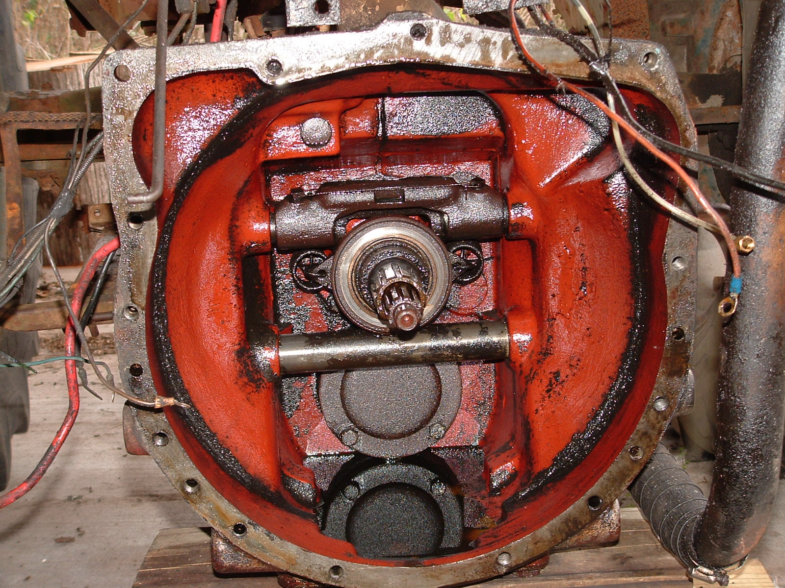

dob, can you post a few pictures of the leaking fuel area? Someone would have a better idea or suggestion if they could see it. On the oil leak, there are two weep holes on my 135. One is in the clutch housing, near the bolted square plate is (on the bottom of course). The other is in the adaptor plate in between the motor and transmission housing. If oil is dripping from the front hole, in the adaptor plate, then its probably the rear seal or the oil pan gasket. If its dripping from the rear hole it could be hydro oil or motor oil. Where does the oil appear to be leaking from? Here is a picture of how much oil was in by bell housing when I took it apart. Someone in the past had wedged a wooden plug in the rear hole, I guess cause it was dripping somewhere they didnt want it to. Good Luck TB

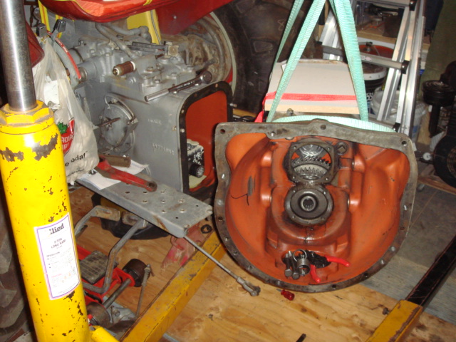

Attached is a picture of my 135, currently being overhauled for backhoe duty.
