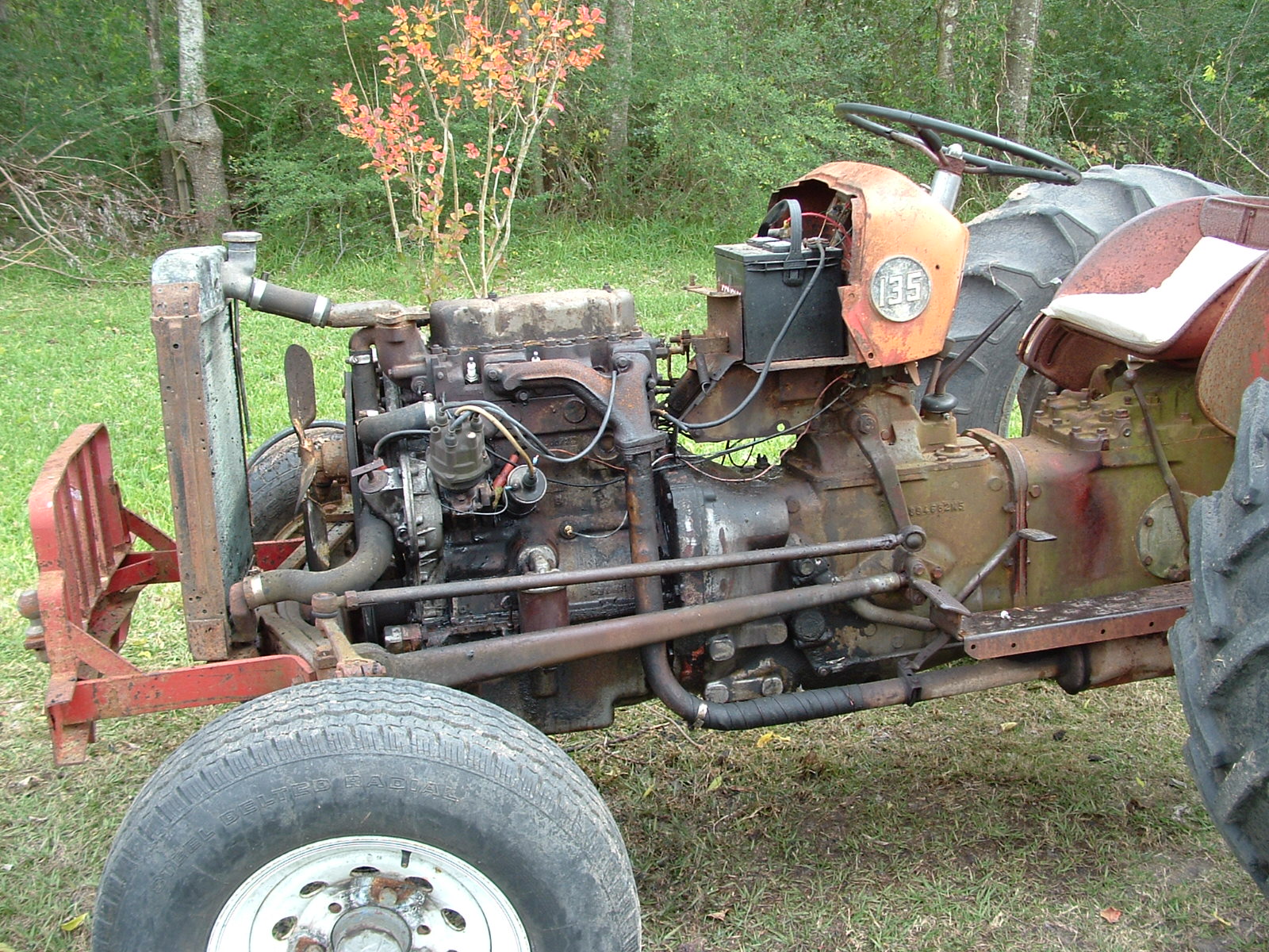

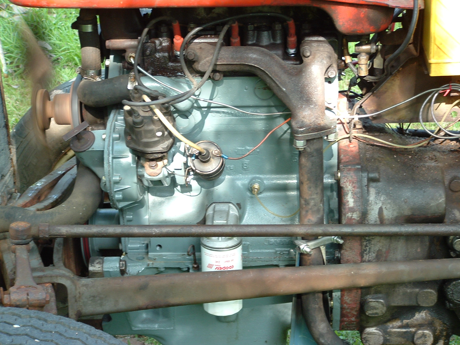

Sorry to hear that dob. I live in Manvel, near 288 and hwy 6, not very far from Pearland. It blew pretty good here, we lost alot of trees and quite a few shingles. Some of the roof decking came up, but didnt let go (thank god) but water still got in the attic. Good luck on scoring the tractor, it really is a good price. Heres a picture of how gunky mine was when I bought it (this was after I power washed alot of the gunk off, but there was still plenty there afterwards. Have since rebuilt the motor, so at least the motor is clean looking now. Its the gas perkins, but the same blockm as the perkins diesel. Anyhow, it ran good and held good oil pressure despite the years of oil leaks. Thanks, TB
