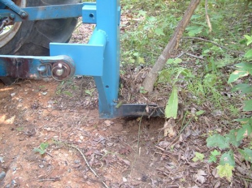

Since it is obvious you can weld and since we know you are clearing land using a tractor here is something you may need. I built the first 1 20/25 years ago to clear a bunch of plum trees. I couldn't afford to hire a dozer so since I had an old WD Allis with a 3PH that I also built I made a tree grubber. In my native NC red clay, which is tougher than whang leather anyway, I could still grub 3-4inch pines. Maybe this will help. Later, Nat

On this grubber, I used a piece of an old school bus frame for the upright and the gripper edge. I just cut a notch with the torch that is about 4 " on the open end and extends back around 6". Just lower it to the ground and back the tractor up till the gripper edge starts to bite into the tree and then raise the lift while still going backwards. It will pop the tree right out and will stay stuck in the grubber so you can carry it to the burn pile.

When you get it to the pile, just lower the lift and pull forward and it will come out so you can go get the next one.
Thw tree in the gripper on the pic id a 2" pole gum, and that is tough stuff. A 3" pine 30 foot higgh will come out much easier than a gum. I cleared around 4-5 acres of plum and pime thickets with mine. I made this one do triple duty with the addition of a reciever hitch for moveng trailers, and the pipe and plate on top are for moving my 5th wheel camper. The tounge weight of my camper is a little over 2000 lbs and that make my tractor squat. I have a 3000 Ford, about the same as your 135. HTGH, latter, Nat
