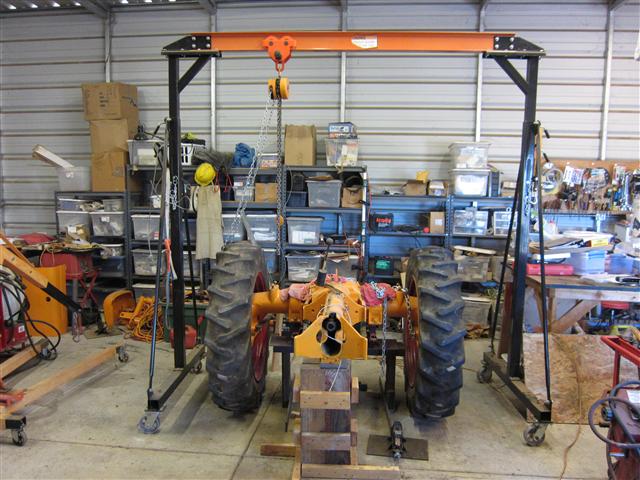

Splitting a tractor will require several hydraulic jacks to keep it stable. One jack on wheels paralell with the rear wheels which will support the tranny and rearend. This end will be easier to roll away (two man job) . The front half is a bit tricky. Since the engine sits on a moving axle, you'll need two to three jacks to keep it vertical. I would place all load bearing on stationary jacks while working on it for safety. I don't subscribe to working under a car/tractor or what ever unless it's sitting on something solid. There is a systematic order to seperate that should be followed (shop manual). Just remember one end of the tractor is going to have to move away from the other. Roller jacks are a must. Stationary jacks to place after seperation for safety.

I've disassembled a few tractors. In addition to the usual roll around jacks, jack stands, cribbing, engine hoists, engine stands, etc, I use my 1-ton gantry crane a lot for this type of work. Harbor Freight--about $600 for the crane and the chain hoist.
Good luck.
