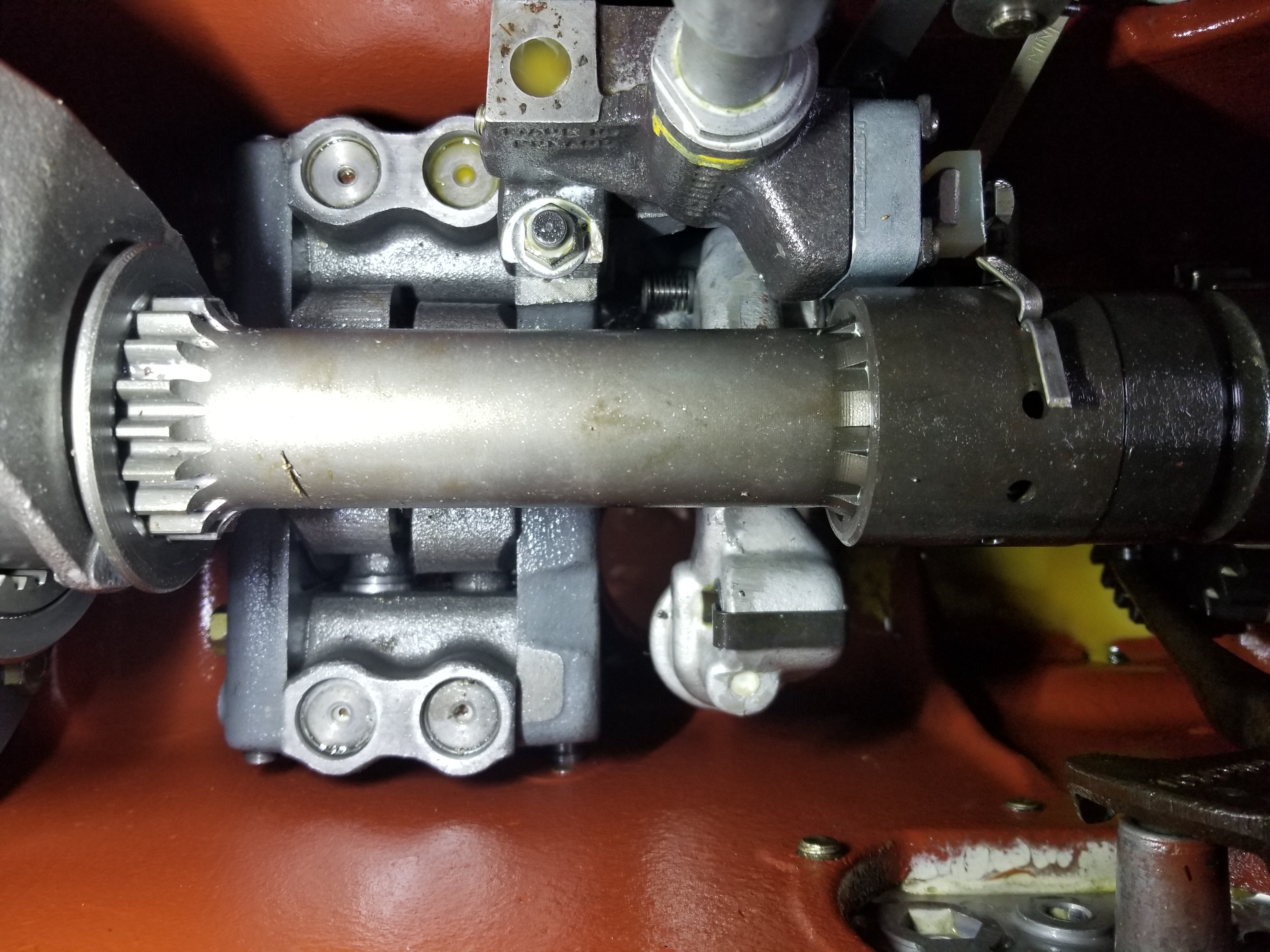

I have a MF 231 made in 1993. 3 point hitch seemed to work till I put a load on them. Would not lift the tiller or mower. I put a pressure gauge where the stand pipe comes out of the plate on the lift cover. Had only 500 PSI at best. Changed the filter and fluid, no improvement. ACGO web site shows/list a RELIEF VALVE (2800 P.S.I.) part number 828927M92. I took the lift plate off, drained the oil and can't find the relief valve. Does any one know what year MF stopped using the preset relief valve on their hydraulic pumps? MF 231 pump.jpg

There is no relief valve used in this tractor. The main pressure is controlled by the pressure control valve, the tall thing just off the side of the picture. It appears that after SN 9A349239 it was no longer used. I suggest you get a service manual to get the adjustment right before reinstalling the top cover. But if you have issues remove the right side cover and inspect for leaks with the tractor operating or lift the 3 point by hand with the tractor operating shut it off and listening and looking thru the cover for a leak. Be sure to check the stand pipe o rings as they sometimes will blow out and leak.

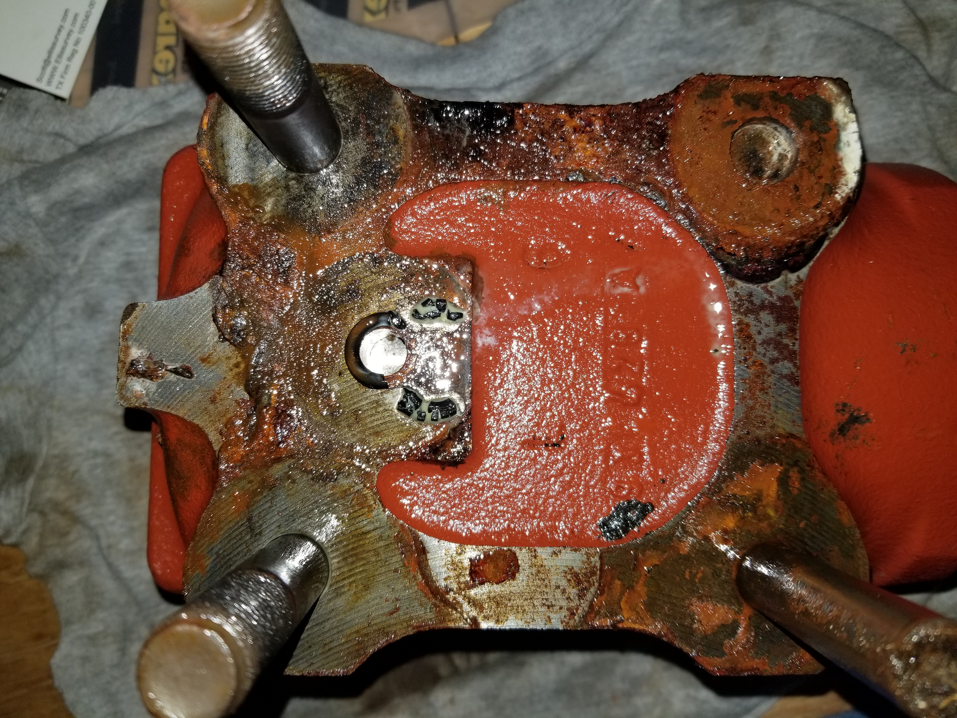

Thanks for the info about relief valve. MF web site had the old style relief valve listed in part list but did not state when it's use was discontinued. I did buy a service manual shortly after buying the tractor about two years ago. The drawings in the manual are not the best. I did see the adjustment on the new style relief valve but as the tractor only had 49 hours on it when I bought it two years ago I was having a hard time comprehending why someone would have been inside the tractor making adjustments. Anyway the problem turned out to be a blown out o-ring where the lift cylinder bolts to the bottom side of top plate. Blown out o-ring most likely caused by the two of the four bolt studs holding the cylinder were broken. All seems to be working so far. Used a 700 lb. mower Monday and a 6 foot tiller today. Also, I did buy two new stand pipe o-rings from a MF dealer, both the NEW black rings were dry rotted. I went back with the original ones.
