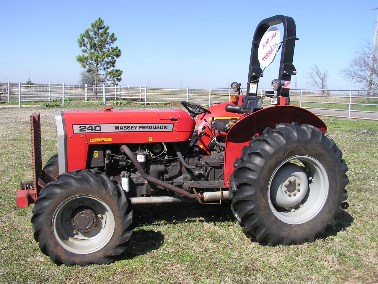

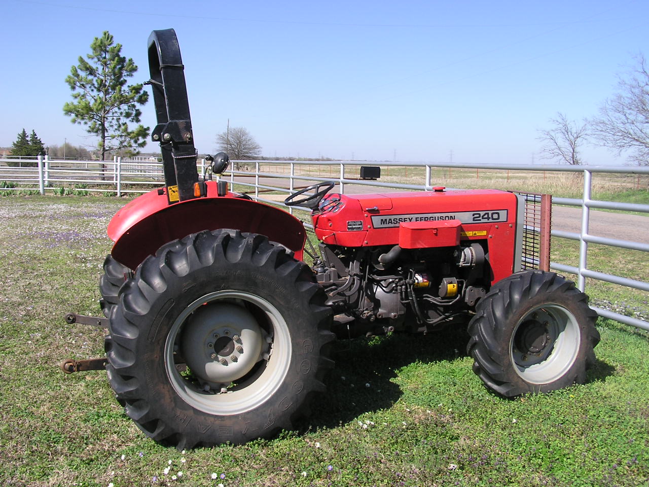

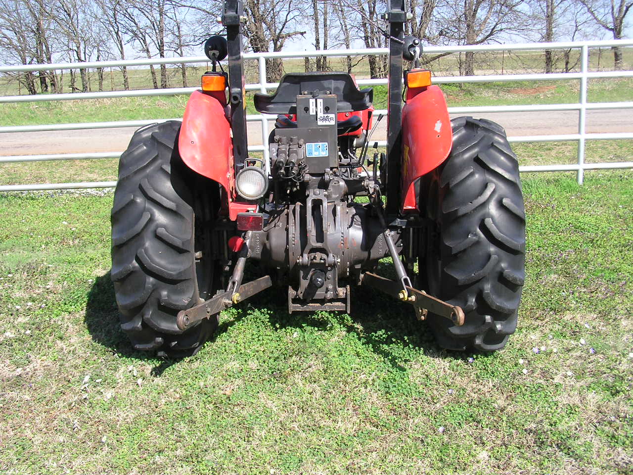

   / MF 240 and 362 compact or utility? #6

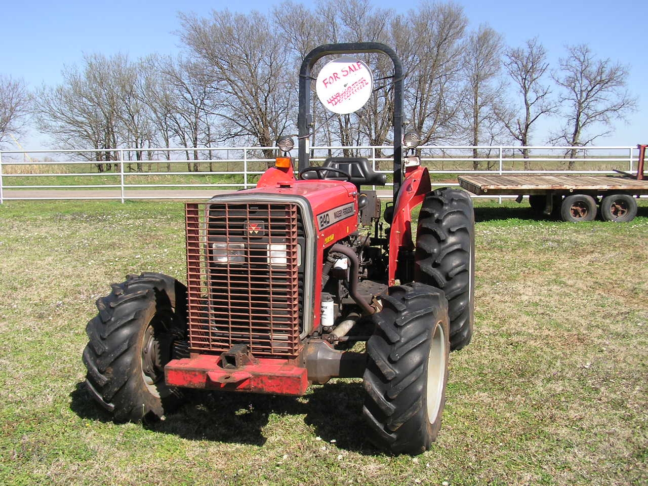

I had a MF240D, no FEL. Used a heavy duty 3 point, 7' brush hog on it. All 4 tires were filled with antifreeze, went across the scales at just over 6300 pounds.

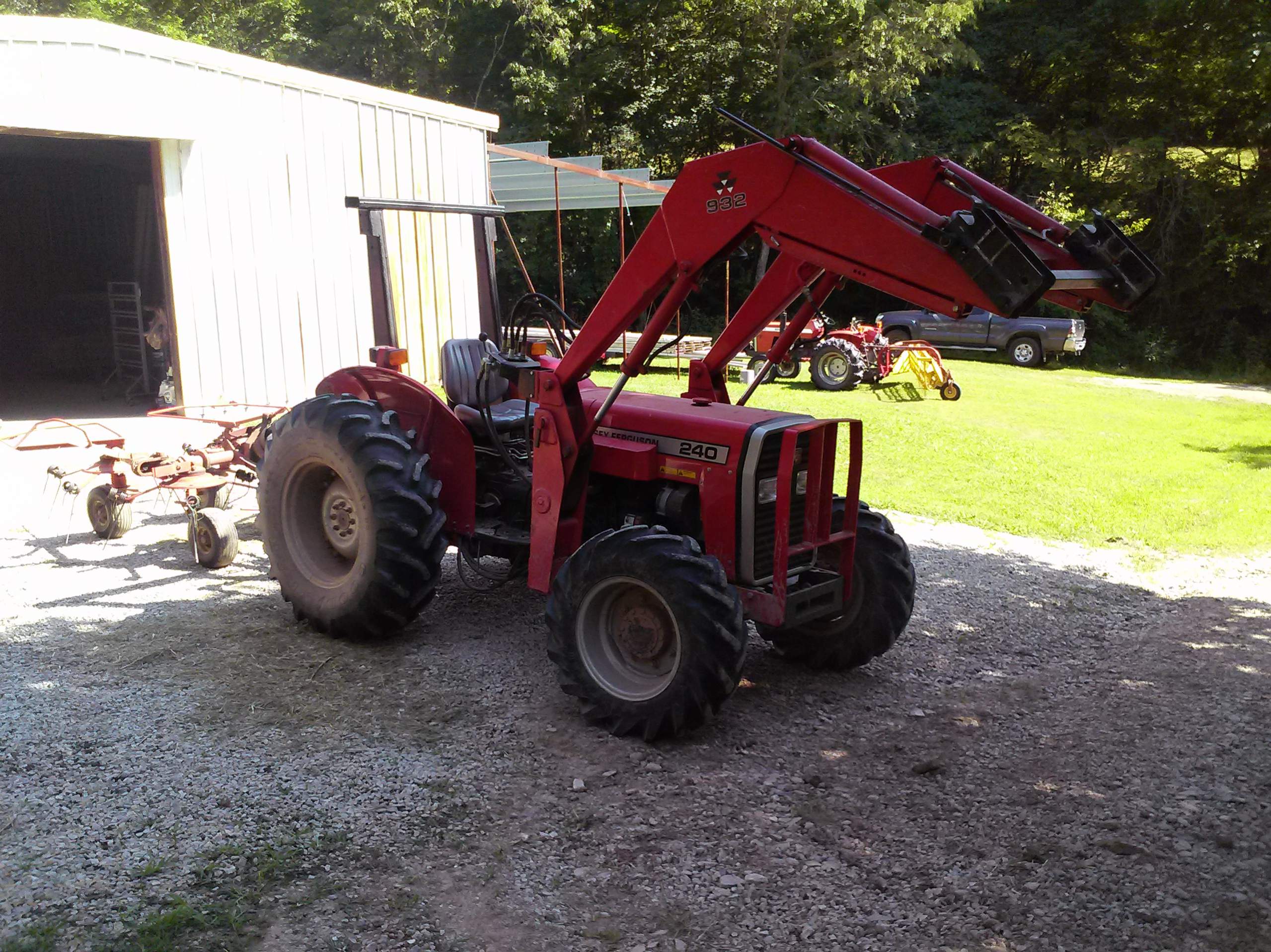

   / MF 240 and 362 compact or utility? #7
Hey rogdan, this is my first post, been lurking for a while. We have a 1996 MF 240 with loader and are located in WV. Its been a great machine. Like Agvg said, its a close cousin to the 35 - we also have a 1956 TO35 as well. Ours has fluid in the rear wheels. It weighed 5500 pounds dry, so Xfaxman's numbers with fluid are just about where ours would be probably.
We use ours for loader work and haying. We've mowed with a Krone AM-203S disc mower - that's used the most power of anything we've had on it and it handled it fine. The tractor is nice, because it has a lower center of gravity than some - feels a lot better on the hills. The 240 is an "economy" model, all mechanical, Live PTO (dual clutch). I personally like that - I've gotten used to being able to just stomp on the clutch if I want the PTO to stop. Ours has a 8x2 transmission, I'm not sure if a shuttle shift was available. The transmission is not synchronized, not a big deal for what we do.
I don't think you'd have an issue with it and a 6 foot brush hog. We've pulled logs with ours and its been good - usually use the 3pt hitch to lift the end before pulling (MF hydraulics are pretty good). Its definitely a solid utility tractor, just not as much power as the 362 would have. The 362 is probably solid as well, would love to have a look at it.
