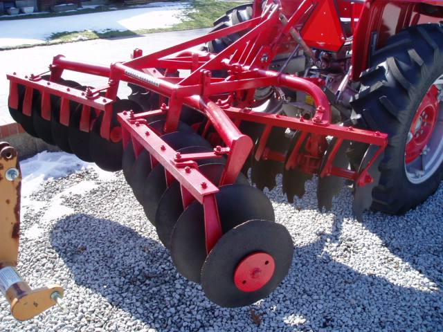

I have a MF-25 disc harrow that needs axle bearings.The orginal bearings consisted of a 2 piece top and bottom casting .A spool with ribs is inside the casting.It also has 2 grease fittings on the casting.Is this just a metal against metal bearing surface?The part #'s I have are 663848 M1 and 663843 M1. Is there a way to convert these #'s with Agri-Supply #'s.Has anyone been down this road before? Thanks...Ken

Mine had good bearings when I found it. No need to change 'em. A friend just re-worked his #25 and used the Agri-Supply boxings (cast iron bearings)
In so far as I know, Agri-Supply will only have one type of bearing halves. They're a generic fit, but they will work. Get the 2 halves as well as their matching spool. They're ever so slightly different but will work. Or. Get your wallet ready for a real beating and go to an MF/AGCO dealer and get the OEM halves. If you have a weak heart, take your nitro pills with you when you go.

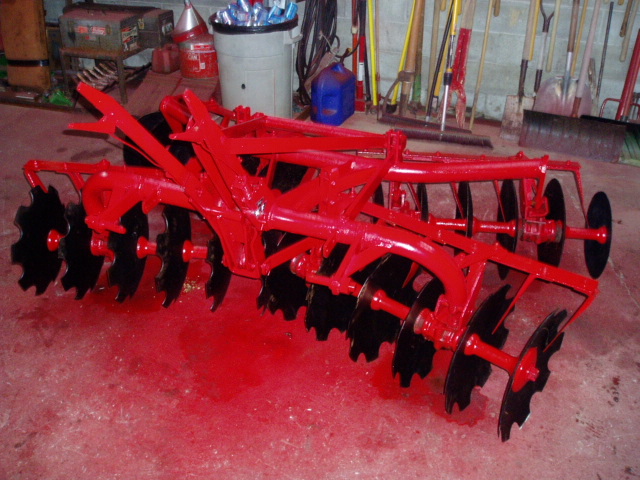

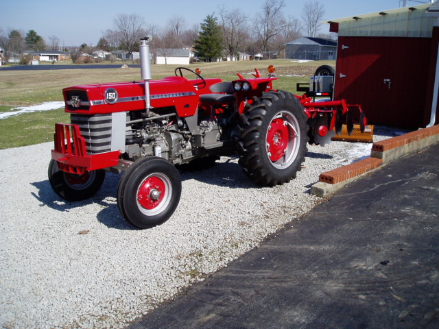

You did a GREAT job restoring that disc FMJ . Mine is the 6'6 version. I'm waiting for a manual that I got off e-bay.It should be here any day now.It works really good discing up ground.Other than the bearings , everything is in good working order. After I use it this spring, it goes into the shop for a paint job. Hopfully I'll get it to look as nice as yours.I'll take the bearings apart and measure to see what size I need. Do you recall what part #'s your friend orderd from Agri-supply...Thanks guys!...Ken

The #25 is, IMHO, the best 3-point disc ever built. They perform like a much heavier disc and leave a very nice finish on a seedbed. The short coupled construction means no need for excessive amounts of front suitcase weights.
Agri-Supply uses a bearing half that's the same top or bottom half. Part # is #28211 per half. The corresponding spool is part #28210

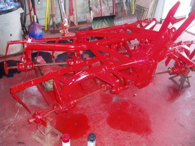

I tend to be a little obsessive with paint jobs and decals. Things have to be mechanically perfect first, then the sandblaster goes into action. Prime, paint, and decals.

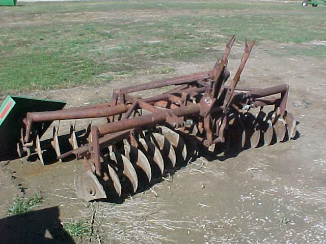

Saw this MF disc on Machinefinder and it looks like it might be a MF-25?
It's located in Illinois..... maybe FWJ can verify if it's a 25 or not.

That is a #25. Easily identifiable by the pair of gang adjusting levers.
