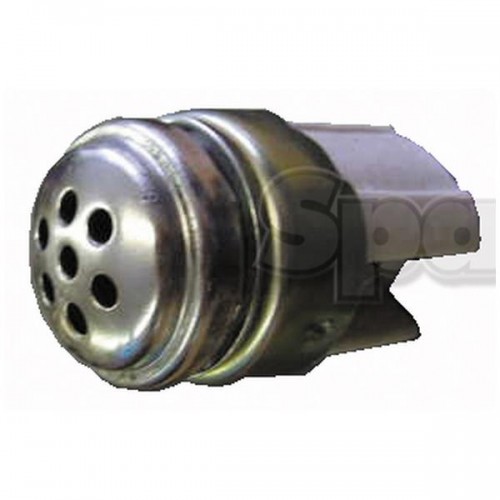

well if I connect a jumper wire from the metal feed strip at the glow plug to the plug I took out it does not get red hot. same with a new one. if I jumper right to battery it gets red fast. I did not see a relay in the schematic . looks like current goes from ign sw to glow plug light {coiled wire} then to glow plugs.

The indicator is not a bulb if it looks like this:
The indicator is a nichrome resistance wire and needs to be in the circuit.
   / MF glow plug voltage #8
That makes sense, Another "glow plug".
If that resistor is aged and thin, it will not carry much current either.
But, check all connection before condemning the indicator. Corrosion happens! If the indicator is cheap, just replace it and see.

yes that is the same glow plug indicator that I have but it doesn't glow when I hold the switch in. it used to glow but that has faded. That schematic is close but put the ign sw in place of the glow plug switch. does not show a relay. may just try to wire in a separate switch like piloon suggested

PS-- and yes, if that indicator glow plug is in series with the rest (as it should be) and it's flaky, that will also create the symptoms. You might try bypassing that to see if the others get hot.
