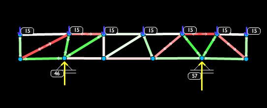

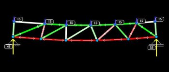

The problem was they backed it in supported by the ends . This unloaded the tension . 2 trucks instead of 4 . Before they recovered tension , snap .
   / Miami pedestrian bridge collapse #117
Incorrect. The original plan was to drive it into place supported by the ends. That was changed partway through to move one of the platforms from the end to 1/4 of the way in from the end and remove the spreader plates.
It is suspected that they had to change the tension to accommodate this and they were re-adjusting the tension to where it needed to be as a bridge when it failed

From California's link in post 86:
http://www.eng-tips.com/viewthread.cfm?qid=436699 said:
Just in case anyone is interested in a rough idea of the tension / compression loading of the trusses when:
A-In transit supported underneath in 2 places mid span
B-In Situ supported at either end of the span
These are not to scale or necessarily accurate, but give a general idea. Draw your own conclusions here.
A:
547404d1523022336-miami-pedestrian-bridge-collapse-transport_op5mdy-jpg
B:
547405d1523022347-miami-pedestrian-bridge-collapse-insitu_iec86z-jpg
