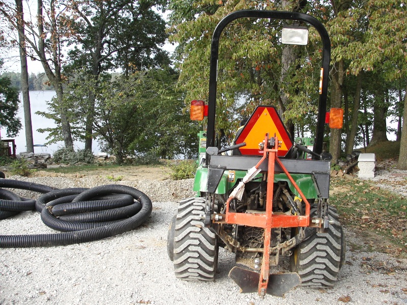

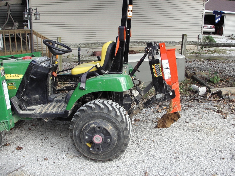

I have FarmForce SC subsoiler/middle buster combo bought at TSC and I've been happy with it. I use it to run through the garden before tilling the concrete like clay here.
I've also used it to trench for running water, electric, and drain. I feel it was well worth the money. My tractor is similar in size to yours, I had tried a full size subsoiler and it wouldn't raise far enough off the ground to transport, this one fits well.

Thanks, KML. Full size wouldn't lift high enough? What is overall height of the one in the pics? I probably would have problems with full size myself then. Yours are maybe the lighter duty and weight for the subcompact tractors? Are they comparable with like the king kutter XB models? They only weigh about 50 lbs and not sure they would stay in ground or be strong enough. hjt

It measures 21" from the pins to the tip of the middle buster. It does look to be about the same as the XB and I'd guess the weight at about 50 -60 Lbs.
Don't get me wrong. I'm sure extra weight wouldn't hurt but the angle of the blade gets it into the ground. Adjust the top link right and it pulls itself right into the ground and stays there. As far as strength, I did modify mine to fit a quick hitch and that subsequently added some strenght to the cross beam which is the weakest part of it. The main vertical piece is 1" x 4" so it should be plenty strong. Even ballasted I loose traction before the anything breaks.
All of them out there seem to use the same basic design. The only one I've seen that's different is one that Rural King carries:
https://www.ruralking.com/Store/detail.aspx?ID=16669
It looks to be well built and is shear bolt protected. The design would make it pretty easy to drill a few more holes and make the height adjustable for SCUTs. The only down side is it's more expensive than most, almost double.

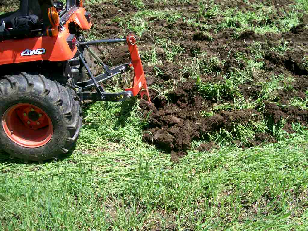

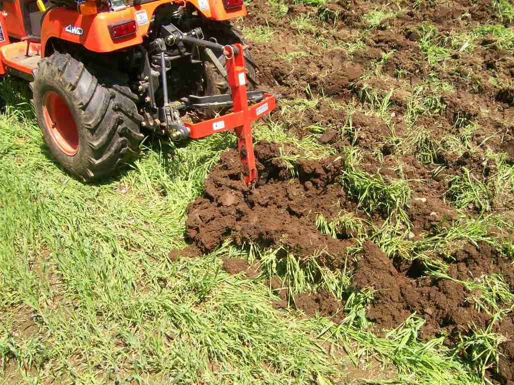

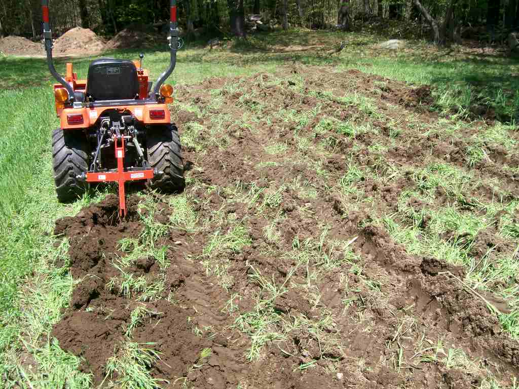

I'm late to the party here, but I bought the XB size combo from TSC a couple of years ago to go on my BX. I didn't get to use the subsoiler, but I did use the middlebuster before selling it with the tractor. Now I wish that I had kept it since I think it would work fine on my B2620. My soil is clay / loam with a bit of gravel here, and there. Here are a few pictures of me turning under some winter rye before tilling. I was playing with the angle of attachment a bit to control depth better.
