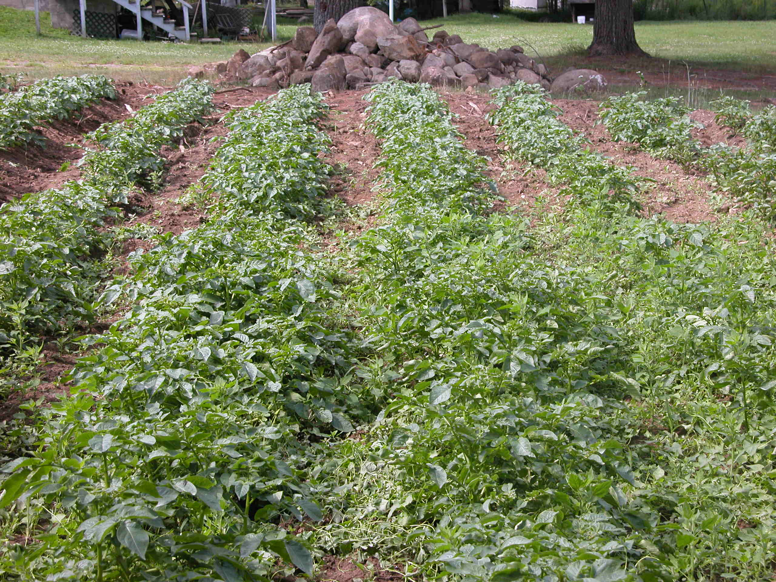

I have attached the only digital photo I have of plants/hills at about 7-8 weeks. The weedy rows in the foreground are the Red Norlands you have seen harvested. They are not hilled due to my busy schedule and carelessness, and they are weedy. In the upper left you can see clean and hilled rows of Superiors.
The vines are beginning to get into the row middles and will eventually completely cover them. The Norlands are worse in this regard than Superiors, which are more erect in form. Potato cultivars vary a lot in terms of growth habit and other physical features.
