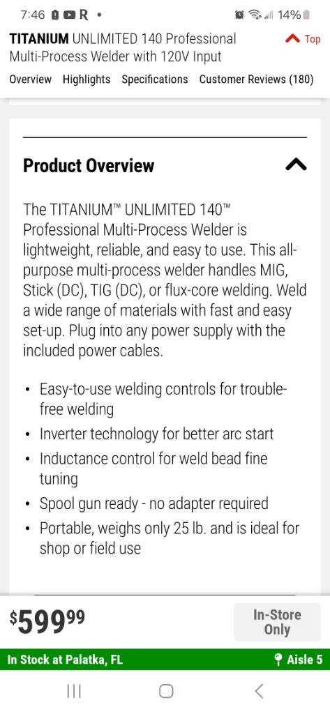

IEastwood has one on sale right now, seems well received. Unsure what to look for… 110v is all my house has right now.
Is this the one you are looking at???

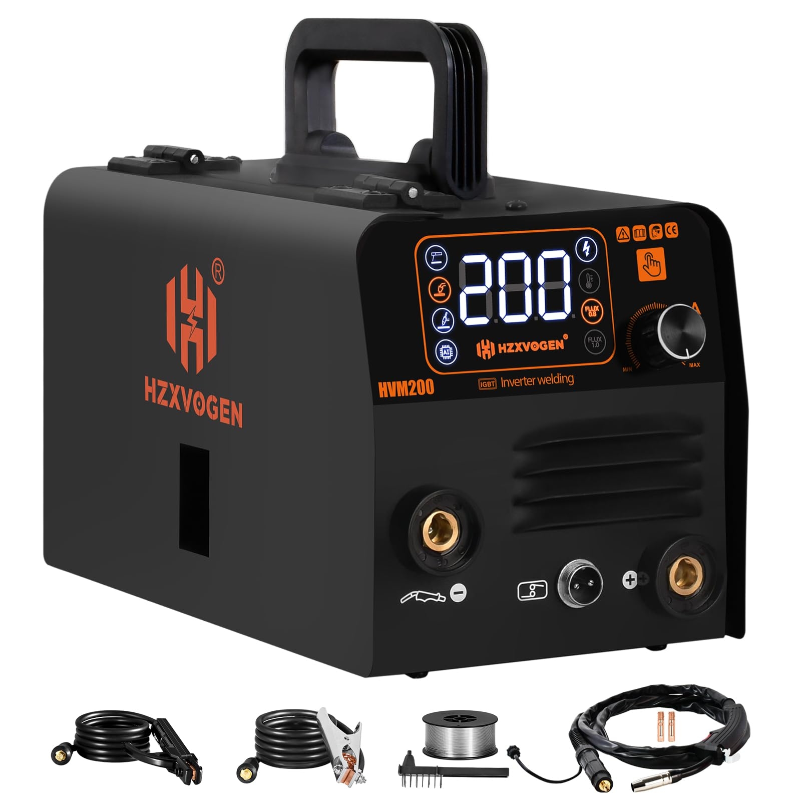

Just read the whole thread and in some ways more confused than when I started.
I have a very old Kodiak flux core mig that never worked right. Feed issues, and only setting is a high/low switch.
I haven't needed a welder for around 20 yrs, but I find I could use one here and there now, so.....
I bought a cheapo 3 in 1 from amazon that I can not even begin to pronounce the name of. I chose one based
on price, reviews, and hours of videos reviewing that exact model. $128 Cdn, which I think is like $900 Usd :)
Plugged it in for the first time about 3 hours ago. Read the instructions and all that first. Double checked my set up. then
touched the mig torch to some metal ...... nothing. Re-checked everything. Nothing.
Put the MMA torch on and got some sparks. Wasn't worried about actually trying to weld anything at the moment.
Back to the FC mig, nothing. (Electrode negative BTW)
Any guesses why I get nothing from one torch and something from the other?
This is a 200a machine, and I admit I don't know much about that stuff so I read some charts I printed to check amps etc.
and still no mig.
I gave up quickly because I didn't want the machine flying across the yard yet.
Back to the net to see if I could figure out what I'm doing wrong, and discovered I don't even know if the screen is showing amps or volts.
It's some kind of magical machine that when you set one parameter, other parameters like wire feed set automatically.
Went to manufacturer site and noticed some of their other similar machines show a dial marked V and some marked A, so I glean because mine is marked with an A, it must be showing amps (goes from 20 to 200). BTW, the manual is VERY vague and poorly written.
It uses 0.8 wire at the moment, which is .030.
Is it possible I just need to crank my amps up to get any kind of mig reaction? I only went as high as 75 on the screen but figured that should have given me something.
I was going to buy a FC mig from our version of HF because of the return/exchange policy like HF, but they go on sale for $138 and they sell out like Pink Floyd tickets. You almost need to meet the truck dropping them off to get one.
Hoping I don't have to return a faulty machine, and I'm just doing something stupid.
I had to learn to weld about 40 yrs ago to get a mechanics license, but never used electric welding for my job, lots of oxy/acetylene though. I was
never good with the MMA/mig to begin with.
Here's the exact model I bought if it makes thing clearer for anyone who may be able to help.

So, got some questions, and please don't take any offense if I ask something stupid:
1) when the mig gun is plugged in, powered up, does wire feed out the gun? if not, does the feed rollers try to feed? if the feed rollers roll, but not wire, is the gun and whip held out from the machine at a more or less straight run?
2) If wire is feeding out the gun, do you have good ground contact, both on the work piece, as well as the dinse connector on the machine?
3) does the machine have a switch or dial that needs to be reset for Mig/FCAW?

1) Everything is set up as it should be. Wire feeds well. (Feed problem I mentioned in my novel was the old welder.)
2) Connections on the machine are good as built. Twist and lock. Checked them at first fault. Ground contact might be sketchy
but I did scratch the metal a bit with sand paper. Just 2 small pieces to practice with. I also did something I am reluctantly admitting...
I smacked the ground clamp with the torch/wire looking for spark. nothing.
3) That pic is exactly my machine. The feed was set to mig. You cycle through the little pictures to match. Although I have no idea what the AI position on the bottom left is for. Manual doesn't do anything but tell you name.
/ MIG Welder for Beginner/Light Use #60
It 'sounds' to me like there is a setting that needs changed, to the mig whip, and then possibly, the Amps read out will also turn to Volts? The picture, stock picture I assume, you see how the mig gun symbol is lit up in orange, was your similar when you tried
Stock picture but my model. I was under the impression when researching welders that you could switch the volts or amps according to your own preferences, but in hind-sight, it may have been one or more of the other brands I spent hours comparing.
The symbol is highlighted in a hard to see orange. I guess to compliment the orange logo writing etc.??
Based on the turnable knob having an A beside it (1 o'clock position) I think it's safe to say it's programmed in amps.
To that end, what would be a setting for 1/8 metal. Test pieces. Should I have cranked that setting higher than 75 when testing?
