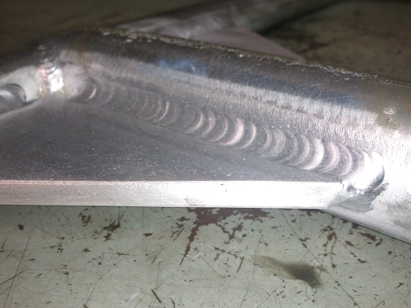

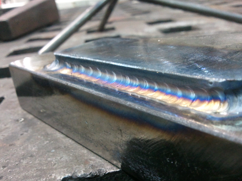

Heres some tig, and some mig like tig I recently done.
   / Mig welding aluminium #42
Steel is a bit easier to do that with IMO. But even then, up close, anybody that is proficient at both MIG and TIG can tell tehm appart.
   / Mig welding aluminium #43

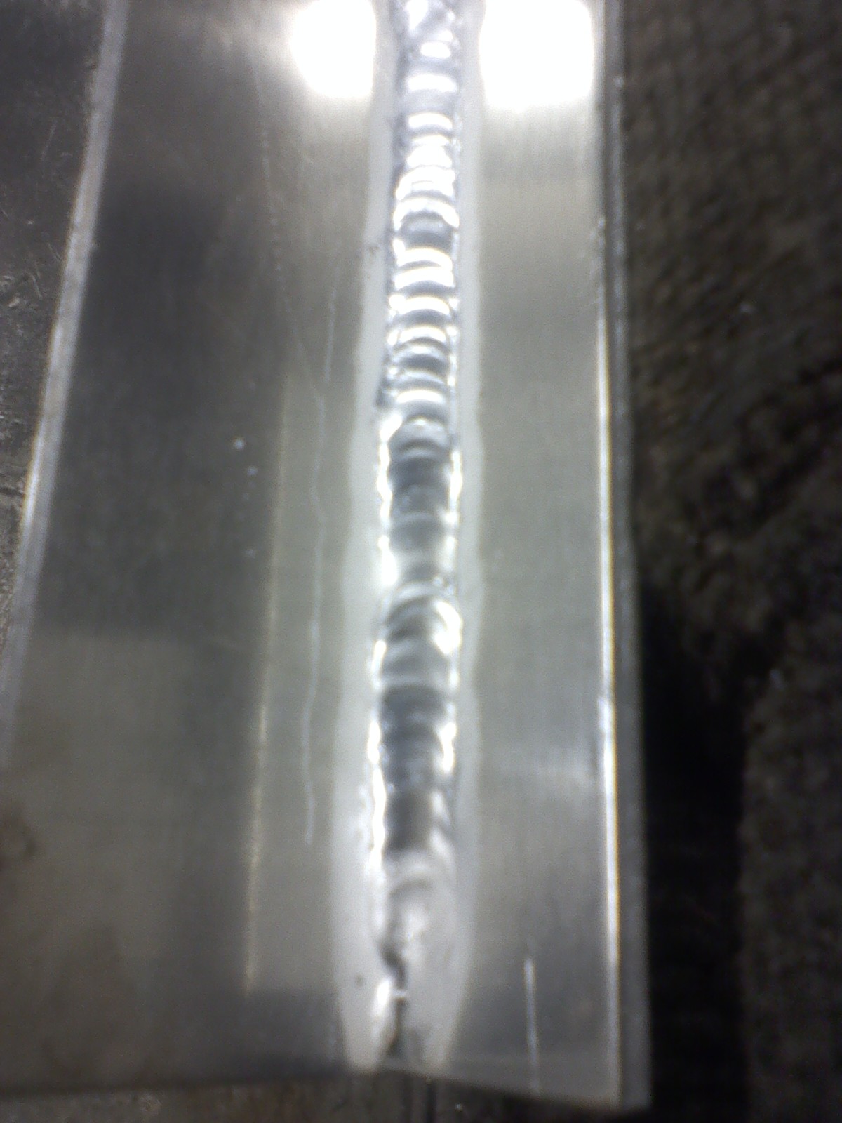

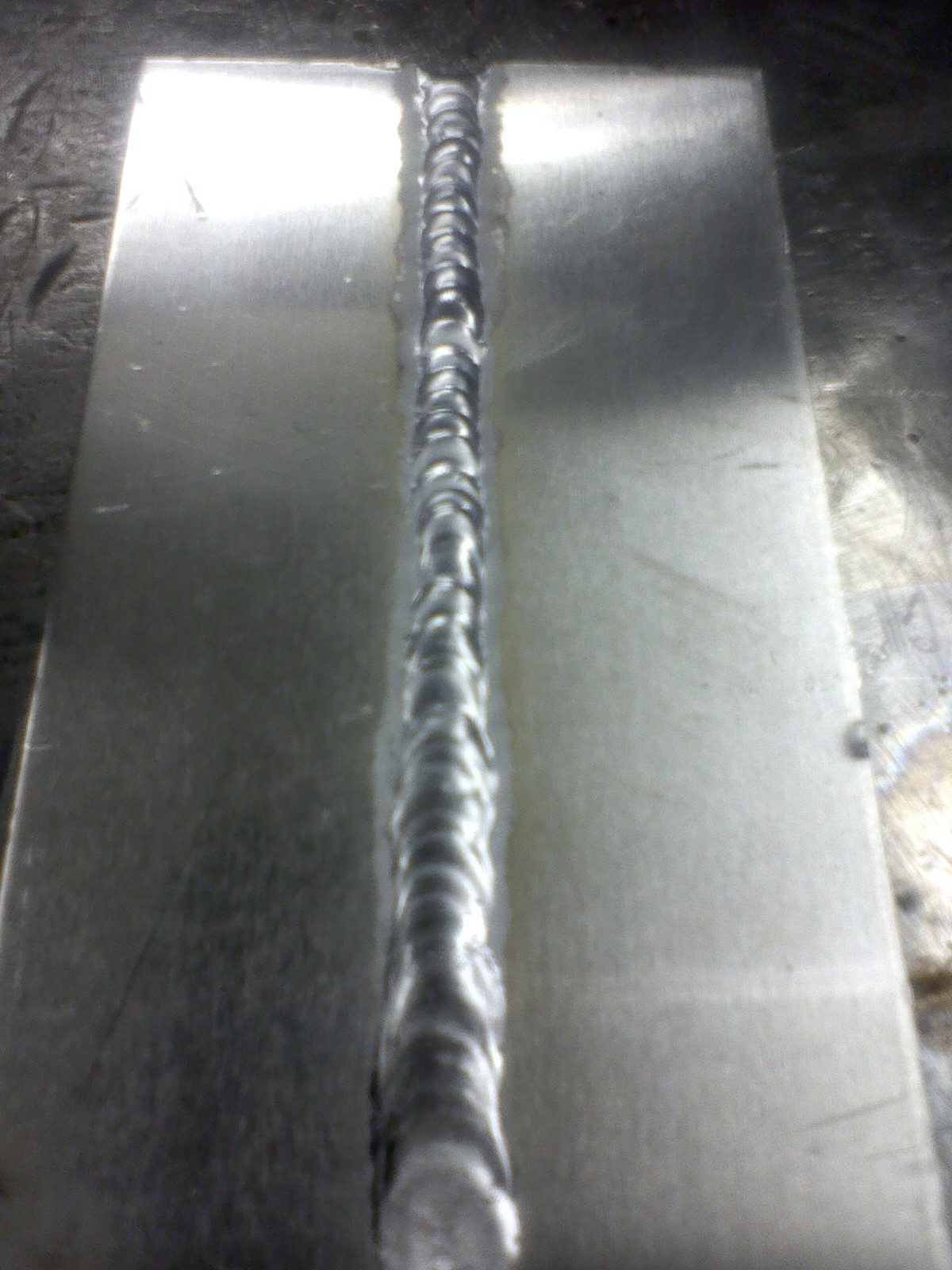

When I was younger I used to struggle with aluminum, but through time I worked through it and actually find aluminum easier than steel. Hard to say, but just an easier feel for me, almost like the puddle isnt so watery so too speak. Heres a few that were done recently, one was a job, the other just goofing off cause someone told me it would be impossible to weld 1/4 with my 180 amp syncrowave.
   / Mig welding aluminium #44
I have had similar experience. Allthough I wouldnt call it easier, but I do find it easier to fill a larger void or gap with aluminum and with steel. Seems the puddle just stays "put" better IMO.

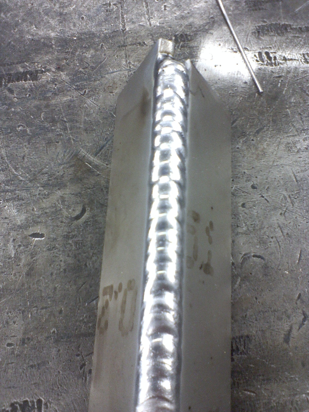

Woodsmith, after reading all the suggestions from the other members and I agree with most of them, here is something different and save you a few bucks. The cleaning is the most important overall, but instead of buying degreasers, solvents and such, just use vinegar. You say you used a s/s pad to clean with, thats good as long as you only use it on aluminum and always use a clean side or you're just rubbing contaminats back into the metal. After the pad, spray or brush it with vinegar, that will nutrilize the metal. Without a spool gun its hard to use the smaller size wire, really need .030 but to help absorb the heat from the bigger wire and give you more metal to work with get some aluminum rod, 1/8,5/32 and lay it between the tubes where you are going to weld, be sure to clean the rod too. I differ with a couple quotes here, you can make mig look as good as tig. I have been welding for over 40yrs and although tig is good, mig is faster, I hope this helps in some manner.
Cheers, I was keeping to the clean side of the SS pad but the vinegar is a good tip, I'll try that.
I got my Durafix rods today.
First go with one.
Looks nice like that, though the horrible bits around it are some of the failed MIG attempts from last time.:eek:
On some of the videos I saw the surfaces being 'tinned' first and the SS brush used to brush the braze into the surface. I tried that too and now have a brush that is caked in braze!:mad: So much for it not sticking to the SS!:rolleyes:
Gotta get another brush!:thumbsup:

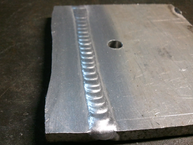

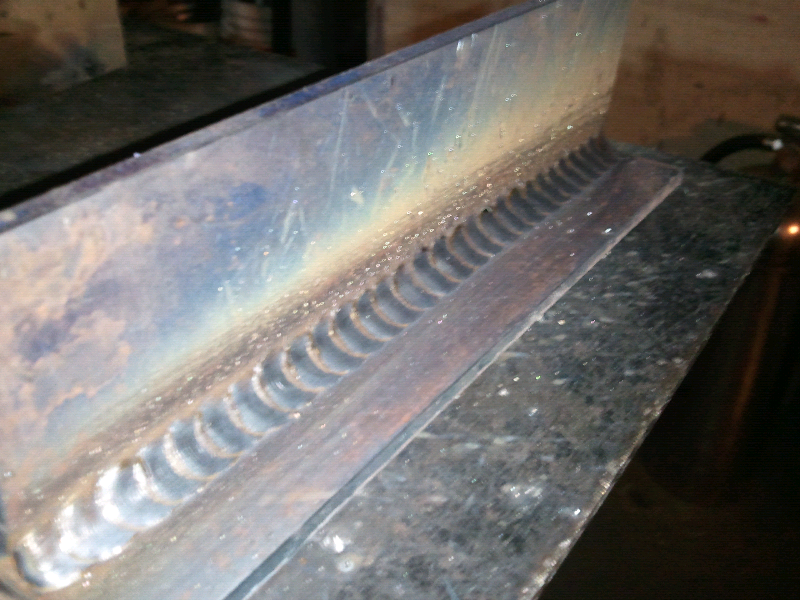

Heres what a dynasty 200 can do with a hack like me.
This is 1/4" 6061 plate, outside corner fillet. Machine settings: 190A, 70% balance, 129Hz with 1/16" tungsten. (I know, but I was too lazy to put a bigger one in).
And these is with 1/8" 3003 plate. One flat weld with no gap and the other Tee joint. Machine set at 100A, 70% bal, and 129 Hz, same tungsten. tig 2.jpgtig 1.jpg
I wasnt real steady with the flat, but I had my thinner gloves on and it was getting a tad hot and I didnt feel like stopping once I started:banghead:
Again, I dont do this everyday. All total I have maybe 10-15 hours of Tig aluminum time. I gotta give all the credit to the machine I think. And my apologizes for the crummy pics. A camera phone is all I got.
