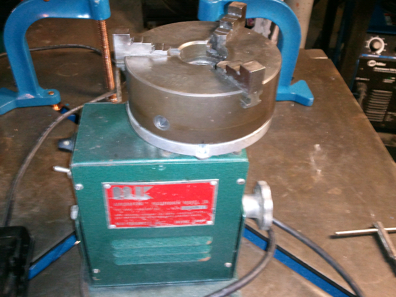

Yeah that was bad bud. Almost makes you wanna not help these kids, but I still fall for it anyway, I cant help it. I took my lazy azz nephew catfishing one night and the first fish was a good one for a pond, about a four, five pounder. After I hooked him I handed the rod to my nephew. He stared at me for a few
seconds, and said, Uh can you do this for me! WTF I told him, how lazy can you be, you cant even reel in a fish! AND THATS FUN!!! Well anyway my brother told me my nephew thinks im mean, so I told him to f off as well. He always needs me so he just shrugs it off and always comes back. But jeez, this country is doomed. Anyway shield, just got in from work and wanted to share a pic of the positioner I got. $500 used, but im very pleased with, it saved alot of dough!
   / Mig welding aluminium #54
Now if that doesn't take the cake, a kid too lazy to reel in a fish!:rolleyes:
$500.00!!!!!!!! Man that is a screaming deal!:thumbsup:

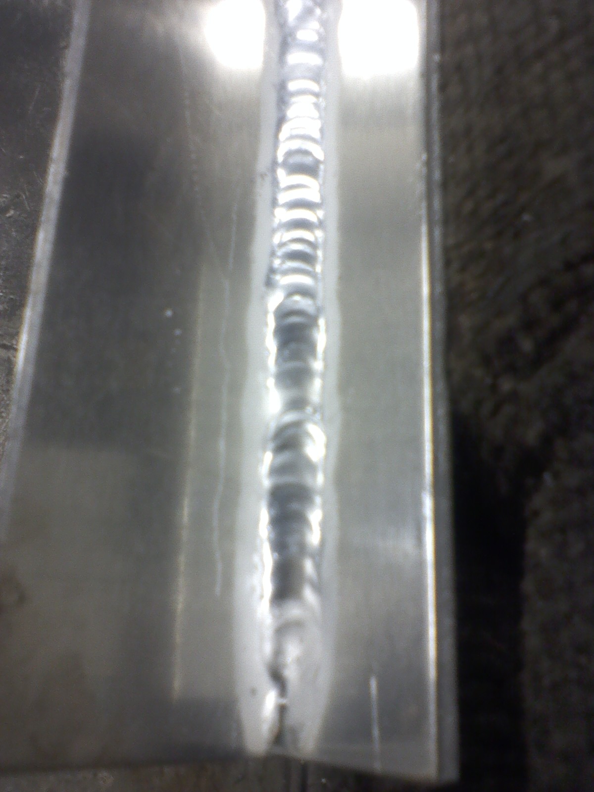

Heres what a dynasty 200 can do with a hack like me.
This is 1/4" 6061 plate, outside corner fillet. Machine settings: 190A, 70% balance, 129Hz with 1/16" tungsten. (I know, but I was too lazy to put a bigger one in).
And these is with 1/8" 3003 plate. One flat weld with no gap and the other Tee joint. Machine set at 100A, 70% bal, and 129 Hz, same tungsten. View attachment 285983View attachment 285984
I wasnt real steady with the flat, but I had my thinner gloves on and it was getting a tad hot and I didnt feel like stopping once I started:banghead:
Again, I dont do this everyday. All total I have maybe 10-15 hours of Tig aluminum time. I gotta give all the credit to the machine I think. And my apologizes for the crummy pics. A camera phone is all I got.
Hey now. I am probabally what you guys would call "one of these kids now a days":laughing:
I think I could probabally say something like " Its a wonder anything ever got done in this country with you old farts":laughing:
Nice job.
Get one of Jody's "Tig Fingers" for the heat problem.
