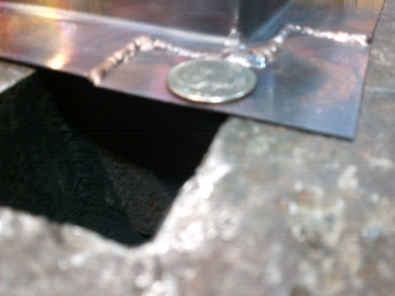

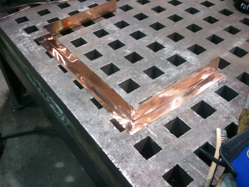

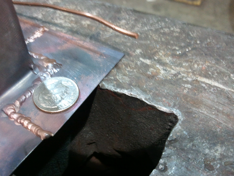

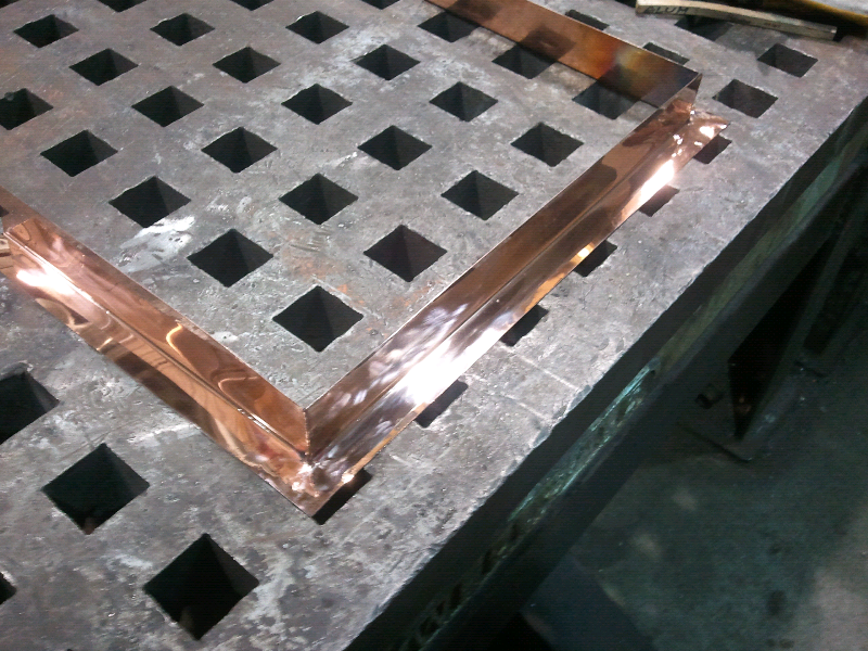

LD, if you really want a brain focus, finger burner give this a shot, 28ga copper sheet. Ugh this project is killing me. Doesnt help that im using #6 solid house wire, probably around 3/32.
   / Mig welding aluminium #63
I don't know your application but I simply solder sweat copper sheets. I built a crook for my chimney 20 years ago and it is still in good shape with this method. If the seam is stressed I use mechanical bending to add strength.
Rob
   / Mig welding aluminium #64
Rob
Strictly ornamental Rob, didnt want any discoloration in the blend work. Just finished the blending and polishing about 2 minutes ago! LOL

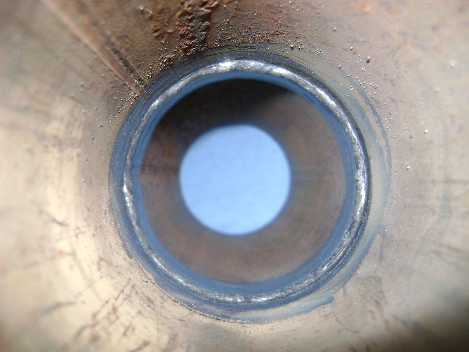

I know some guys do root passes on pipe with a TIG.
James if you really want to improve your Tig welding skills get some 2-inch to 4-inch pipe, grind a 37 1/2-degree bevel on it, use a 3/32-inch drill bit to set the gap. Use 1/8-inch filler rod, and make 4-tacks, 3, 6, 9, and 12-O'clock. Place it on a 45-degree angle, (6-G). When in the 6-G position you have to use both hands to make the weld! On the right side of the pipe you'll hold the torch in your left hand. On the left side of the pipe you'll hold the torch in you right hand. Trust me, this will really improve your Tig welding skills. ;)
First picture is the inside of a pipe I Tig welded. Second picture is of the outside of the pipe.
