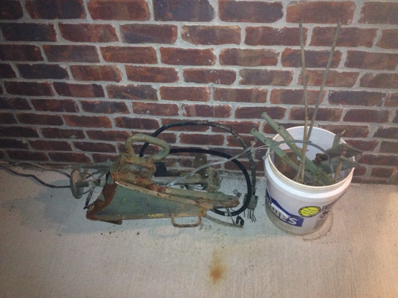

Pulled off the bed this weekend and will start cleaning up the frame this week. There are lots of brackets that are no longer needed.

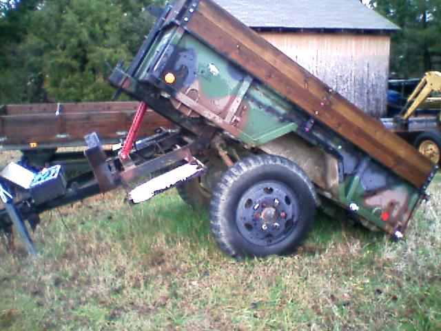

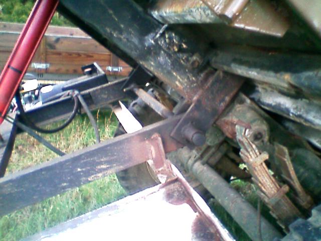

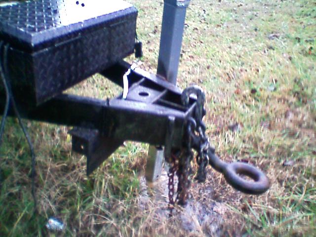

Some pics of my dump m105 it's not perfect but works pretty decent. I've pulled it on the road a few times with my 3/4 ton but it's mostly for behind the tractor around the farm.

Thanks for the pictures. I have not been able to find a lot of these conversions with much detail. I like how you got the hitch lower when adding the lift.
   / Military trailer turned into a dump trailer? #48
I actually removed the whole front trying to shave a little weight then built it back with 4" channel and reused the pintle part. The channel goes all the way to the front of the leaf springs to make the pivot it really doesn't dump high enough to get rid of everything like I wanted so I wish I had made the box dump instead like a traditional dump but thought I had a great idea at the time.

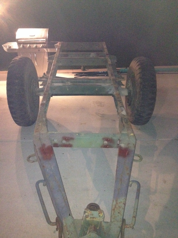

Cleaned up the frame some tonight. Almost time to try and get the old axle out from under it.
