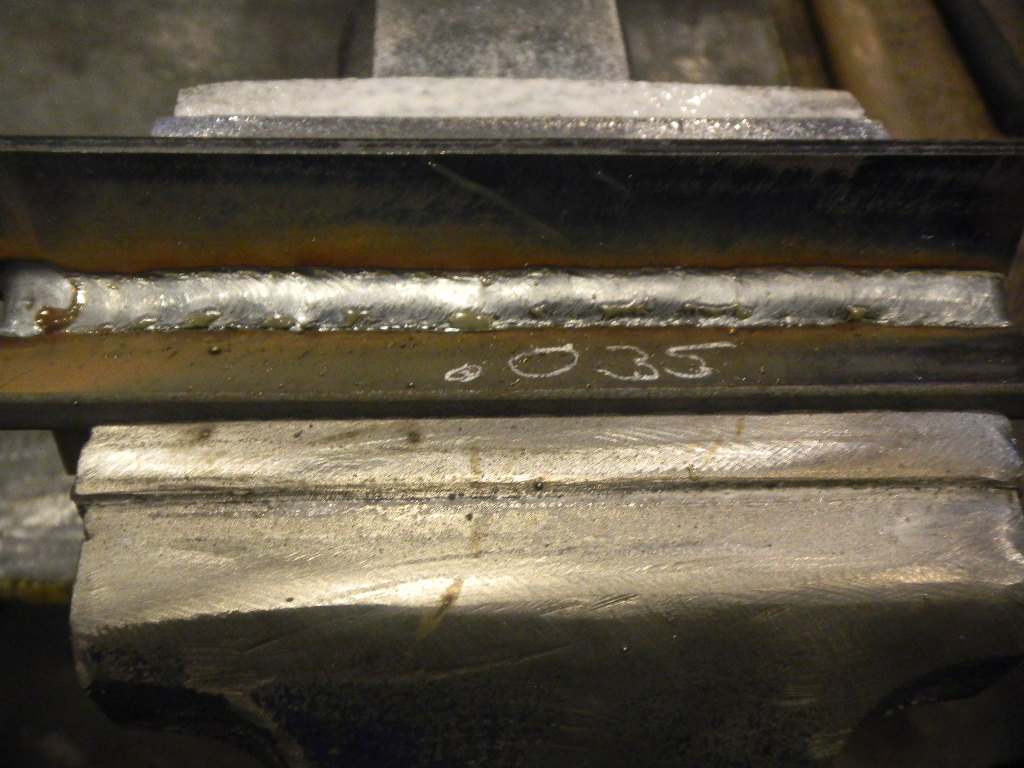

You can run some suitcase MIG wire feeders on CC as well
Yes you can run the feeders on CC, but the Mig process is best run on CV. I have run the Mig process on my 1966 SA-200 Red Face without a CV box, but I don't recommend it.
