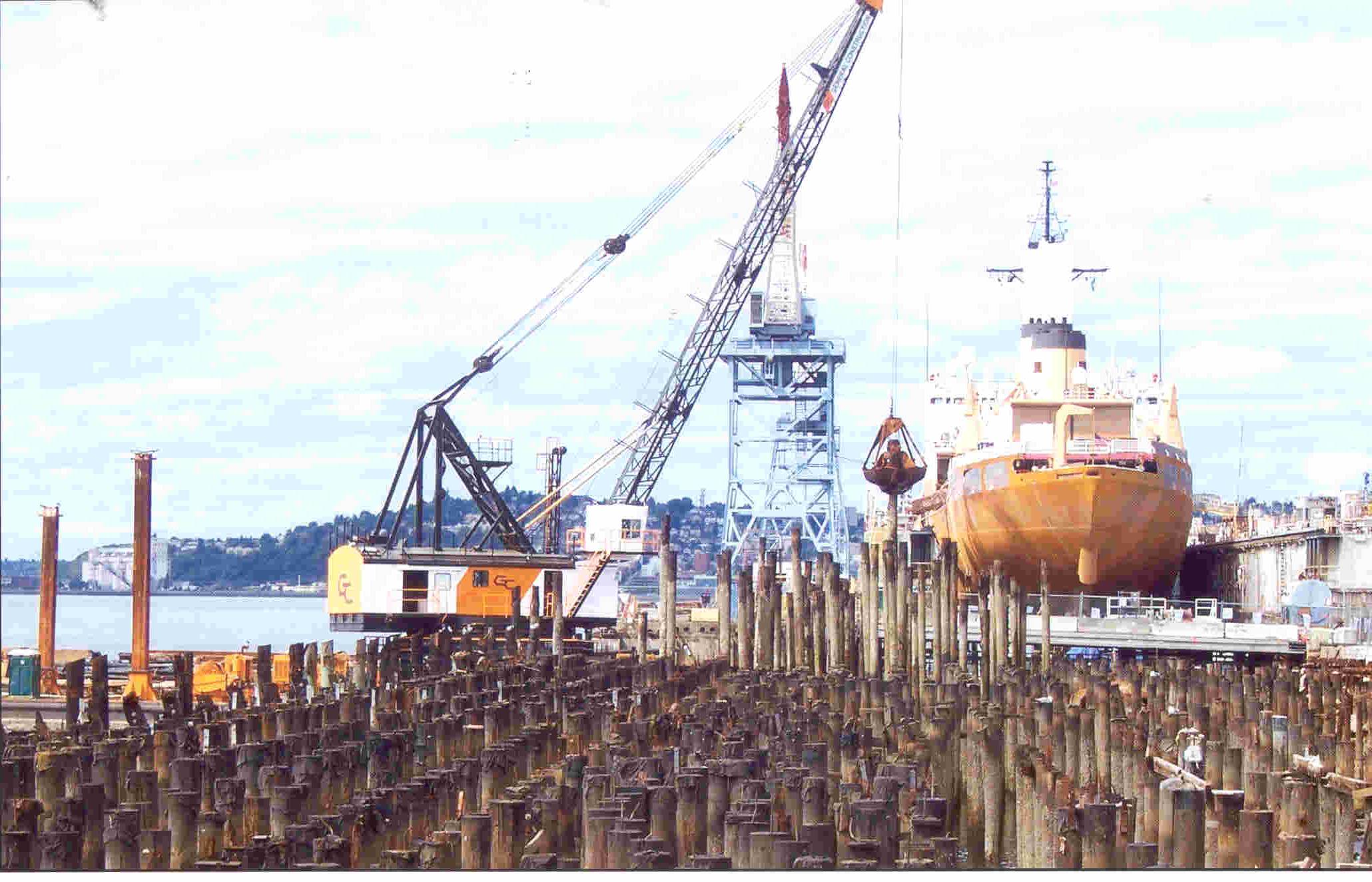

Arc weld where the pad eye was welded was on top of a spud. 99% of all derricks have deck winches that pick the spuds. This little chicken **** out fit wouldn't spend the money to set it up that way:rolleyes:. When ever we wanted to move the barge we had to pick the spuds with the crane, pin them off move then set the spuds on the bottom with the crane. Before I went to work for this out fit this pad eye got bent. When the owner of the company made me a foreman, then general foreman I begged him to let me cut that pad eye off and re-weld it, but he was too cheap!:mad: I did some research and found out who originally welded the pad eye on. He had worked for me a few years before this, not a bad weldor. But you can't blame him, because the pad eye was damaged.
In the states if you work on navigable waters you are under the laws of USL&H act, not Labor & Industries.
For the ones who don't know what spuds are:D, in this picture they are the square units on the left side of this picture with the chocker on top.

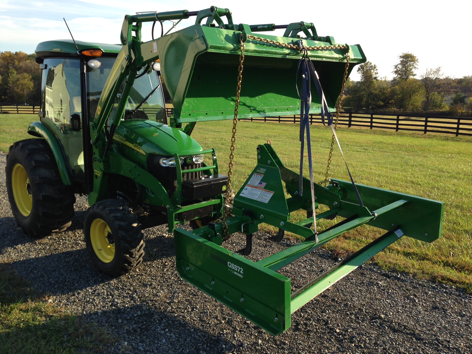

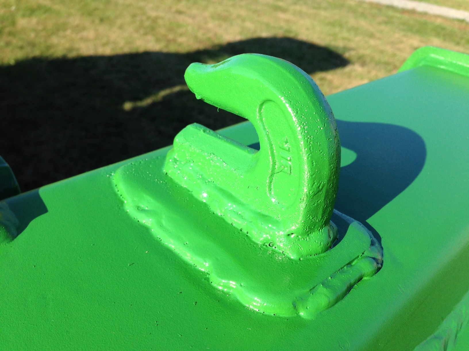

Finally got around to posting some pics. This past weekend, I was able to spray some paint on bucket and finish the job off. I can see these hooks coming in handy for several jobs around my farm, so hopefully they will stay put!photo1.JPGphoto3.JPGphoto (4).jpgphoto2.JPG
   / Millermatic 140 for bucket hooks #29
Dano,
I don't want to throw cold water on things, but those welds are very suspect. Without picking it apart, I see several issues, including cold lap, incomplete fusion and porosity. Please don't rely on those for any serious weight or use them with someone near by. Not trying to be a pain, or trying to flame you. Just concerned about this and the safety issue it presents. Most 140 migs really peak at 90 amps, a little known fact. Rarely do they reach the 140 mark. If you had done it at 140 amps stick, it would be plenty.
   / Millermatic 140 for bucket hooks #30
while those welds look fairly sturdy, the heat may have not been quite enough. not really a problem as long as you don't trust them
with life and limb. keep an eye on them from time to time to see if any cracks or separation show up or if they appear stressed in any way.:2cents:
just saw that it was a mig weld. ran one for years and they are notorious for cold lap as the fella says. i'm revising my statement to say be very very careful.
