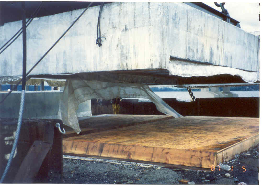

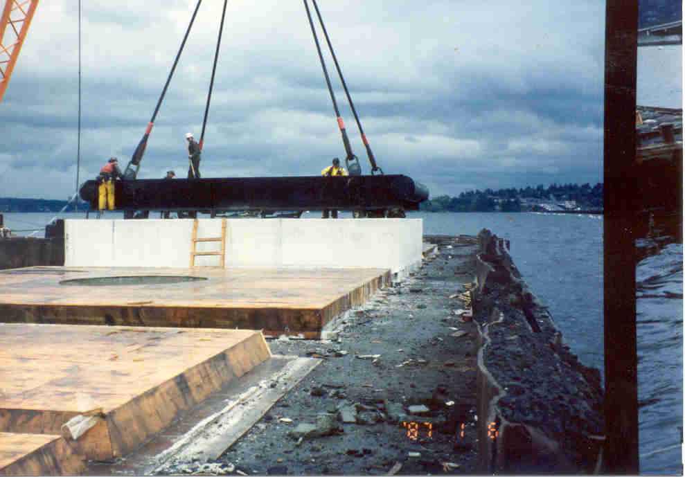

Dano33 one thing to remember, try to never get under a load. Sometimes this just can't be helped. Setting these 300-ton anchors, couple times I had to get under them:eek:. Didn't like it, but sometimes it just can't be helped.
