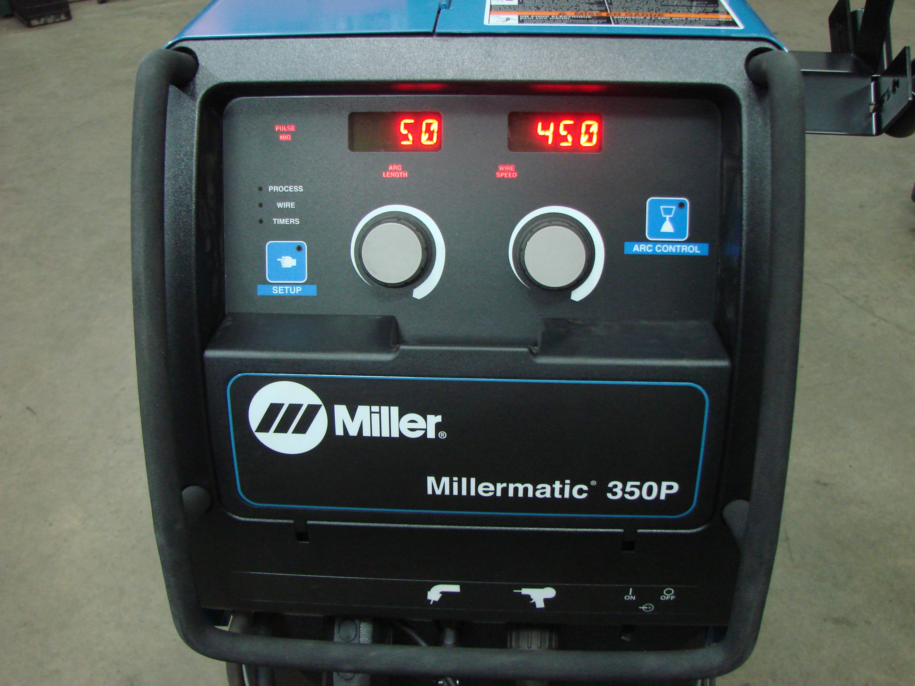

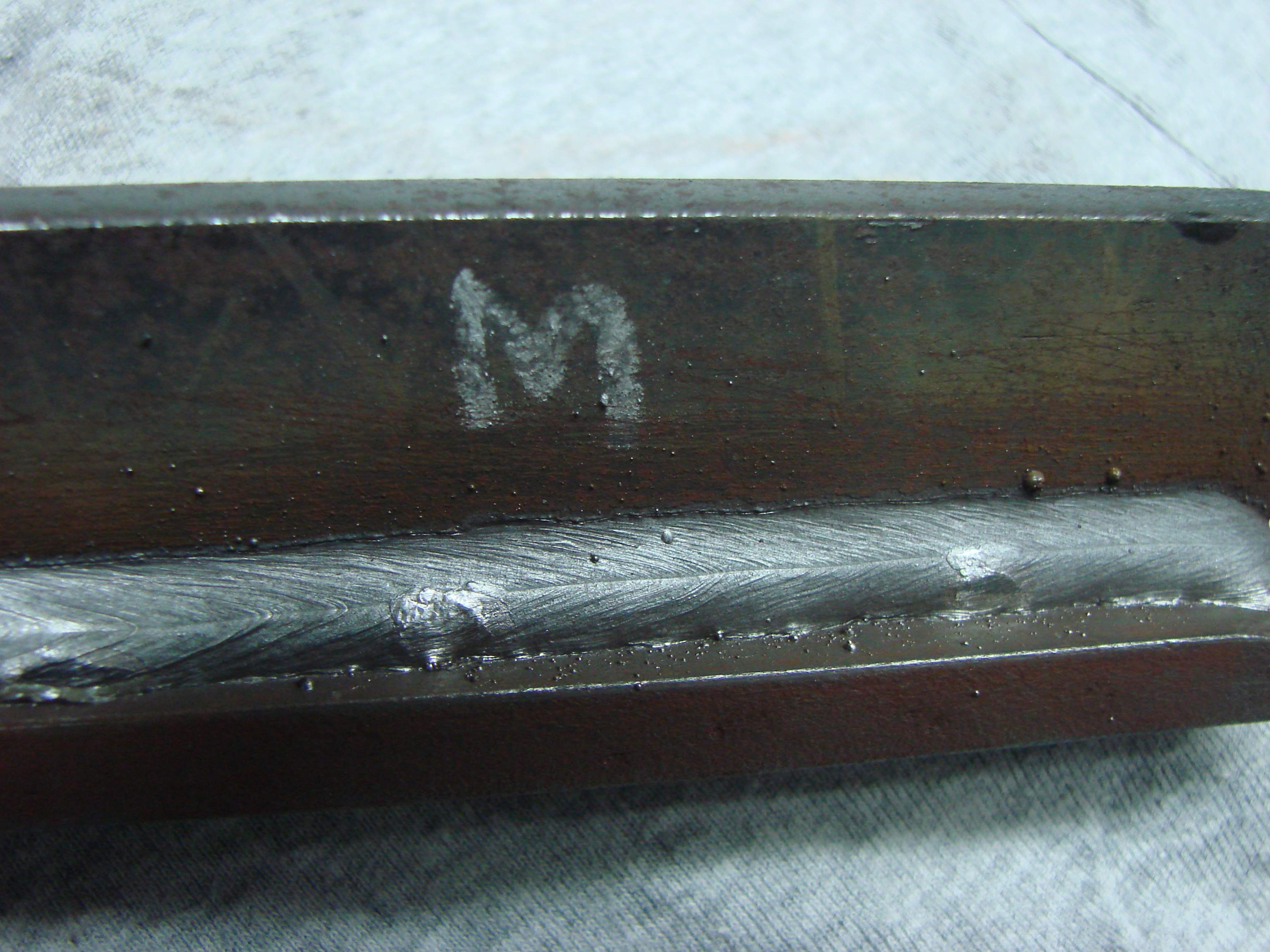

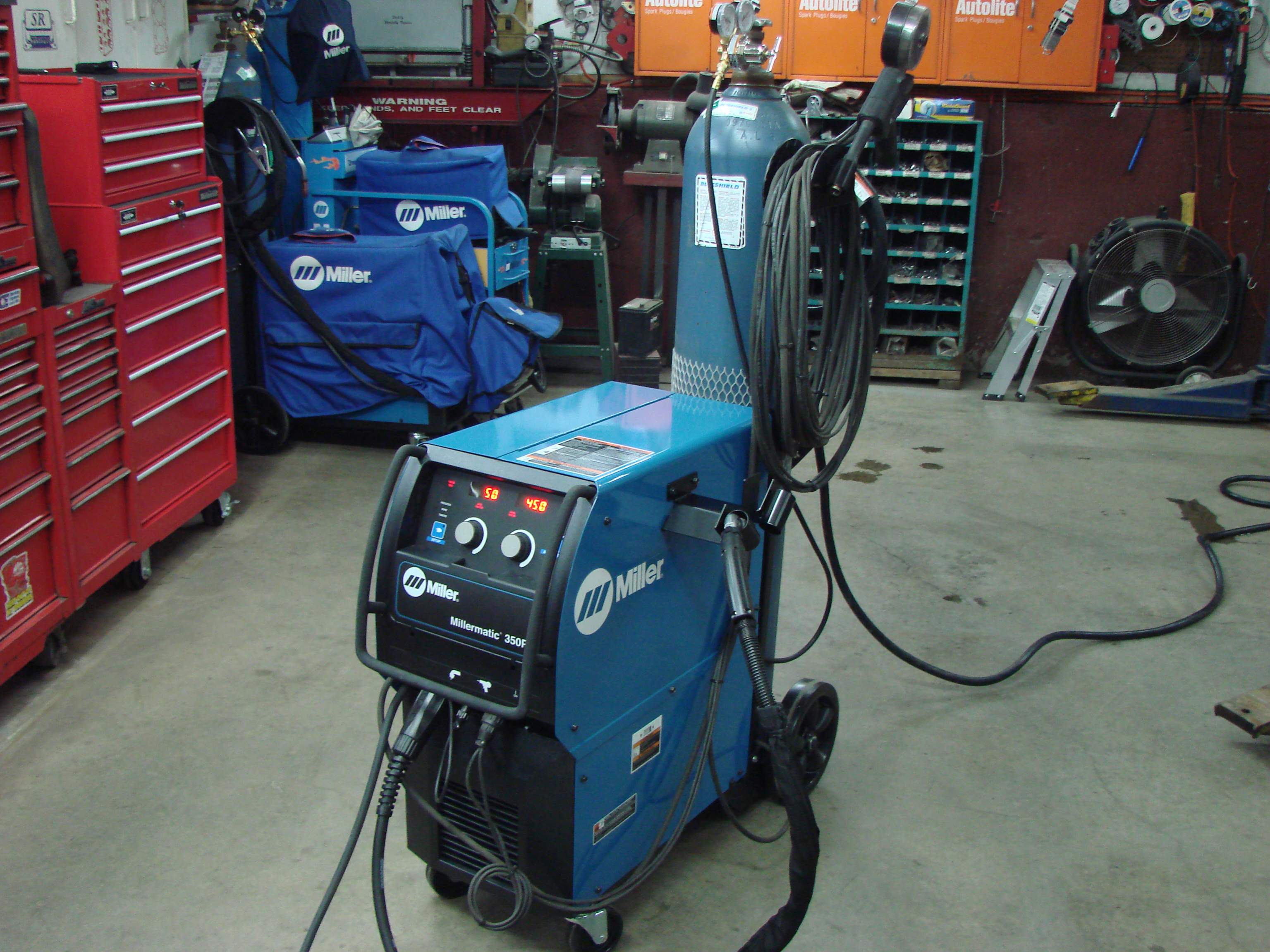

Tonight I got the opportunity to try out our new Millermatic 350P mig welder. In regular mig mode was great but holy smoke when I switched over to pulse mode the world changed and for the better.
In regular mig mode it's sounds like your typical bacon frying and does a great weld but when you switch over to pulse mode it sounds like a bee buzzing and man does it ever weld hot and fast in that mode. I'm thinking I'll be in pulse mode for a long time from now on :laughing:
Here's the first two welds I did with this machine. I was using 3/8 flat bar and .045 wire and 90-10 (Blueshield 6)
The sample marked "M" is mig mode and the "P" naturally is pulse. In time I'll get the welds even better. It does take a little time getting used to setting up the dials on the beast. The small marks on the weld is the small amount of scale from the gas and can be brushed off. You'll notice there's more splatter on the regular mig sample and less on the pulse one.

so give us a bit more info...
push/pull?
what lead angle?
simple draw a straight line? waggle back and forth? swirl pattern?

What you see here is the first five minutes I've spent on the machine. I'm using the standard Bernard gun that came with the machine. Tilted the gun sightly and went right down the center of the two pieces. I also have the Spoolamatic 30 amp aluminum gun attached to the machine as well.
The picture was taken with the camera about 3 inches away from the weld and it is a Sony DSC-H5 camera and has taken a little over 4000 images.

OK 4shorts, you made me have to do some research on this "pulse" mode. Looking at the pictures you posted, I like the mig mode bead better. Nice looking bead. The pulse mode looked a bit cold. While doing some reading on the Miller website, it appears that the pulse mode is for welding aluminum. They call it a spray transfer or low penetration, and is a cooler welding process for aluminum. Or at least that is how I read it. I would stick to the mig mode for steel. Other than that, I am jealous, that is a very nice rig! :thumbsup:

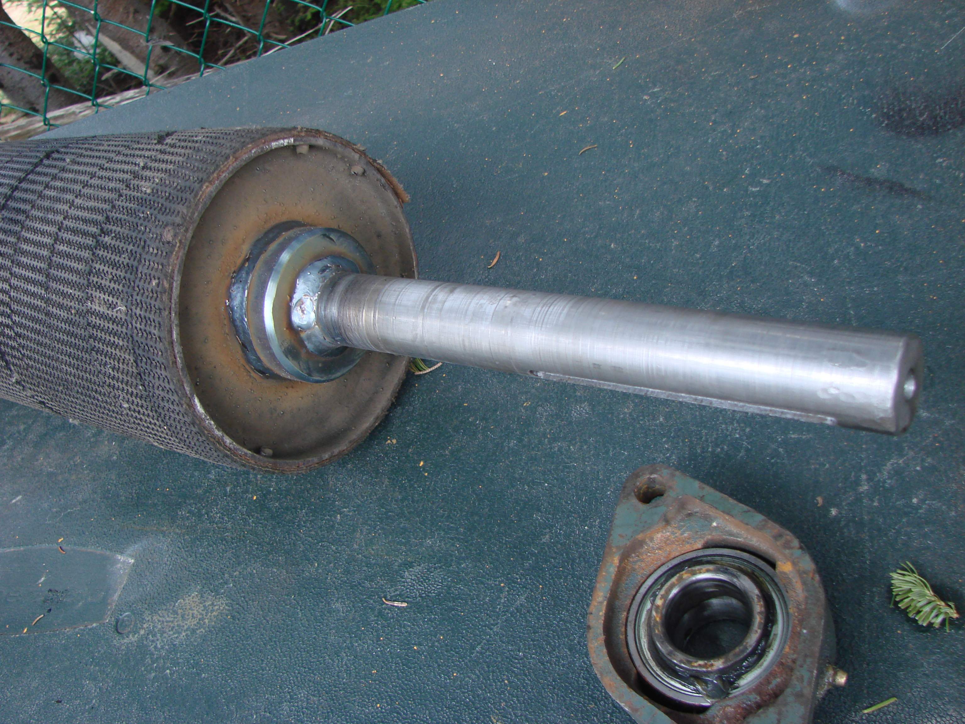

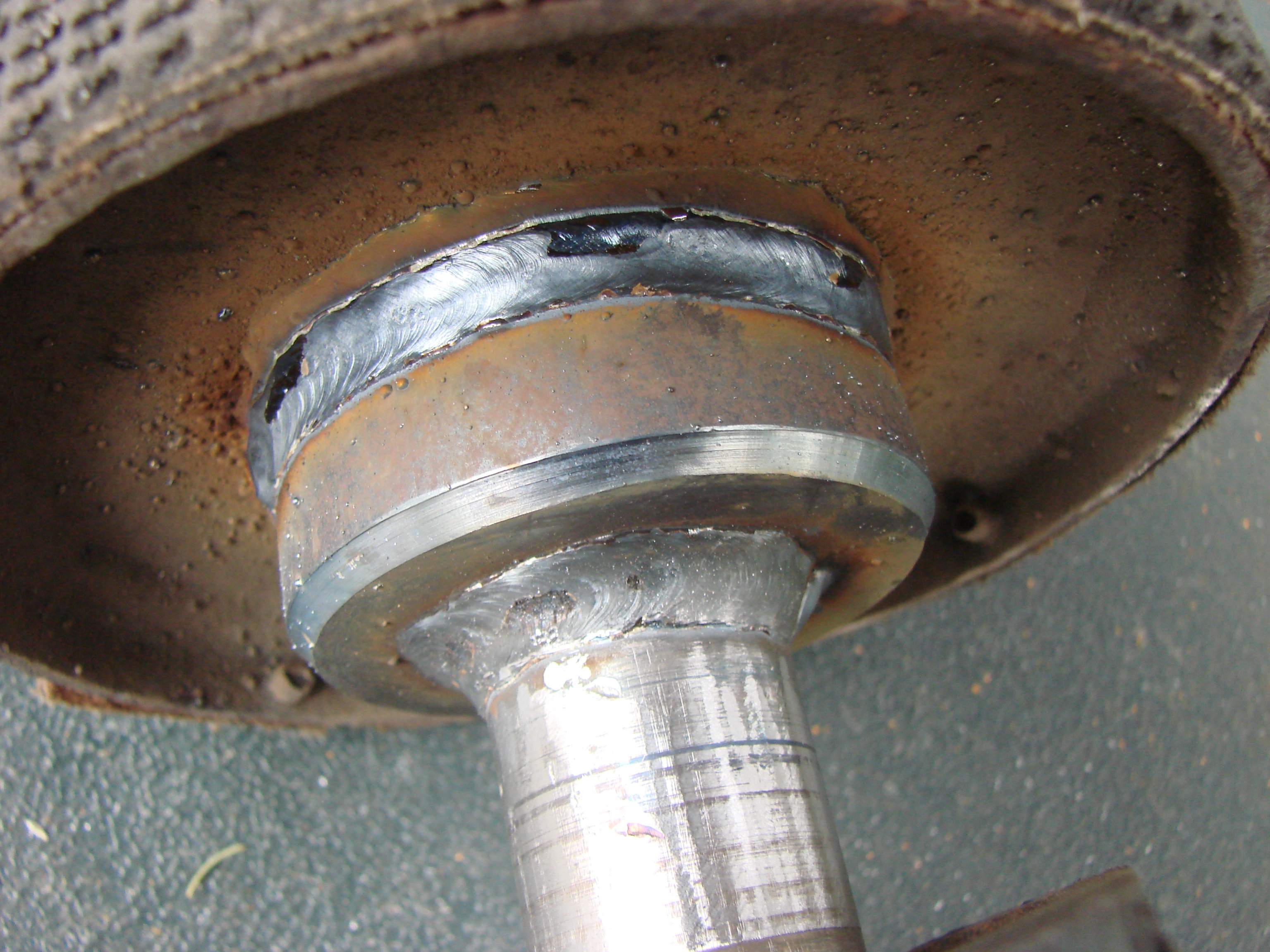

Miller is pushing the fact that it's great for aluminum and it is but if you get a chance to try it on steel go for it. You'll never go back to regular mig welding again. Using pulse on steel seems hotter and more penetration to me. Today I got called in to do some roller repair for a local company and used the pulse mode again and I'm hooked on It. Technically when I'm on pulse mode I should have 90-10 gas which I did in the above pics but I used that same gas to try it in mig mode and really I should have switched over to 75-25 but I was to lazy and used 90-10 on both modes.
The set up chart on the machine says it will weld up to 1/2" in one pass on pulse. Can't see that working IF it was a cold weld. Another advantage to pulse is less warpage which is another problem with all types of welding. Less warpage and less splatter.
The pictures attached here on this post is of the roller I just welded. don't pay much attention to the splatter on it because it was repaired before and I didn't clean up the side of it. I don't think you would consider that a cold weld and it was in pulse mode when i welded it.
If nothing else it makes good conversation ;) Thanks for your comments:thumbsup:

Nice welds on the head roller. I havent ran pulse but ive read good things. Any large production (300A+) welders ive ran were Mutiprocess with external wirefeeders but no pulse. (100% duty cycle in a heavy fab shop...it was then i discovered that i wasnt a welder... but a warper:D i guess there is such a thing as too much heat :D )
