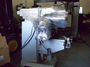

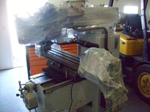

Ya the new mill didn't work out. The company said they want to do the right thing and get me the new one I asked for. They did email me photo's of the new mil as they received it and will email me as they add the options I requested. It has given me time to retool for the new mill. I have some cool projects in mind for this guy if I ever receive it. I attached the pics of the new mill for you to view. These pics are the bare machine without the options. How's the new bota?
