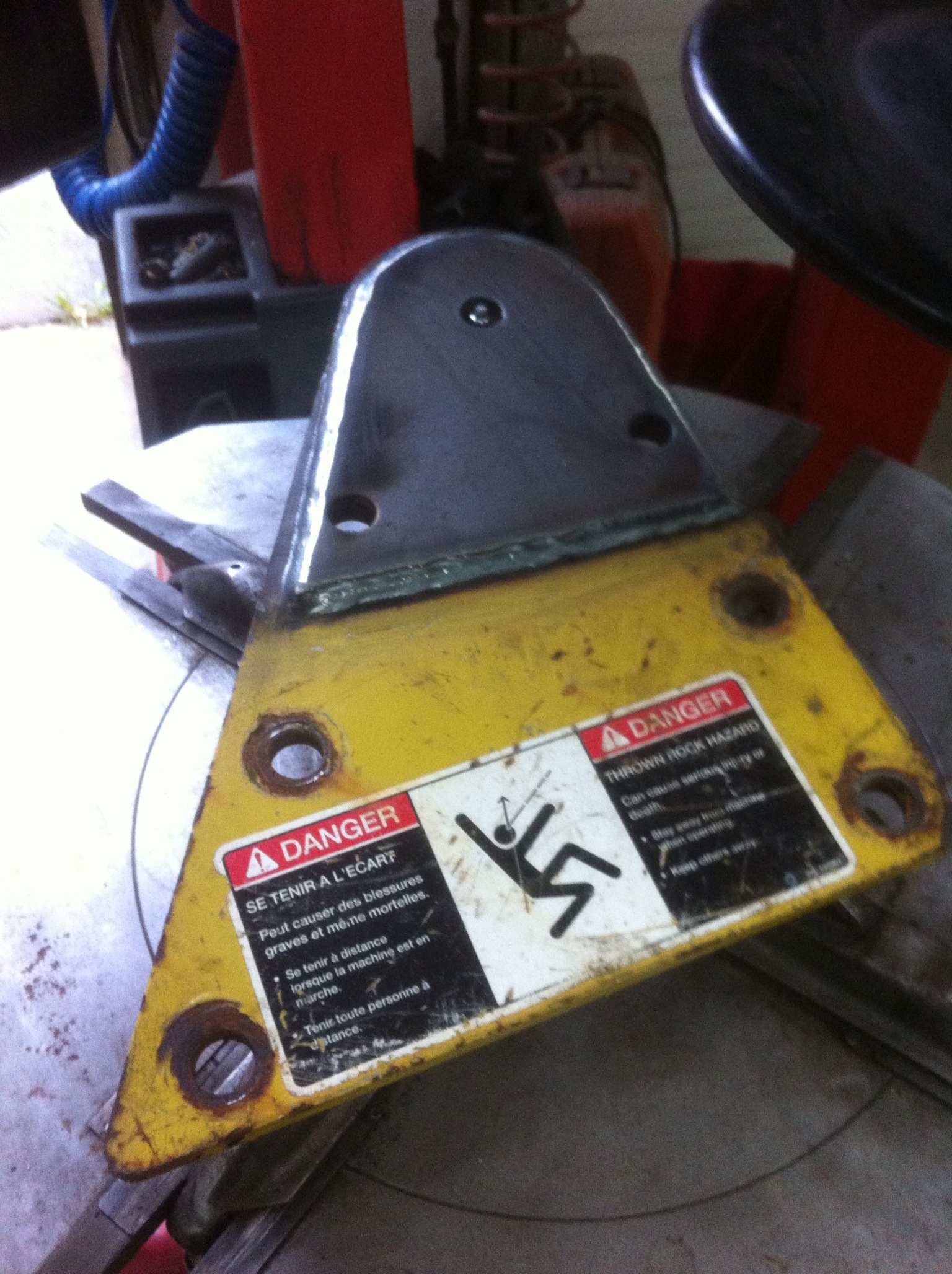

Thanks Jason. Ya it's all in the tooling. ;) here's a part I repaired off a rock picker yesterday and used the 350P.
I've had the 350P for close to three years now and never an issue. I've visited the repair fissility that repairs all the major brand welding units on the island and never seen a 350P there. All I can say is this one has been flawless. It's welded for eight hours straight at times in hot weather in the shop doing excavator buckets and performed flawlessly. I have the 30 amp Miller spool gun as well for it and its just great.
I will say that I do on occasion remove the tins and blow all the dust out of my welding equipment and been doing that for years. To date I've never experienced any down time with any piece of Miller equipment ( knock on wood)
