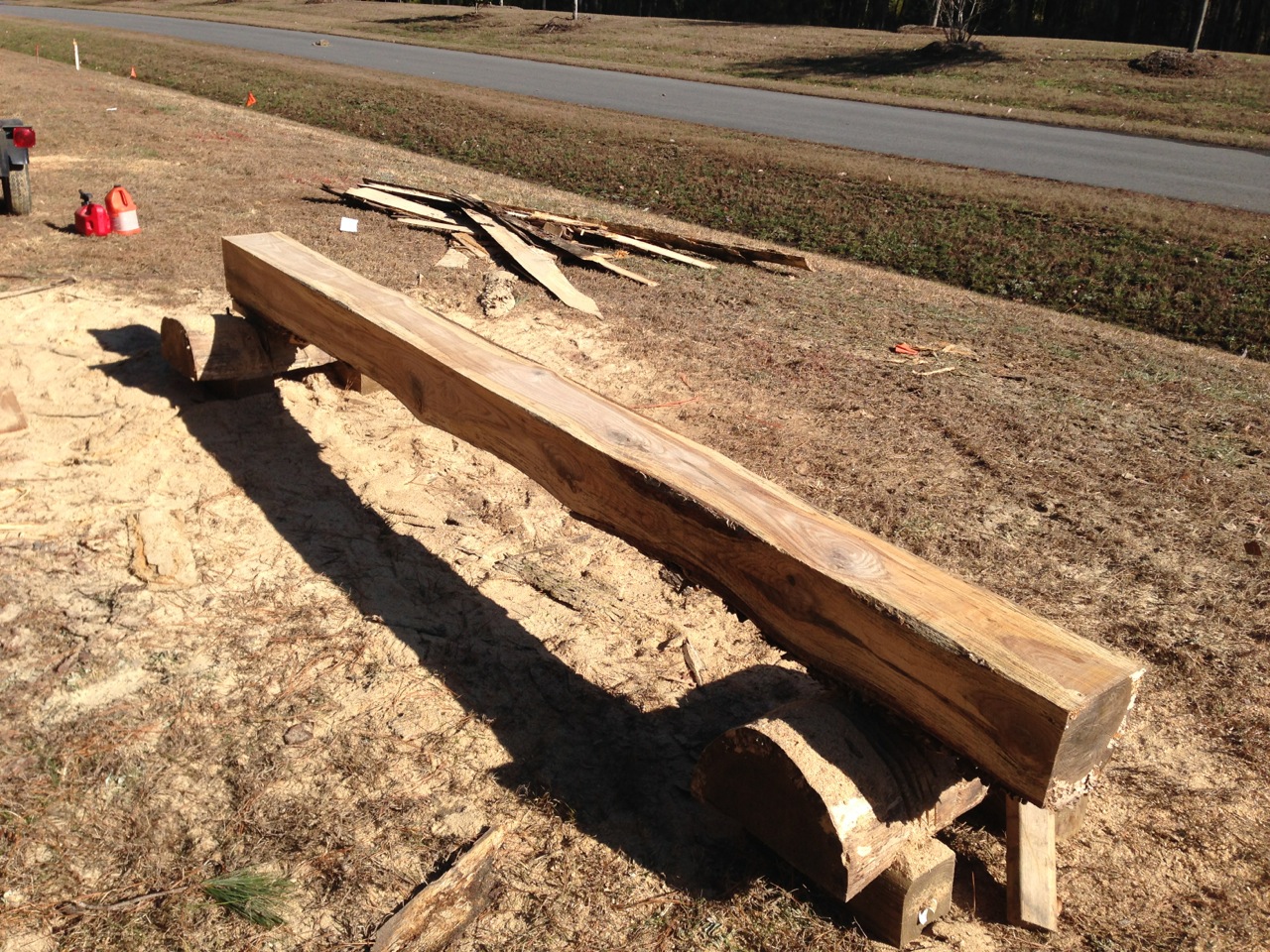

I finally had a chance to catch up on some milling this weekend, using my Stihl 461 and Granberg Alaskan rig (I have the mini mill to square up cants, and a slabber to cut boards). The logs were cut between 1-2 years ago, some after Hurricane Irene in 2011 and some while clearing our new property in 2012-2013. Here's what I dragged out from my stash:

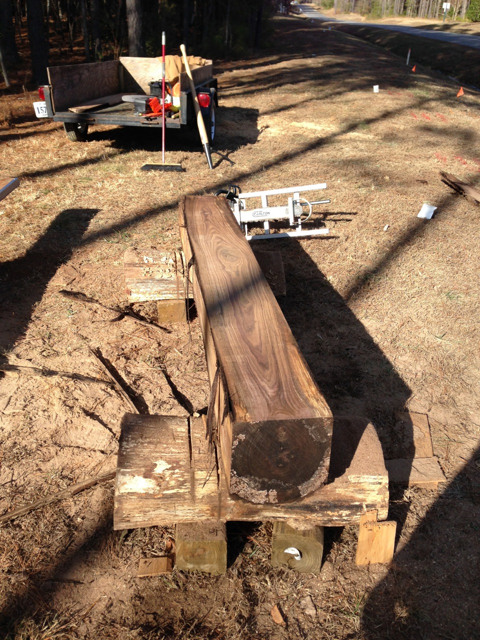

There was some poplar, walnut, oak, and pine. I ended up choosing one walnut log, one poplar, and one oak for lumber. The rest will be cut up for firewood. The walnut had a very distinct heartwood (chocolate brown) and sapwood (blond) when cut down in 2011, but over time the color evens out as the log sits. Mills will actually steam walnut logs to accelerate the coloring process, as it nets more of the desirable dark wood. Here's the squared up walnut cant:

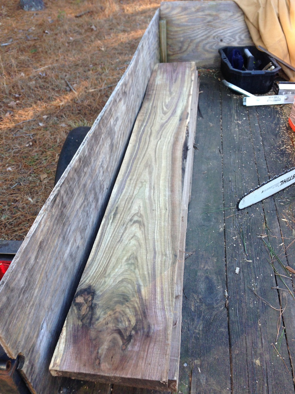

And here's some milled boards (5/4" thick):
Within minutes of cutting the wood changed color, going from green/brown to more of a pink/brown.

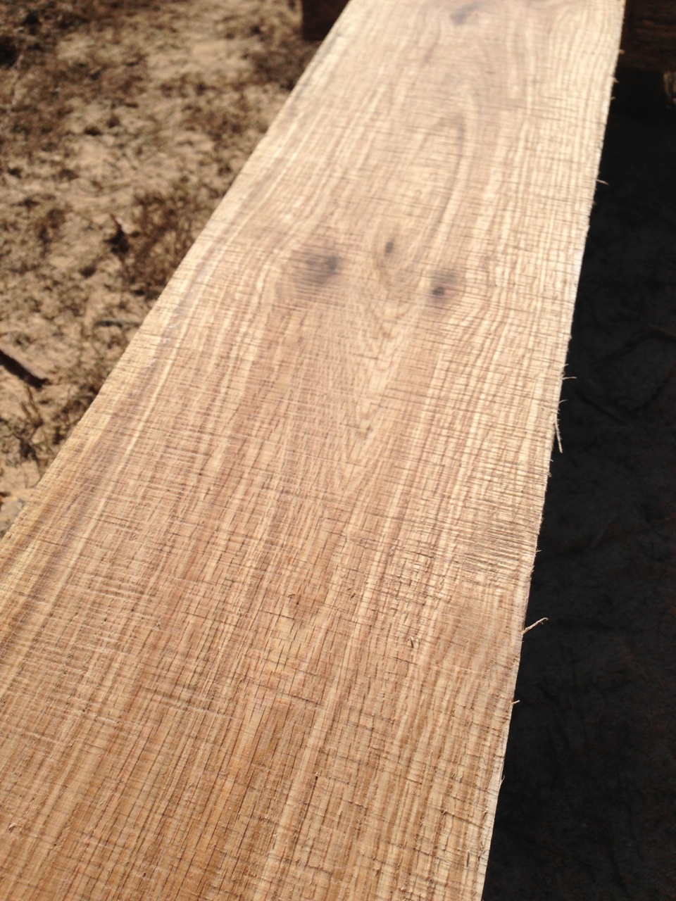

Next up was white oak:

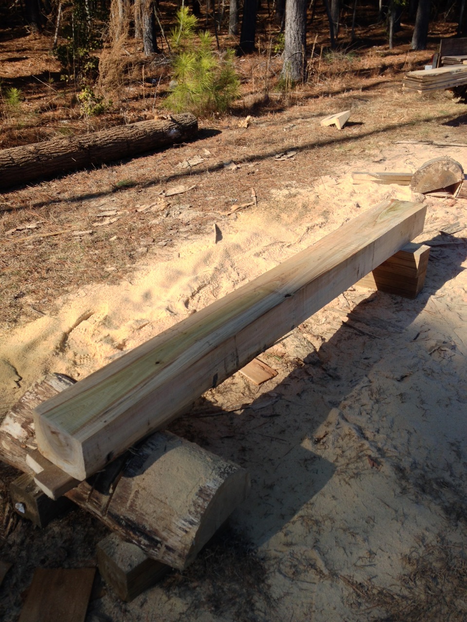

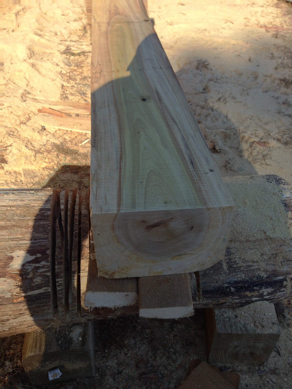

Then poplar:
