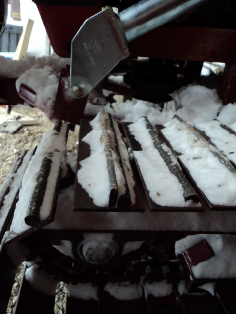

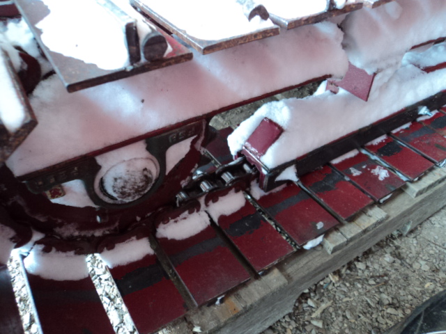

So far I have made a few additional improvements. First I modified the track slider. The flat plate worked OK but I seemed to throw the track every so often when the track got lose. Basically I welded sides onto the plate to create a C channel that I covered with the same slide plastic material. The C is only 3/8 inch or so wider than the chain so this help keep things lined up.
The second modification was to weld additional plates onto the track for traction. Right now I added a 3/4" x 1/4" plate to every other track plate to give me better snow traction. This addition really helped in the snow.

Hello All,
Here are a few updated photos. This first is showing the new and improved slider that the track rides in. The new design has sides to help keep everything lined up.
The second photo is showing the additional plate welded to every other track section. When the weather get warming I will mostlikely add the plates to the other sections.
I still have a few improvements to complete. The highest on my list is a direct drive. Where the hydraulic motors will directly turn the track. This will remove the additional chain drive. Hopefully this spring/summer.
