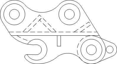

I am thinking about building a quick hitch for my NH EC35 and have some questions about design and machining. First the design, the thought is to create a hook on the front and just pin the back, will this be strong enough to handle the stress? It will be all half inch steel and the tubes will have 5/8" walls. Here is my design:
The next question is how to machine the tubes. I can't find the right size exactly, but I do have a lathe that should be fine for the job. I found new stock that will need 1/8" removed from the inside diameter for $65 and solid 3" bar for $12. Would it make sense to bore the 1-5/8" hole for the pins? Or would that just take forever? Here is the lathe I have - http://www.grizzly.com/products/12-x-39-Large-Combo-Lathe-Mill/G4791.

Joe, I certainly don't want to tell you not to build this, but, it may be cheaper and easier to buy one. The r&d has already been done by the manufacturer and everything will fit up correctly and won't bend or break. Do a search in Google for "mini excavator couplers" or for "mini excavator attachments" there are tons of aftermarket companies that make couplers for that size machine that are very reasonably priced.

Tags might be right, however quick couplers for small hoes are difficult to find. Your design looks very similar to my larger excavator couplers though. I had one custom build by a company called AIM for an unusual applilcation. They were very helpful and it fit perfect and worked perfect. Mine was hydraulic though. You flip a switch in the cab to latch and unlatch it.

I think I do feel more comfortable about the design though. The one listed above seems far lighter than what I have planned, so I won't worry about that any more. I am going to make a foam model of it this weekend. I will use it to fine tune the design before I commit it to steel. I will take pictures of the model and post them here.

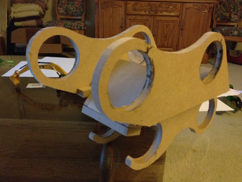

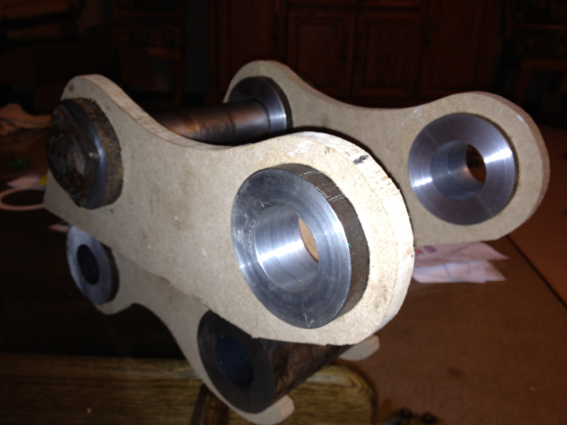

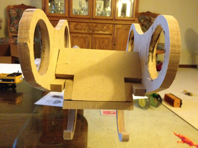

Well, I built the model - I think it will work well. I did learn that all 3 of my buckets are slightly different sizes though. Luckily the one I started with had the pins the closest together, so the others should fit, just a little looser. I didn't make the pin sleeves yet and those will go into the model before I start assembling the real deal to make sure nothing binds, but I feel like things are coming together.

Got a bunch done today. Machined the top set of sleeves and got the bottom 2 cut to 1/8" over. Now I have a problem - I don't know how to hold the bottom sleeves to bore them to the right diameter. I put them in the chuck, but they wobbled too much for me to feel comfortable cutting on them. Any suggestions? Here is the latest pic.
I don't understand what you are asking? Perhaps a photo of how you tried to chuck it, so we can figure why it would wobble. A piece of round stock should just go directly into the chuck and then use a boring bar, twist drill, or reamer.

Others have talked about Drawn On Mandrel tubing (DOM) for bushings. I've looked at online suppliers and they have various wall thicknesses and varying ID tolerances.
Have a few projects myself and think this is a better option than turning my own bushings.

Can you tack weld them to a jig temporarily for machining and then just grind off the welds when done?

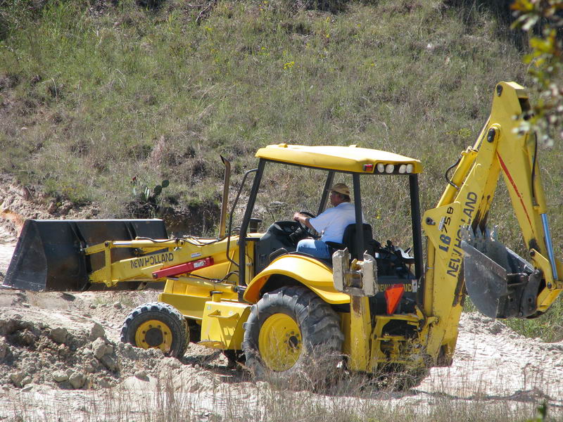

I have a quick hitch on my TLB backhoe bucket (photo). While I've noticed no degradation in strength, it does extend the length of the bucket so that it now hits the bottom of the boom if I'm not careful. Most of the damage to the boom was done by the previous owner. I try to curl the bucket and bring in the dipper slowly until it makes contact with the boom. My quick hitch is a bit loose and and does add some slopiness to the bucket. If your bushings are nice and tight, that might not be a problem.

That's a great idea, but I will have to file it away for next time as I found a machine shop that was willing to machine them for a case of beer.
Not much else has been done since as other projects got in the way. Maybe I will have some time this weekend to finish drilling the 3" holes in the .5" plate. Those take for ever with a hole saw, maybe I should crank up the drill speed some. I dread the 1" piece that I need to drill.
