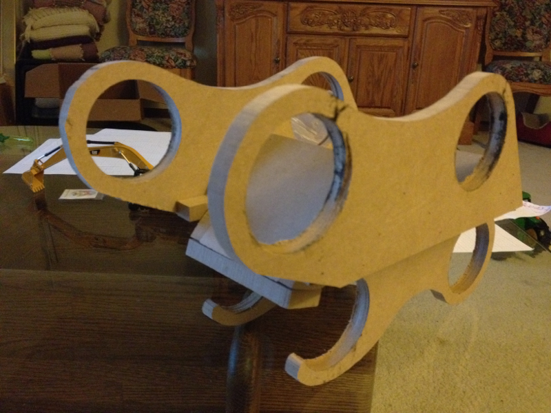

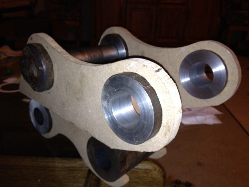

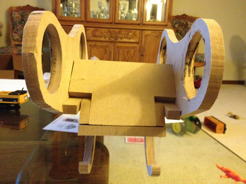

Well, I built the model - I think it will work well. I did learn that all 3 of my buckets are slightly different sizes though. Luckily the one I started with had the pins the closest together, so the others should fit, just a little looser. I didn't make the pin sleeves yet and those will go into the model before I start assembling the real deal to make sure nothing binds, but I feel like things are coming together.

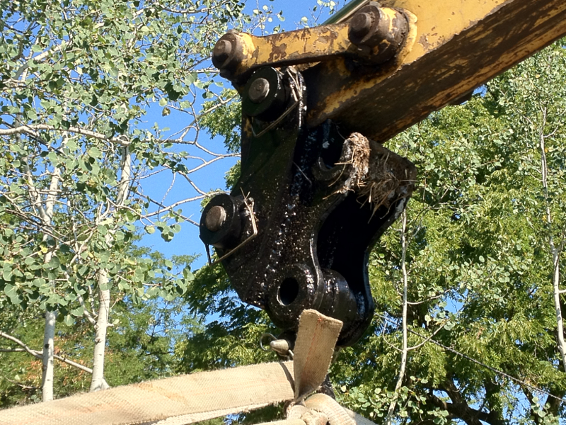

Got a bunch done today. Machined the top set of sleeves and got the bottom 2 cut to 1/8" over. Now I have a problem - I don't know how to hold the bottom sleeves to bore them to the right diameter. I put them in the chuck, but they wobbled too much for me to feel comfortable cutting on them. Any suggestions? Here is the latest pic.

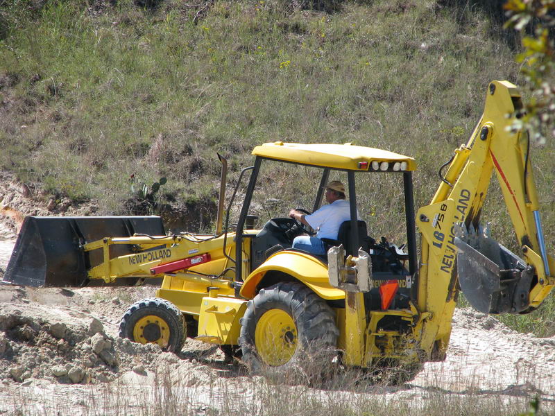

I have a quick hitch on my TLB backhoe bucket (photo). While I've noticed no degradation in strength, it does extend the length of the bucket so that it now hits the bottom of the boom if I'm not careful. Most of the damage to the boom was done by the previous owner. I try to curl the bucket and bring in the dipper slowly until it makes contact with the boom. My quick hitch is a bit loose and and does add some slopiness to the bucket. If your bushings are nice and tight, that might not be a problem.

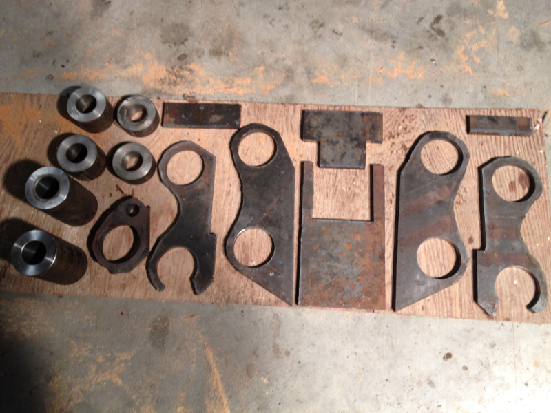

Well, I finally got all the parts cut out. Now the grinding begins. I will have a bunch to do since they were cut freehand for the most part.
   / Mini Ex Quick Attach Build #20
Wow, wish my freehand cutting was that good! Is this modeled after the JD or Cat in your picture? :)
