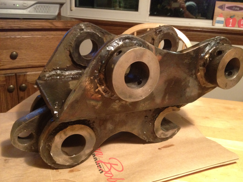

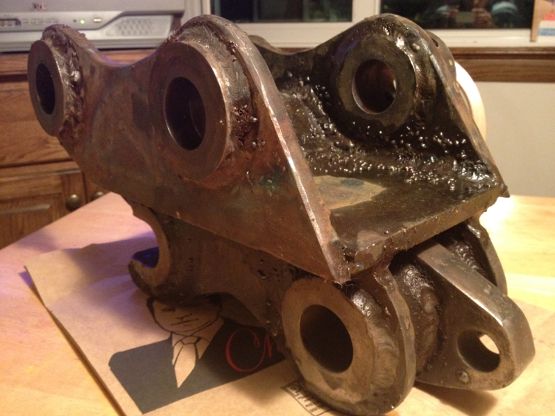

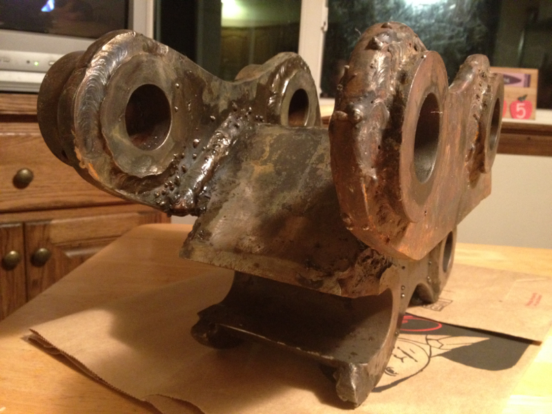

Well, it has been a long time since the last post, but I have made some progress. All the welding is done. More grinding and probably some sand blasting - then paint!!! Here are some pictures.

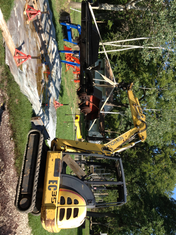

Well, I don't have any pins yet, but here is a pic of the hitch - the paint got scratched and there is some mud on it, but that is bound to happen. I also posted a pic of the first real lift - I am repainting my trailer and wanted to spin it around. That was close to the limit of what the mini can lift, so that felt good.
