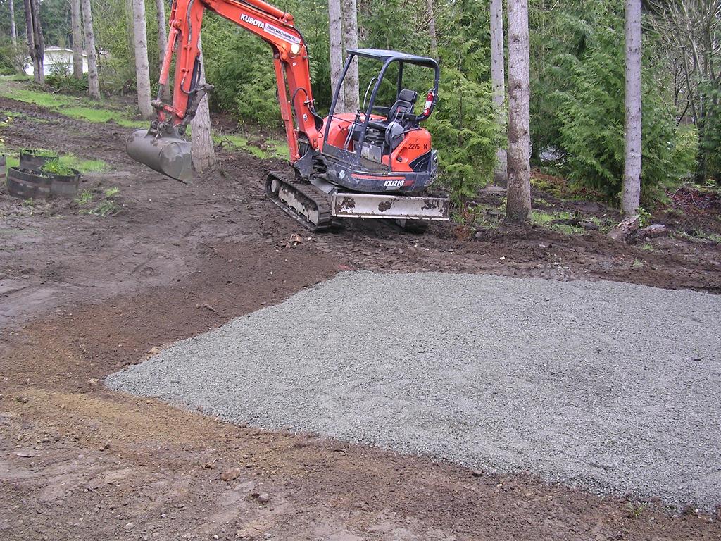

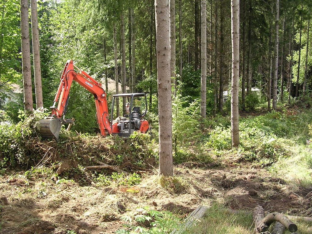

I have a Takeuchi 135, previous to that I had a Takeuchi 025, previous to that I rented for 2 years. Kubota 121, 91, Bobcat 125? and a few others.
I bought my Tak with rubber tracks. After tearing a rubber track at 1200 hours, I bought a used set of steel tracks. Much better for durability, but hard riding and when they come off, they come off. Rubber is easy to maintain, but if you're in ledge, sharp rocks or stumps, steel will last better. Rubber is 1/2 the price to replace, though.
Make sure you get a thumb. No point in even having a small machine w/o one.
I had a quick coupler added, built a scarifier bucket, a HD digging bucket, a hydro tilt clean-up bucket and a ripper tooth to it. For finish work and bailing material, the hydro tilt 3' clean-up bucket is king. I use that more than anything else. The scarifier bucket is next. Can be used for regular digging, but with a little shake, rocks can be sorted.
My machine will travel on any slope, but I've been in and around excavators for 20+ years. I take it into places where I need the boom to pull myself up/down. Once you get comfortable, you'll find that it will go places most machines will never go. The boom makes for a handy way to climb around steep areas.
Good luck, try several machines and see what fits your needs. Here's a couple pics.
