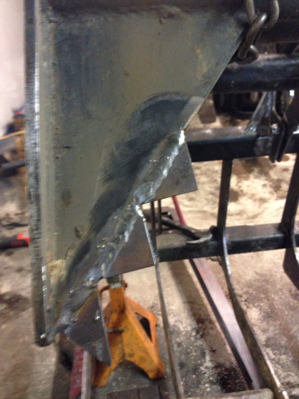

I added these teeth which are 1/4 steel welded to 3/8 steel. The bottom ones drag the concrete when you are closing it. They have been bent back at 45%. My mig weld held and I am not a pro welder. I am not arguing that a stick penetrates better. I think if I welded two pieces with my mig and the other one with 7018 the mig would be stronger because I am a way better mig welder than a stick. The big advantage to my stick is it handles oil, rust, and paint better. I also have 100 foot leads and I can weld in the parking lot without dragging the mig around the shop.
/ Mini gantry crane #72
I've said that before, that a rookie with a MIG may produce a stronger weld than birdpoop with a stick. The stick penetrating more here and there may not help much. And the MIG is better looking. Incidentally those are FINE welds. If those are welded both sides there is no way they will break off, ever.

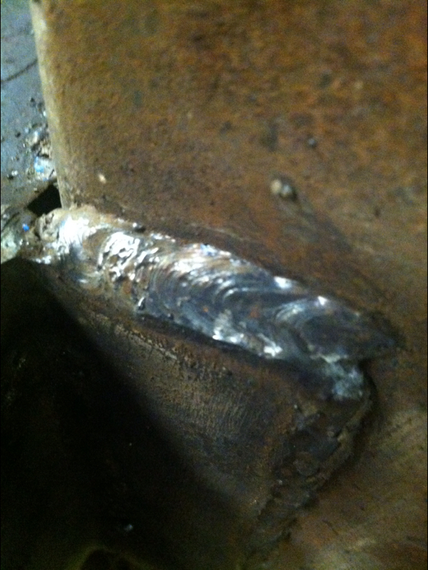

Yes, they are welded both sides. I'm not a bird poop stick welder, but I can still do better with a mig. I agree that a half way decent mig weld is stronger than a bird crap stick weld. Here is what my stick welds look like.

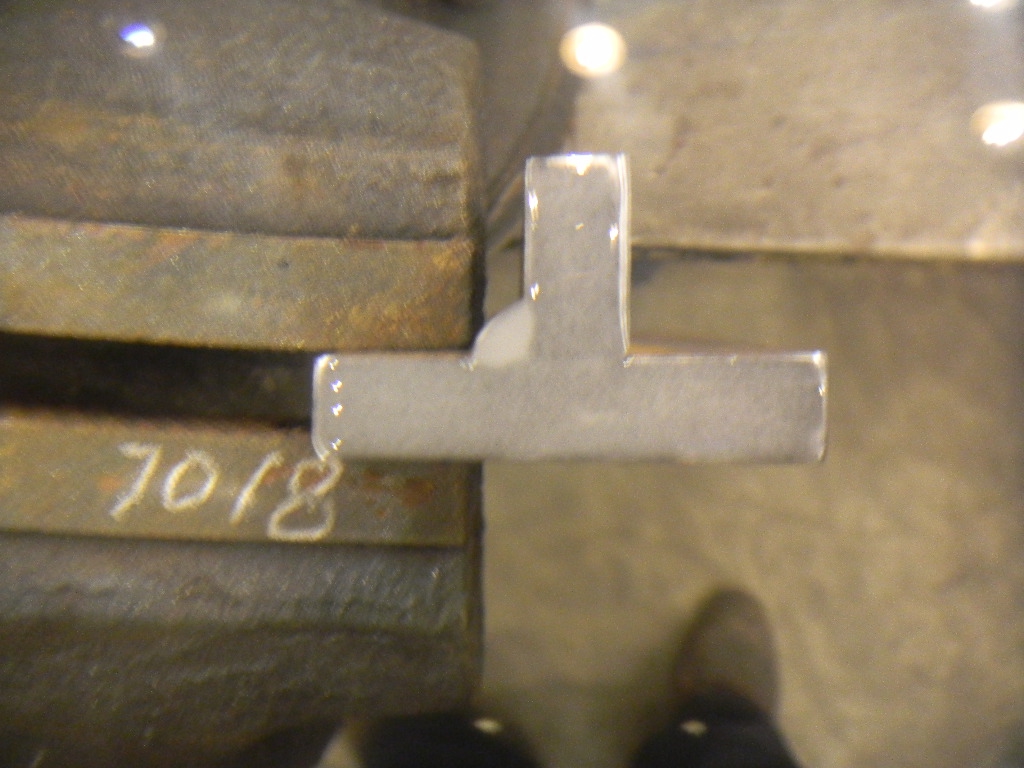

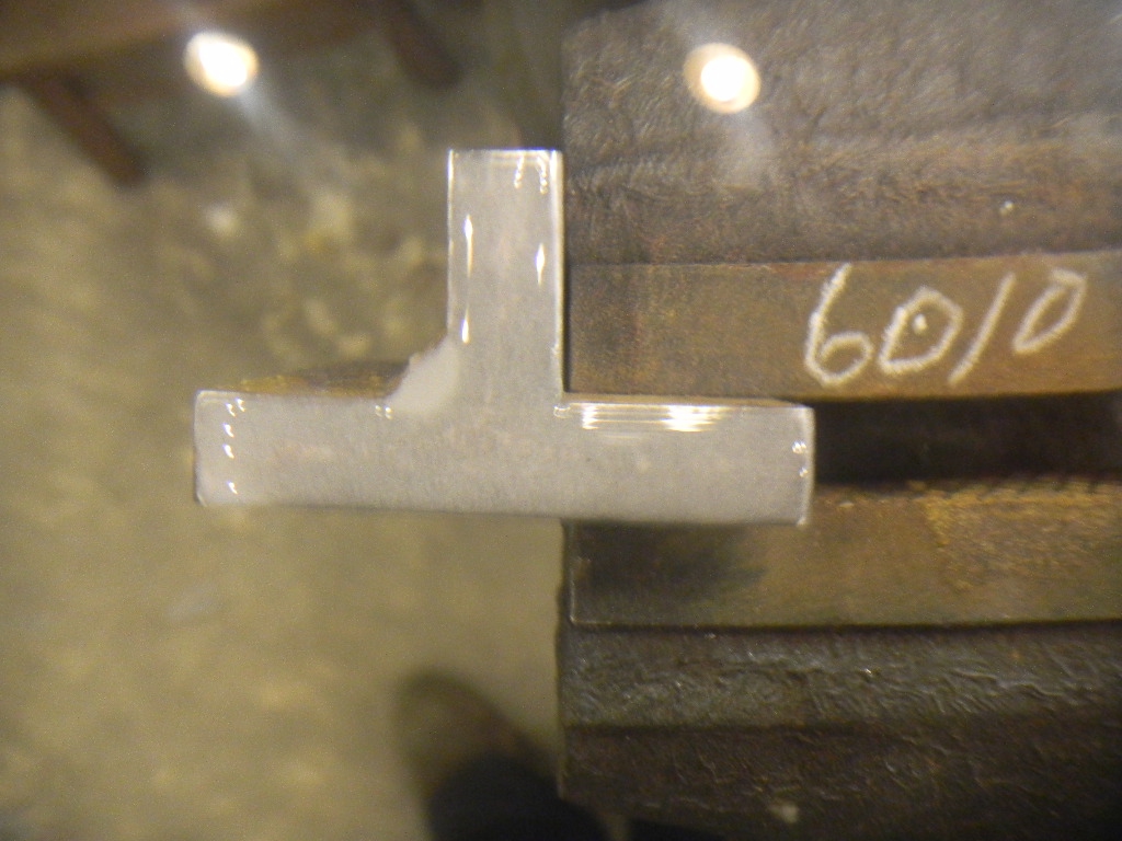

I worked heavy civil / marine construction all my life. In the early 1980s Lincoln came out with the LN-22 wire feeders, then later the LN-25 wire feeders. I ran an LN-22 in Alaska in 90-MPH wind. I went for years never seeing a stick electrode on a job site. Wire feeders were / are a game changer in construction.
Here's some pictures of penetration!
