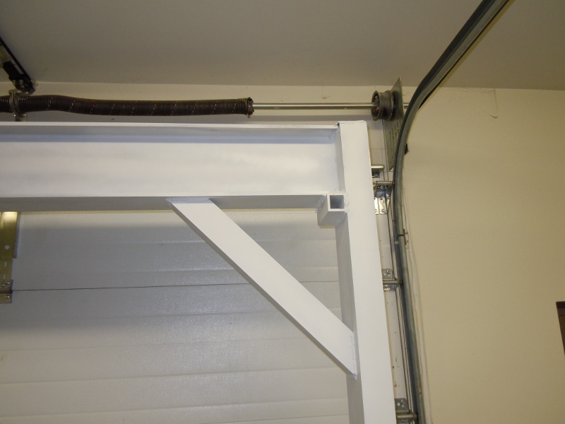

I thought I'd show my latest completed project- don't get many-. I have a 10x10 beam down the center of my building (colored gray in upper part of picture) I wanted to be able to move my MMM and snowblower and other things in and out of the garage door. Tractor takes it the rest of the way. Because of limited height, I needed to be able to move it out of the way of the door (L39 is tall). I used 4 trolleys, two 2 ton to ride on the steel beam and two 1 ton to carry the hoist on the 6x10 inch beam. All the white is aluminum so I could move it easier. The red dolly connector is steel. I took the ratchet out of the electrical cord spring-driven coilers so they take up the tension continuously.
Rating: the winch is rated at 880 lb. My things to move are less than 700lbs. I was going to run a deflection test with a 2300 lb ironworker, but I thought why risk breaking things if I'm never going to lift that much. I followed the recent bridge crane thread and I know there is a safety limit risk.

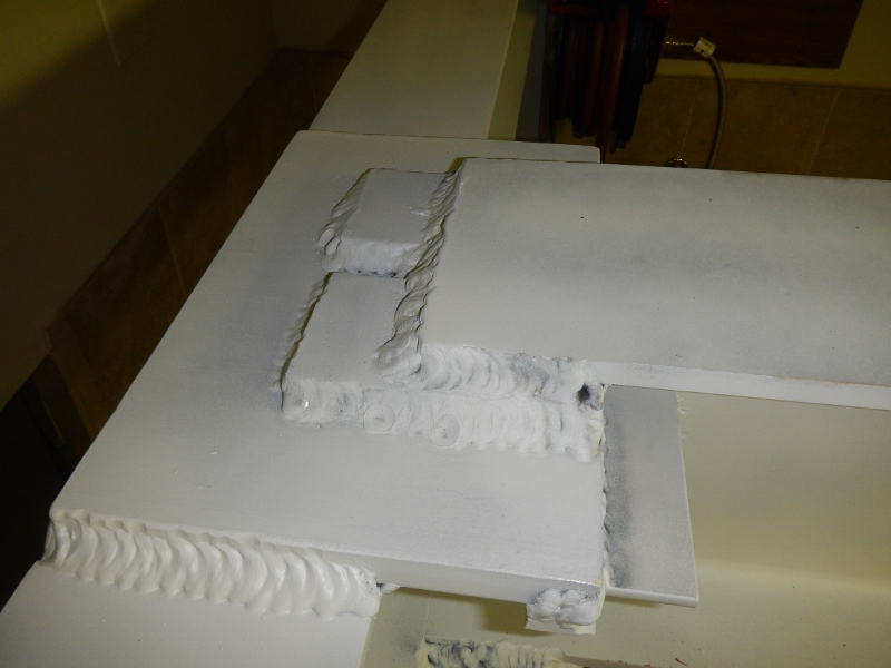

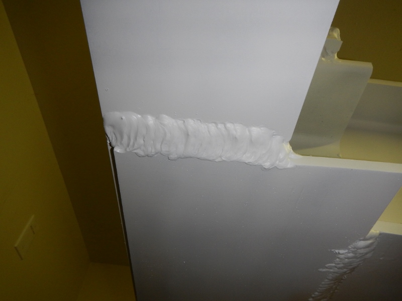

I designed it to rely on shear strength of 1" AL plate for the tee joint. The welds are respectable on top and bottom but the picture shows the tight quarters. I sound defensive, don't I. I've follow all the welding discussions on this forum. The L bracket is just to plug the pull strain on the tee joint. If it flexed too much, I'll add a 45 degree brace on each side. So far so good.

A lot of those welds look really cold too. What process did you use on the aluminum?

The floor is concrete stained with a few years of clumsiness. The aluminum was welded with a new Lincoln Power Wave C300 set at MIG with 3/64 wire set on pulsed mig. It would go to 300 amps but heat controlled by wire speed . The machine was more difficult to master than I had expected. And I haven't. And the push pull gun was a mistake for me to buy. The 25 ft length just pinched the wire when I was 10ft from my machine. Live and learn. The horizontal welds at my welding bench were better. I take a picture today of the better welds.

The welds do concern me. But I'll try not to be too critical.
Potential weak spots I see are
1. Welds
2. How you attached aluminum beam to red trolley
3. The legs. With a 800# load I bet they will flex alot when moving. Or are those just ment to.move the EMPTY hoist out of the way? What size and wall thickness are those legs.
4. Adding to 3, the casters. Any resistance in them muts more side load on the legs. Those look pretty small in diameter. Ever try to run a caster over a small piece of gravel?

Yeah man thats a cool idea, but those welds look suspect.

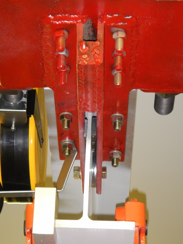

Thanks for the interest and comments. The gantry moves left and right. To the right, it clears the door. To the left, further..25 total. My K. L39 is inside and the 10" beam clears the top of the roof but the trolleys don't. Your comments made me concerned to do a test. I tried to pick up my L39 to the limit of the electric hoist. I measured the height before and during the lift with a lift scale and a laser distance measurer. The lift maxed at 1000lb ( hydraulic scale accuracy ?? 0-5000lb). The center of the tee dropped 1/32" and the legs, on the casters, spread 1/8". seems ok.
Material used:
The legs are 3"x6"x1/4". 45s are 3x3x1/4". The H beam base of the tee is 10"x 6 and the cross is 8"x5?
The top and bottom welds were done at a bench. Better than the in place vertical welds.
The AL and steel(red) at jointed by 4 vertical grade 8 bolts 1/2 " and one web bolt.
The left right movement with load will need a freshly swept floor near the wheels and a decision based on what I'm trying to move. I thought I could temporarily brace the legs near the wheels together rigidly if it's heavy like my metal lathe

Not to mention welding aluminum anneals it and it needs to be re-heat treated to achieve it's tempered strength.
I can certainly appreciate the intentions of this project, but I would've bolted the T connection and used steel brackets on the corners for the legs and uprights. Aluminum is much easier to bend and set, where steel will flex and more readily return to it's original shape.

LD1, In the simple load test, the winch was about 2ft from the door end. There may have been some compression in the rubber covered casters. Cast iron centers. What I don't know is how much force to rip the flange off of the top of the web. That would be a probable failure mode for the main beam. The grade 8 bolts won't be the weak point. There will be a interesting dynamic of the gantry on rollers and a heavy load that I push when suspended. The load will pull the gantry. But if I lift something heavy only fractions off the floor, it should minimize risk.
/ Mini gantry crane #14

Jim, Thanks for your feedback. No, the white end.- Aluminum is the weak link. Your comments lead me to think about adding a 1/2" steel plate under the tee joint bolted thru both members on 3 sides. That would leave the top of the legs as the weakest joints. I'm seriously considering thsee additions. Thanks. Rob

As a pro welder I wouldn't work under it should have used bolted connections. You might consider retro fitting some bolted bracket on each of your aluminum joints.
