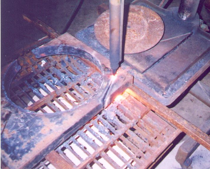

David I had posted some a month or two ago in the Photo's section called my winter work. Im burning a 2 inch plate out. I burnt a 13 inch circle out of one to make a bearing eat and then I cut a wedge off one corner to go into a frame straightener.Its quirky to use some times as the patterns ahve to be 1/8 th of an inch smaller on each side or larger dependin on inside and out side cuts. I make wire patterns and the tracer wheel follows it. I cut some 4 inch a few weeks ago. I also use it to cut alternator slide brackets and such.
/ Mini Hoe Project #32
Heres that Pattern torch. Its an older Linde unit but still works good. Its gt a 10 inch thick capaicty and a 40 inch linear travel.

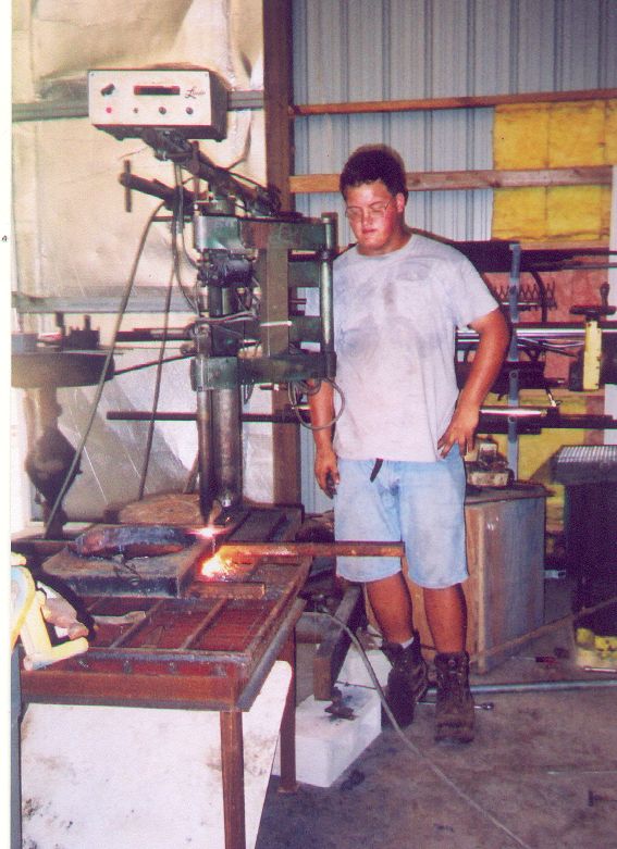

These pics show it cutting the 2 inch plates, remeber dont look at the ugly mug running it lol.

David look under the right lower corner of the control box. It has 2 arms sticking out to hold a pattern. for the wedge it was an angle iron straight edge. Look on the machines Cast iron table and youll see the pattern to the circle I cut out. I usually use 1/4 and 5/16ths wire for my patterns. ive got a few rolls of film here with a set of better views of the machines mechanisms. Its just one toy in an out of control hobby.

It really is. I do alot of things that require to or three things made like bucket fork hooks, buckets sides backhoe thumbs and grapples. It took 5 hours to layout with a template freehand cut and die grind a set of three bucket fork hooks and the end caps now it takes 35 minutes to put a plate in and cut a set out. the thickest ive cut is 5 inches. Half the capacity. Im building one similar that has a stationary torch with a otating workpiece for cutting out roller drum caps.
If I can find the manual Ill scan some of the pics.
