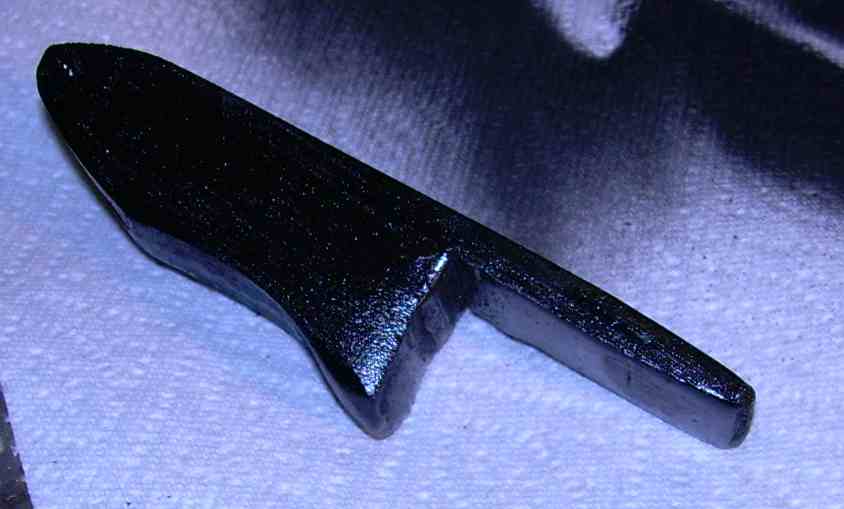

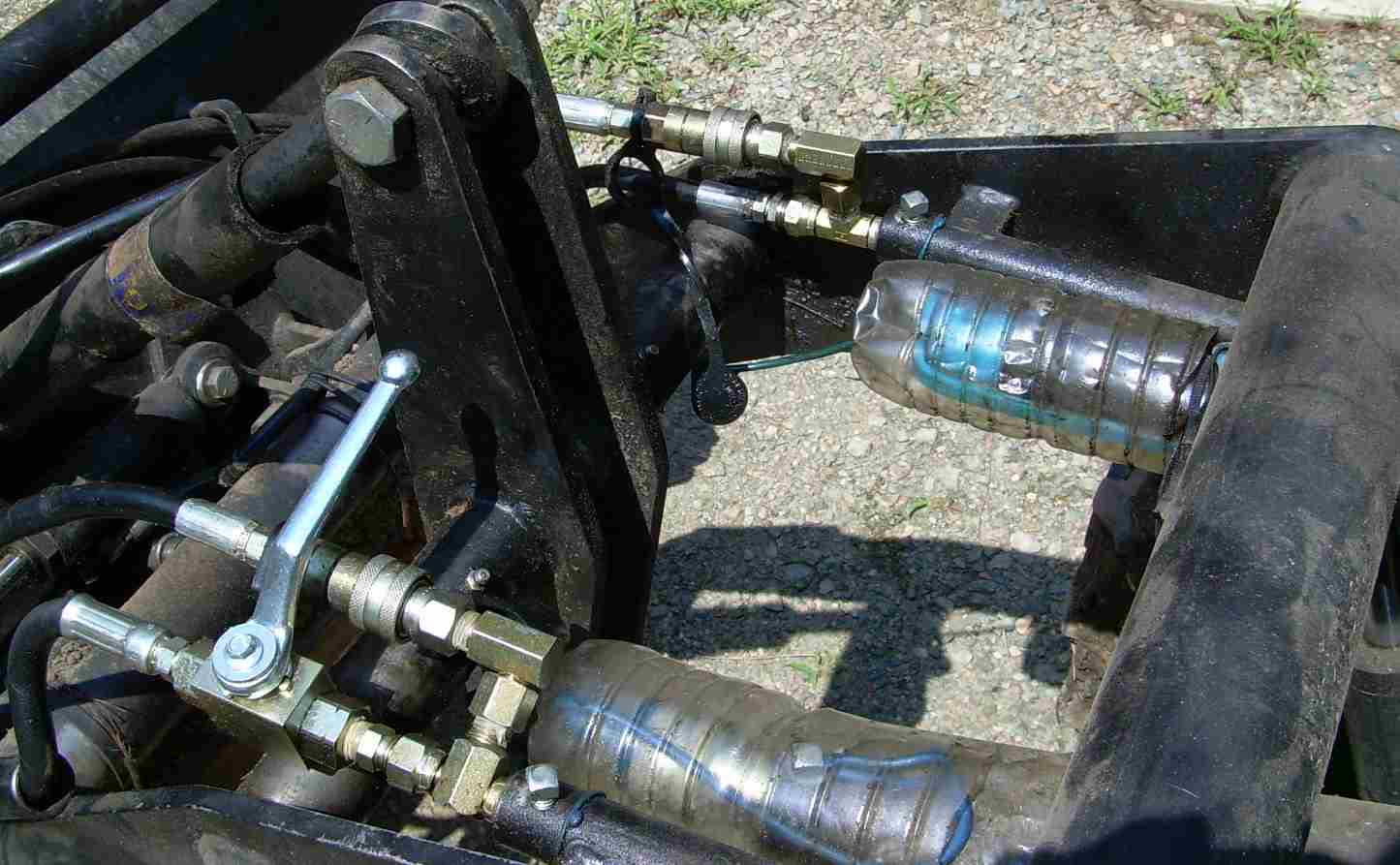

Things being a little slow, I will ask another question. What small and simple modification have you made that has made a big difference in your satisfaction with your PT. For me it was the auxiliary hydraulic modification. Or was it the parking brake improvement. I actually use the brake now. Bot have added a lot of value.

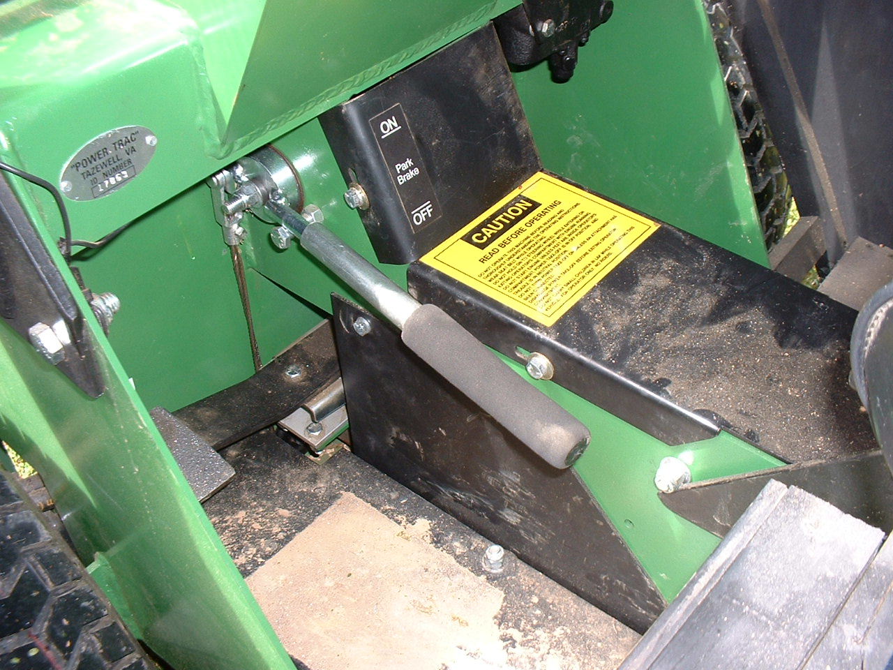

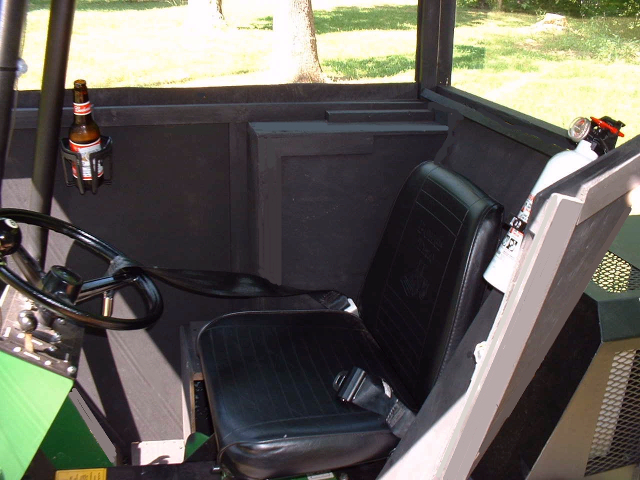

As simple as it was, my parking break mod for sure. I now use mine with ease, so I now use it more. My light modification to brighter halogens, placed at the top of the ROP’s angled down ward. Another one is my cab. I leave it on year round now. I just take out the foot panels and windows for extra ventilation and yes it is ugly, but so useful. It has been great for all sorts of things. Arm rest, cup holder, key holder, place to mount many things including my Walkie Talkie for talking to the wife inside. When’s dinner? Come out here for a minute, and so on.
Several times I had been in the middle of a project, and a thunder storm would come out of nowhere. Was nice to have the option of staying out there, and staying dry, not to mention in the dead of winter with panels and windows back on nice and warm. My little attachment collection is starting to take shape, and is adding greatly to the PT’s capabilities. I have plans to add many more. When I first got it the wife asked why would you need that thing? Now that’s changed to, can you take the PT and do this for me.
