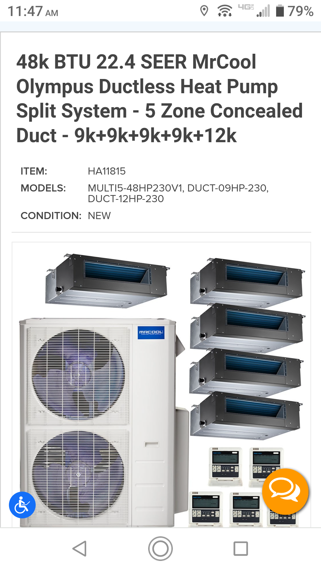

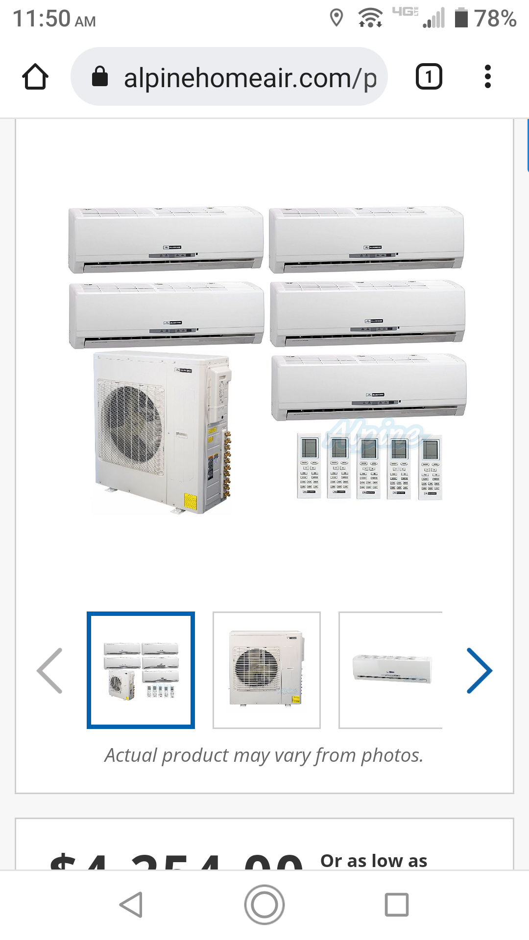

What does a "ducted mini-split" system look like? I'm just asking as I've not heard the term previously.
In other words, what is the difference between a conventional HVAC ducted system and a mini-split ducted system?
/ Mini split questions? #30
I believe it only means indoor components like the evaporator is concealed in the wall or ceiling vs hanging on the wall, on a convetional ducted system the evaporator etc is in your furnace. I posted some pics of both types of minisplits on pg 2 of this. In my case I had no ductwork just used electric baseboards for supplemental heat keep the place heated at 40 degrees when not there, which I found you cannot run a modern HE furnace set at that temp its really bad for it.
/ Mini split questions? #31
Dedicated one to one or multi zone use
4 way multi position medium static below
Dedicated horizontal (or some brands up flow / down flow as well).
On side note, generally where you'd use a smaller dedicated ducted unit is in bathrooms or master closets.
Generally when you get to the 4 way multi position units, if you can use one, it will be a lot cheaper to run a conventional system. Ironically enough, generally happens on my end with upstairs issues.

As noted, not a huge fan of running more than 2-3 zones off of one outdoor unit for mini split use (per the OP, I'm guessing he's looking at 5 zones, and I would probably break that down to two multi zones to handle the complete the heat load. You'll also find your SEER ratings drop with multi zone vs single zone). The added reality is you can also through SEER out the window if you're dealing with 20 plus year old ductwork.
Biggest issue with multi zones is they generally don't have auto changeover between heat and cool, and the master zone dictates which mode the entire system is in. Particularly in NC where you have very mild spring and fall seasons, on larger homes with the loads for each room (square footage of windows as well as house positioning and changing temps during the day), this can cause some homeowners a headache. That said, as long as the contractor explains everything to you, should be good to go.
