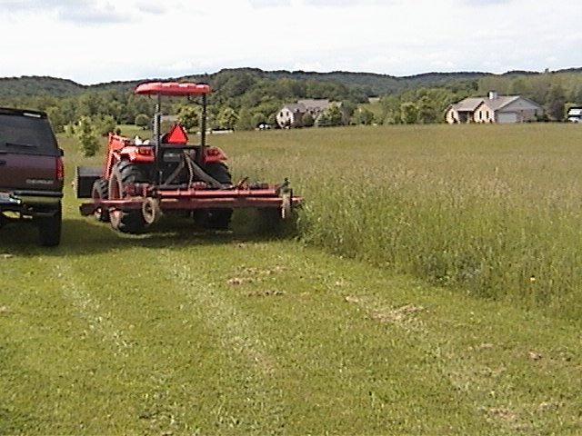

I've loaded round bales with pallet forks (don't have spear), and mowed with a 12' bushhog.
Good luck,
