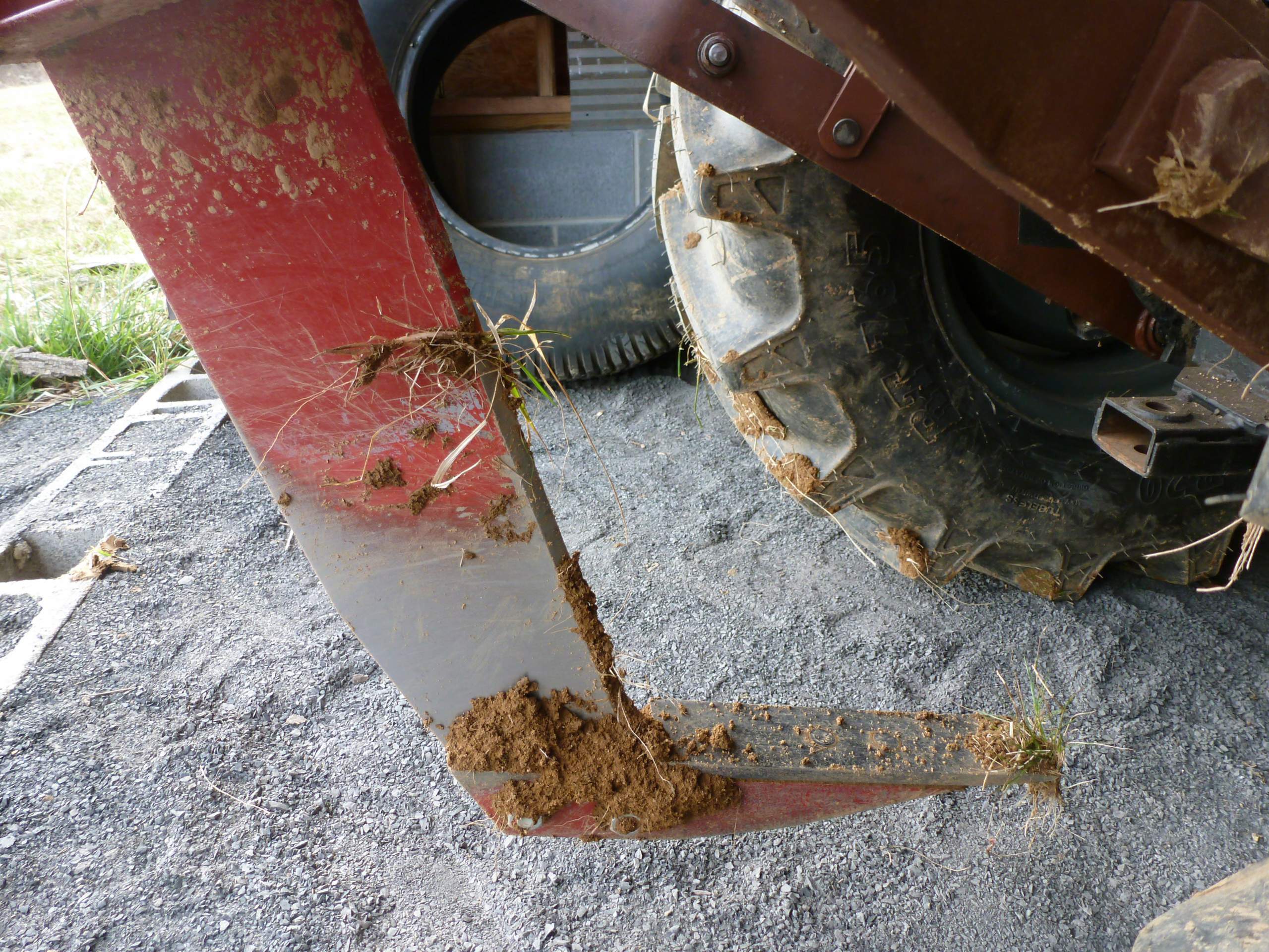

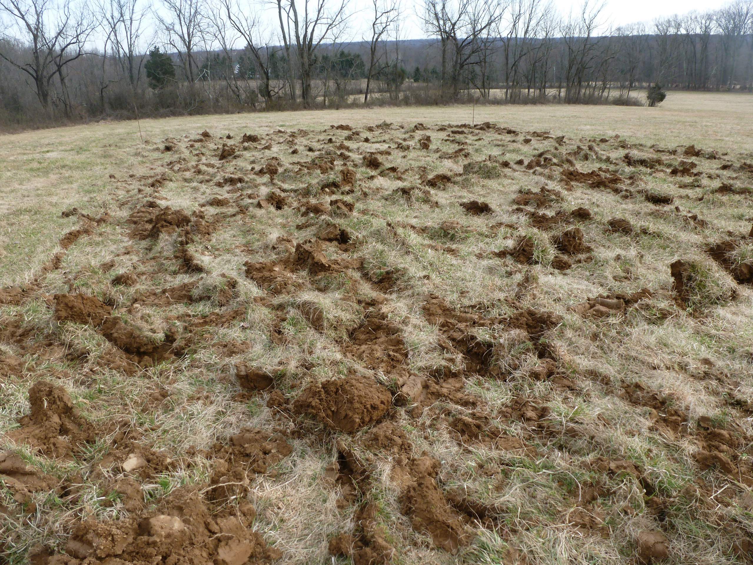

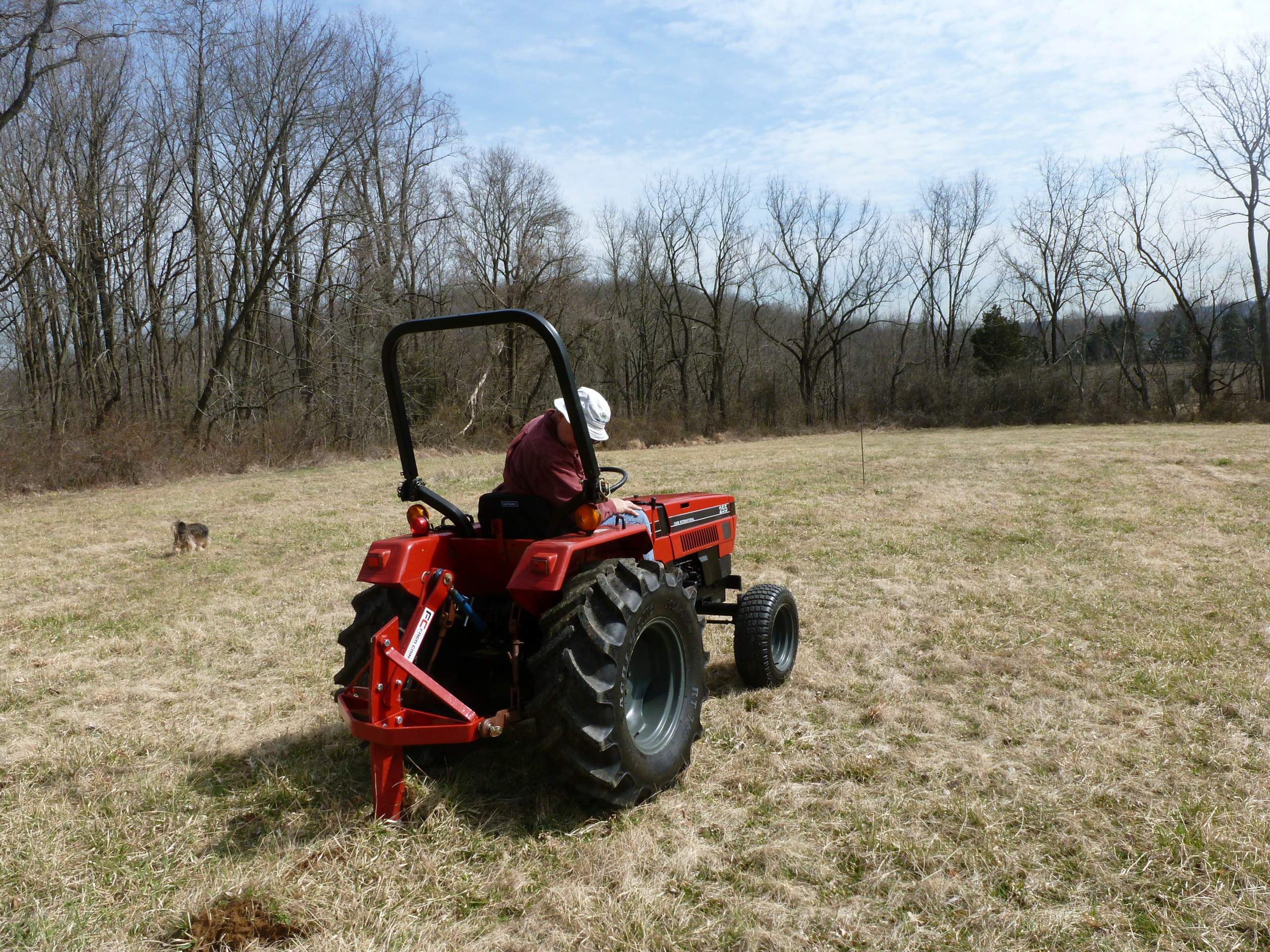

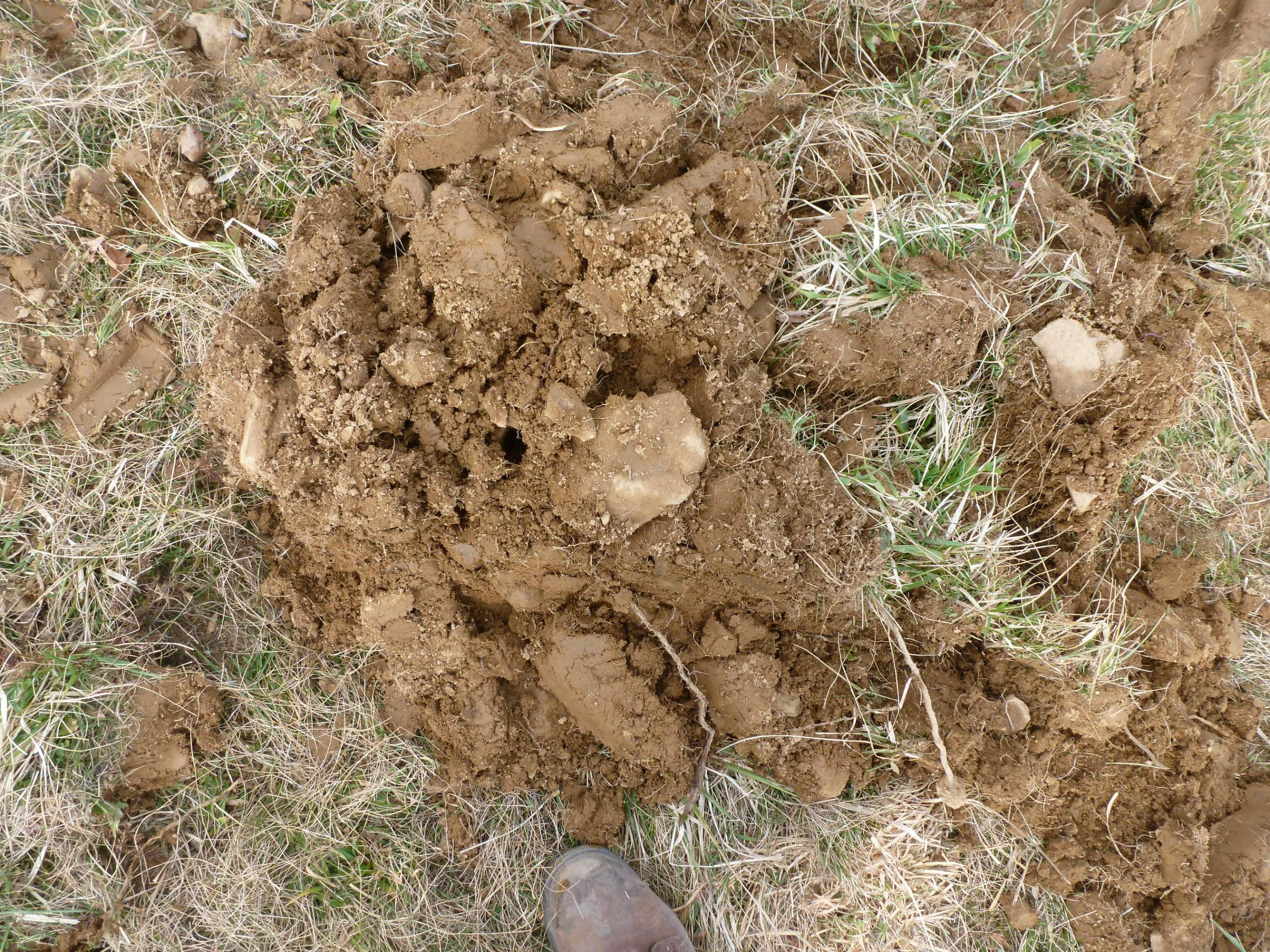

Had a great deal of fun ripping up a field in prep for a garden. The ETA/Fred Cain subsoiler is very heavy duty and worked fine. Likely I need some adjustments to the three point hitch to fine tune. Would like it to raise up higher but also go lower but I think I'm limited by the range of motion of the tractor hydraulics. This little 25 hp tractor pulled it fine, though it would have worked a lot better with 4wd. Had to step on the diff lock a few times to get myself unstuck, but I expected that. Rocky clay soil. Seemed to have patches of rocks, and other areas I just zipped through. The ETA video is right on, if you aren't hitting too many rocks, you hardly leave a trail if you run the tire over it on the next pass. Not sure I can figure out how to lay plastic pipe with it yet.
Now I plow this bumpity garden and rough it up even more with a middle buster-potato plow, and then I rototill with my pull behind DR Rototiller behind my Gravely. The Gravely weighs half the weight of the tractor, so my thought is tread lightly on the final pass.
I'm thinking I'll use the little potato plow to make furrows for corn, but on a garden this small, probably just as easy to do it by hand. If all grows well, the garden will probably double in size next year.
The subsoiler did its job beautifully, and I'm glad I bought the heavier duty one, because it became quickly clear that nothing I hit in this field was going to faze this subsoiler one bit. Stop the tractor yes, bother the plow, no.

looking at the worn off paint, I'd say I was 12-14 inches down, not the max 18.
I'm going to fiddle with the links and try to get it lower. Sometimes it would sort of suck itself down lower and other times it would ride higher. Sometimes it skidded on the surface of the field grass before biting in too. Again, not sure of my adjustments, but once it started to dig in, it usually stayed in.
I'll probably have another go at it though I've really accomplished what I wanted which is to get down a little deeper than I have any chance at plowing.
The land slopes off in two directions, so first I went one way, then I went at an angle down the other slope. Probably drains fine anyway, but I thought a little aeration and decompaction would do a lot of good.

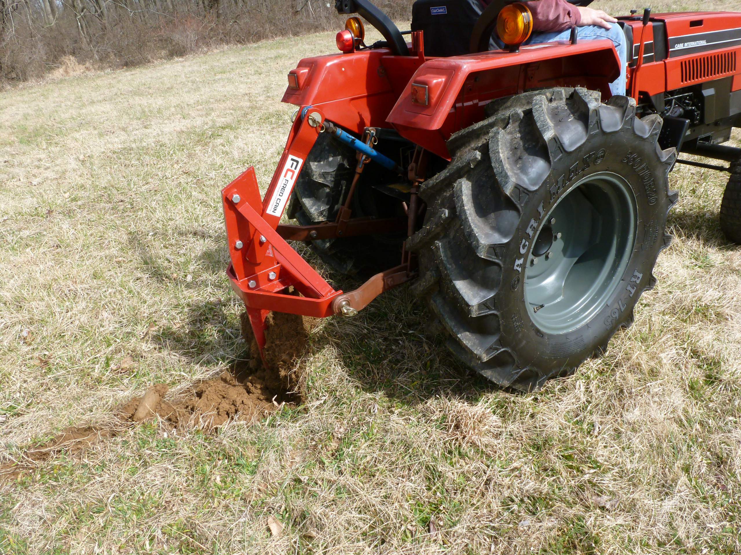

I think I may have the piece with the mfg name on it upside down, now that I look at the pics. Not sure it makes a difference though. If it does, I hope someone chimes in.
/ Subsoiler adventure #4
... I think I may have the piece with the mfg name on it upside down, now that I look at the pics. Not sure it makes a difference though. If it does, I hope someone chimes in.
You have the working ends right. Just rotate it 180 degrees so the name in the photo is on the left side and Fred Cain will be happy:thumbsup:

This just a guess, but it seems to me, that if you shorten your top link, the angle will change to be more upright than as you have it, and it might pull itself deeper.

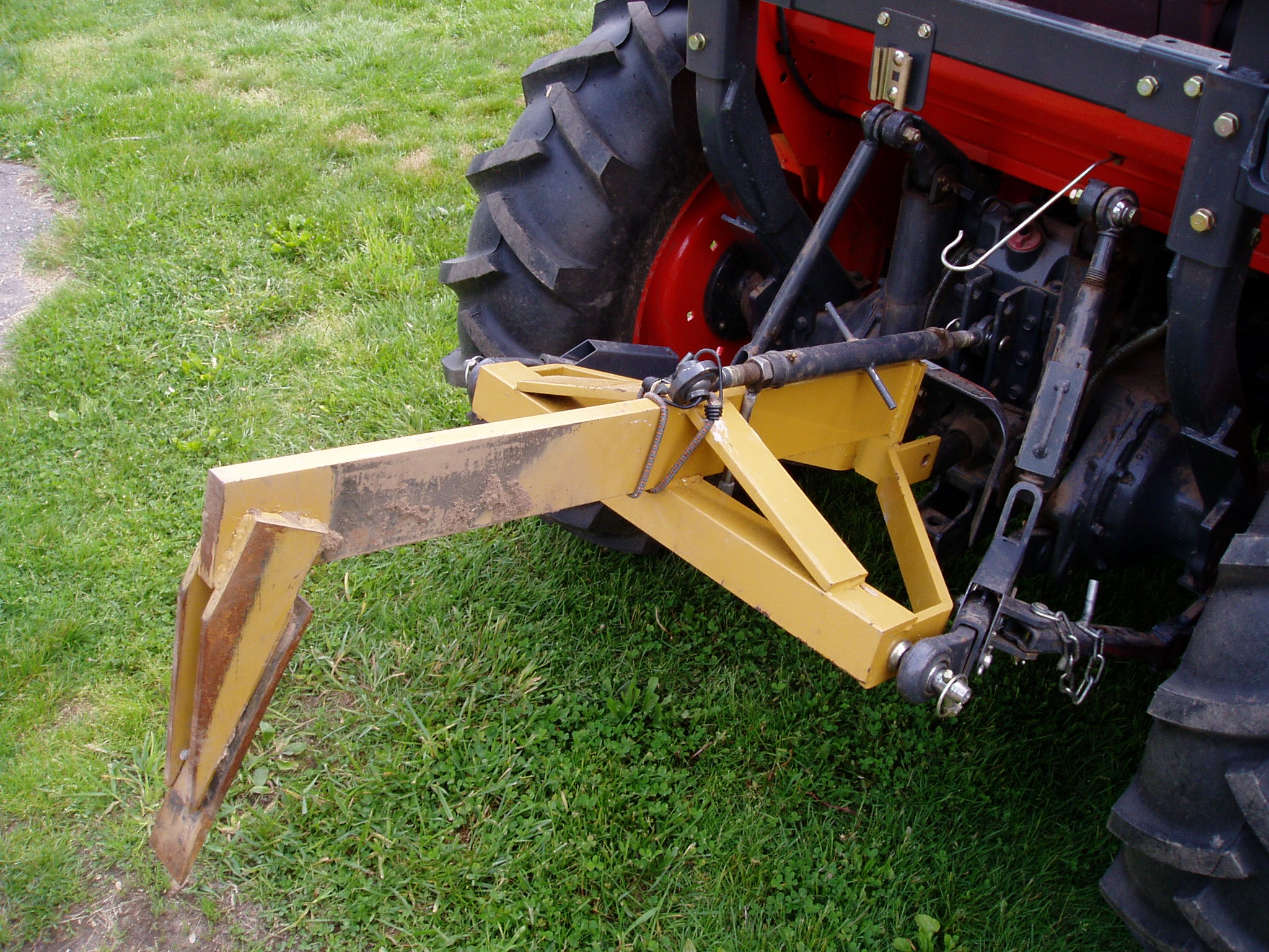

My transport solution - allows you to adjust hitch for full depth subsoiling in the field and then drive back to the shed without ripping up a gouge in the lawn, driveway, and everything else in between:

Typically a 3pt has the top link vertically straight up from the bottom links. For some reason Fred tipped the top link connector out forward a lot.
That will do some interesting things on rotating the point as you raise & lower the thing.
I'm working it out in my head as to what.... But the point at the bottom will follow an arc, with that configuration, as you raise & lower it.
That angled flat point at the bottom will help suck the chisel down into the ground, keep it down. Changing the angle of it (by moving the top link) will change how much it wants to pull down, or rise back up.
Interesting solution! I'll have to try it to see if it can work on my tractor. I don't know whether or not it will rotate forward and clear everything or if there will be an obstruction.
