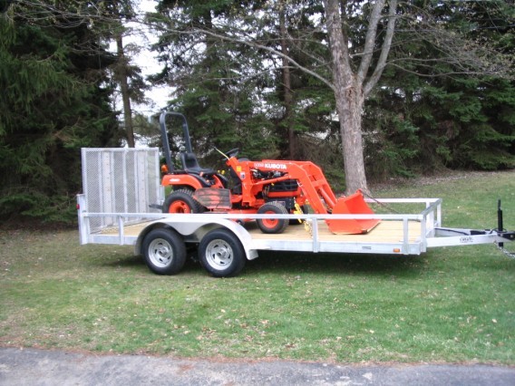

Danny,
Here is an easy trick I use. The BX weighs a couple thousand pounds or more with a backhoe. Rule of thumb is 10% tongue weight so 200-250 is pretty good with a BX.
I weigh about 210-220 (depending on time of year). What I have done to set my trailer and BX up is to hook up trailer empty. Next measure the height of the bumper from the ground. Next step on the hitch and measure how far the bumper goes down. That movement equals ~220 lbs. Now you have a reference point for loading the BX.
My next trick is to use one of my roller stands that I use with my miter saw, table saw etc. It is height adjustable so it works great. I set it behind the bumper and level it with the bumper (taking care that it will not interfere with the bumper moving when I load the tractor). Drive the BX on the trailer and watch for the bumper to move down the distance you already tested and your done.
You can also use tape measure and two people if handy, just seems that whenever I'm loading the tractor eveyone else is doing something different.
Here's also a picture of my BX on the trailer I bought this Spring. I am trailering about 200 miles each week now for mowing at my Lake property and this trailer set up is awesome.
The 16' handles so much nicer than the 10' that I was using not to mention having the brakes is a world of difference when stopping.
