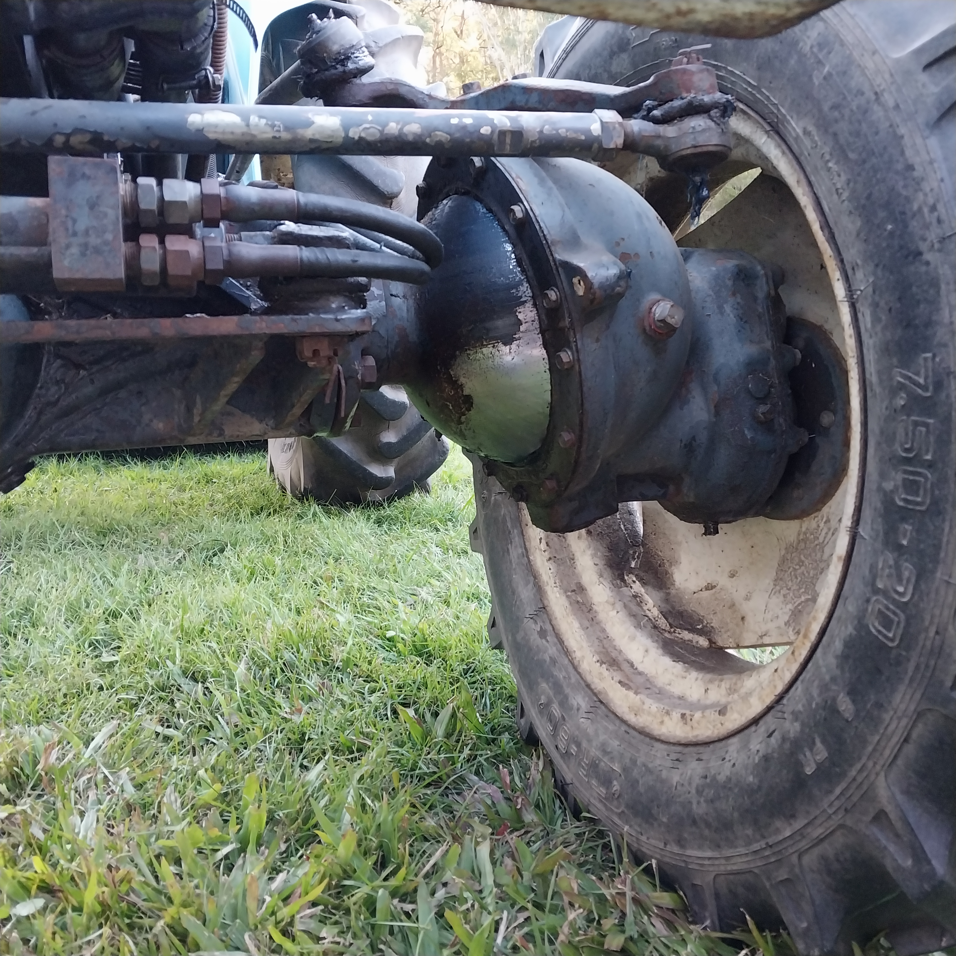

Jul 11, 2025 / mITSUBISHI d4050fd #1 O ozziemick New member Joined Jan 10, 2020 Messages 6 Tractor mitsubishi D4050 hI there,Anybody got any idea what the large ball joint is actually called in this photo.Ihave googled all the usual suspects but to no joy.Thanks.
Jul 16, 2025 / mITSUBISHI d4050fd #2 bmaverick Super Member Joined Sep 17, 2013 Messages 7,439 Location Beloit-WI Tractor Yanmar YM2610 ■YANMAR GURU■ EXTRAORDINAIRE Mitsubishi makes heavy duty trucks and vehicles too. On the tractor, this is a spherical CV joint with no boots, yet for 4WD.
Jul 16, 2025 / mITSUBISHI d4050fd #3 bmaverick Super Member Joined Sep 17, 2013 Messages 7,439 Location Beloit-WI Tractor Yanmar YM2610 ■YANMAR GURU■ EXTRAORDINAIRE ozziemick said: hI there,Anybody got any idea what the large ball joint is actually called in this photo.Ihave googled all the usual suspects but to no joy.Thanks.View attachment 3760498 Click to expand... You would have better answers in the Mitsubishi-Satoh section. Mitsubishi/Satoh A new forum for the Mitsubishi Owner's Group! For the discussion of Mitsubishi & Satoh tractors and equipment! www.tractorbynet.com
Oct 7, 2025 / mITSUBISHI d4050fd #4 L lens12 Veteran Member Joined Apr 7, 2000 Messages 2,127 Location Dixon, Il Tractor ford 9700, tw30, massey, jd2030 jd4010, yanmar F60d, ym330d, ym276d,ym226d,ym186d, ym2000, ym155 Mitsubishi calls it the kingpin case
